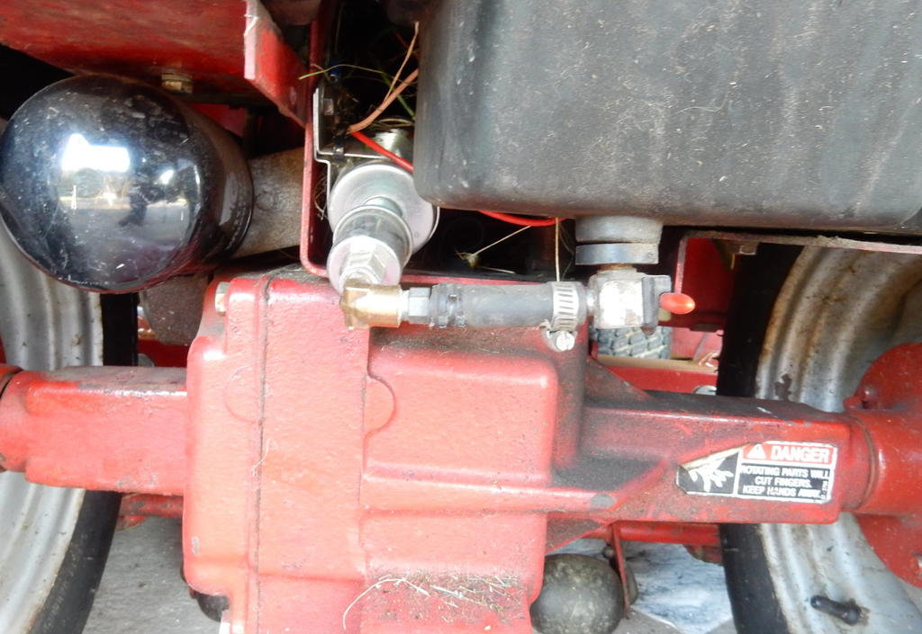

Kurt-NEPA 756 #4 Posted September 8, 2018 I'm a big fan of electric fuel pumps. I have one on each of my 4 horses. Here is where I put one on my 1995 520H. I used this pump from Amazon https://www.amazon.com/gp/product/B000C1LW0E/ref=oh_aui_detailpage_o07_s00?ie=UTF8&psc=1 Works great, I hooked it up with a relay on 10 amp fuse. No regulator required. 3 1 Share this post Link to post Share on other sites

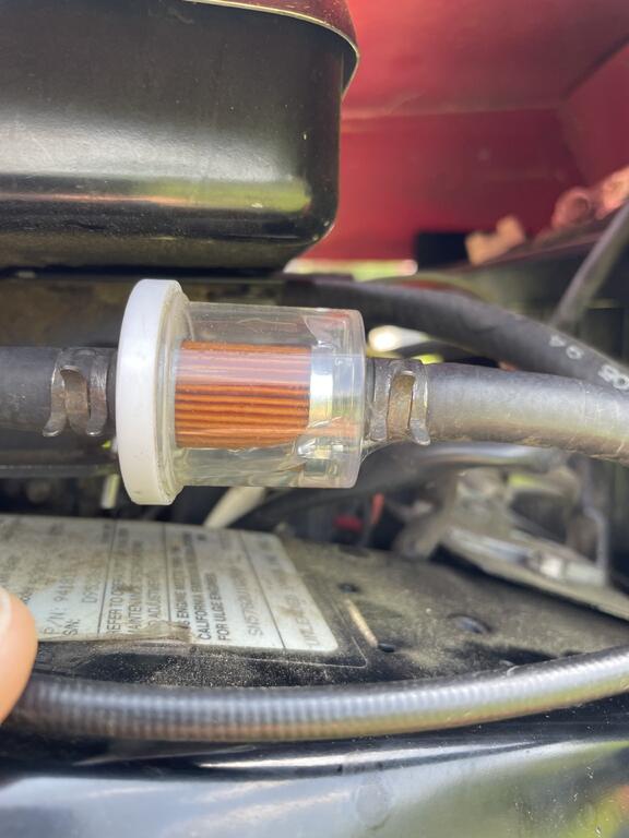

Sam D 0 #9 Posted May 20, 2023 having a problem with stalling. noticed clear fuel filter has low fuel level. replaced pulse pump still having low fuel issue. considering going electric.any advice? 520-H onan Share this post Link to post Share on other sites
lynnmor 8,568 #10 Posted May 20, 2023 If you are seeing air in a clear fuel filter, that is perfectly normal. Did you remove and clean the petcock screen in the tank? Share this post Link to post Share on other sites
Sam D 0 #11 Posted May 20, 2023 very low fuel in filter barely wets the paper element. did not remove and clean screen. removed hose and got full flow out of petcock. blew through lines, appeared to be clear. how do I remove petcock? Share this post Link to post Share on other sites
lynnmor 8,568 #12 Posted May 20, 2023 45 minutes ago, Sam D said: very low fuel in filter barely wets the paper element. did not remove and clean screen. removed hose and got full flow out of petcock. blew through lines, appeared to be clear. how do I remove petcock? The petcock is just pressed into the rubber bushing. It would be a good time to flush the tank and replace the old bushing. The bushings can be found at numerous places including your local lawnmower shop. It sounds like your problem may be elsewhere, try removing the line from the carburetor and direct it into a container, then crank the engine to see if fuel is being pumped, of course take all precautions when doing this. Do you know if the pulse hose behind the fuel pump is connected at each end and in good condition? Share this post Link to post Share on other sites

Sam D 0 #17 Posted May 21, 2023 (edited) Removed fuel line at carb got strong stream, all lines clear so apparently no issue with petcock screen. Mowed about an acre, mower shut off two or three times, fuel filter was almost dry each time. Slight choke, pumped gas a few times started right up. sat at idle cut out again. can't seem to replicate conditions that make it stall. If I shake the fuel filter it will sometime stall. Any thoughts? Edited May 21, 2023 by Sam D omission of word Share this post Link to post Share on other sites
lynnmor 8,568 #18 Posted May 22, 2023 Engine failing at higher temperatures is often the ignition module breaking down from heat. If letting it sit for an hour and then starting and running normal for awhile is a clue. Try pulling a spark plug wire immediately and attaching it to a spare plug to check for spark. And quit being obsessed with that air in the fuel filter, duct tape over it will keep it out of sight and mind. Share this post Link to post Share on other sites
Sam D 0 #19 Posted May 22, 2023 Keep a 5/16 bolt wired to my steering wheel, when mower would quit ,pull wire and check spark, has spark. Kept a quart bottle of gas with me, mower would quit, remove air filter ,squirt of gas, starts right up. seems to be a fuel issue. maybe I will take off the pump and check the vac.hose. Could be an intermittent vacuum problem causing the pump malfunction. seems like the carb is running out of gas Thanks again for your ideas, duct tape solves many of man's problems... Share this post Link to post Share on other sites
