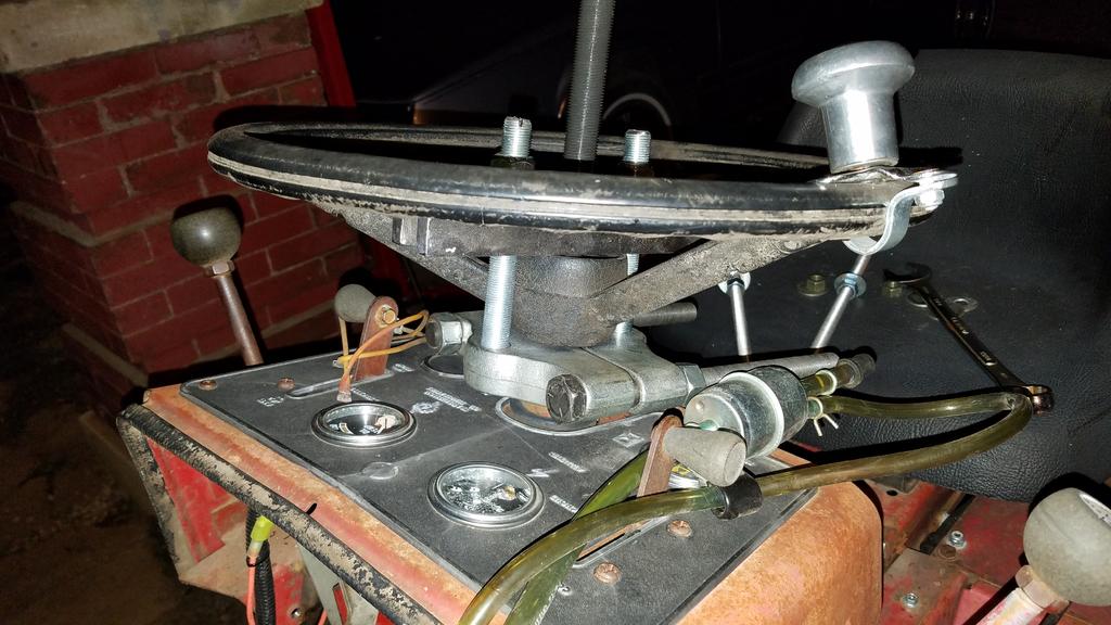

bo dawg 518 #1 Posted September 6, 2018 Ok 2 questions. I want to pull the steering wheel off of the D-160, so I removed the nut and don’t see where there is a pin to knock out. Looks like it just pulls right off. By the looks of the neversiege on it it’s been off recently. Also what originally is the color of the horse head and wheel on the button? Red right? Share this post Link to post Share on other sites
Marv 984 #2 Posted September 6, 2018 The shaft is splined so there is no pin. If you are lucky it should pull straight up and off. You may have to lift on the wheel and tap the shaft a little. If you do be sure to put the nut back on first. If you have to rap hard use brass hammer. If the never seize is on the splines it should co,e off easily. Marv 2 Share this post Link to post Share on other sites

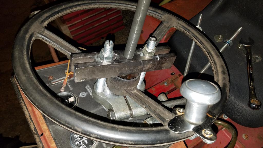

Sarge 3,465 #3 Posted September 7, 2018 That model uses a Ross steering box - unless you want to break it, do not use a hammer on the shaft - it can shatter either the worm gear or the housing. You'll need to use a bearing splitter and beam puller, if you don't have one most auto parts stores will loan them for free as long as it's returned in one piece. If you work on things like this, or gears, transmissions and the like - a bearing splitter kit is a great investment. I use the OTC kit like this and it works on nearly anything - including those pesky rear hubs. https://www.otctools.com/products/7-ton-bar-type-pullerbearing-separator-puller-set Sarge 1 2 1 Share this post Link to post Share on other sites
pacer 3,177 #4 Posted September 7, 2018 Sarge is so very right!! Do not hit the shaft, blowing the end out of the Ross box is NOT good - it is aluminum and couldnt stand a blow. Besides that puller he shows is a quick and easy way to get it off, they CAN be stubborn. 1 Share this post Link to post Share on other sites

bo dawg 518 #8 Posted September 7, 2018 I tried a few times to smack up on the wheel and all that happens is hurting my hands. Lol! i sprayed some blaster on it several times. Let her sit while I look at a puller. Or maybe just leave on and paint around it. Share this post Link to post Share on other sites

Sarge 3,465 #12 Posted September 8, 2018 Don't be afraid to clean those splines on that shaft, either - I use a hardened steel pick and an aggressive Pipeliner style wire wheel to clean parts like that before re-assembly. Permatex anti-seize is a must as well. Hitting that wheel, either upward or downward will drive the bearing races hard enough into the Ross housing to crack/shatter it - don't ever hit one. If you did hit it - I'd highly recommend removing the box from the tractor and spend the time to clean it up - that thread I wrote details the parts available from JD to rebuild that box, along with the correct thrust bearing to help it steer much easier and live longer. There is also a gentleman on eBay that is machining custom replacement studs for the gear drive out of correctly hardened steel - for a few bucks the effort is definitely worth the reward here. After fixing up the steering box and new bearings, etc in the front axle - mine steers with one finger regardless of the ridiculously heavy front blade, or anything else. Even with those wide ag tires up front, it steers easily on hard pavement. The race bearings in those Ross boxes are nearly identical to old bicycle headstock bearings for the front forks - they are not very heavy, either - so a rebuild is a good idea. It's only a few bolts, one is a bit tough to get to but worth the effort. The box will drop right out the bottom and it helps to have another pair of hands to guide it into place during reassembly. I think the total cost of the bearings and good Mobil grease was less than $30 total unless you need to replace that center pin. For some reason, I can't find that thread on rebuilding the Ross box - it's around here somewhere... Sarge 1 Share this post Link to post Share on other sites
