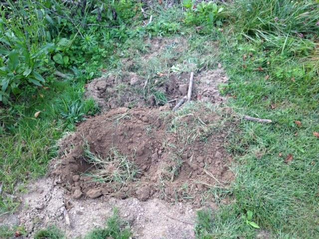

DET 113 #16 Posted September 16, 2019 Finally got around to doing this. Here are pics of what the almost final project will look like and a small area I tried it out on. I ended up with a 9" pulley on the motor. The tines aren't moving real fast but they do sure turn up the dirt. If I don't hold down the brakes the tiller will move the tractor. I do have a video of the unit running just can't figure out how to up load. 3 3 Share this post Link to post Share on other sites
