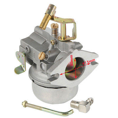

Cetan08 311 #1 Posted September 2, 2018 Saw these on eBay the other day and ordered a couple just to see how they work. At the price I figured not much to lose. Be a week until I get them and will let you know how they do. Anyone else have any experience with theses. Thanks https://m.ebay.com/itm/Carburetor-For-Kohler-K321-K341-for-14hp-16hp-Engine-Carb-Cast-Iron-Replace-30-/263454729249 Share this post Link to post Share on other sites
pfrederi 19,785 #2 Posted September 2, 2018 (edited) I have used a couple. Seem to work OK, probably won't last 40 years but at the price i do not care. I like them better than the Walbro Fixed main jet variety. Some you will find the choke works backwards. Some take them apart and turn things around...I just put a label on the instrument panel. One thing for sure open teem up and check the float setting they can be hugely wrong.... Edited September 2, 2018 by pfrederi 1 Share this post Link to post Share on other sites
pacer 3,179 #3 Posted September 2, 2018 Yep, just what Fred sez. I have bought some 6-8 of them with overall good results (last one was for a K301 and all of $14/free ship!!) I choose to swap out the butterfly/shaft from my old carb and yes I have noticed float level is way off. Also you may find your fuel inlet wont go in very far (metric threads?) I use my 1/8" pipe tap and run it in til I can get a good seat. Share this post Link to post Share on other sites
953 nut 63,920 #4 Posted September 2, 2018 The one I bought came with both choke arms, works great. Share this post Link to post Share on other sites
The Tuul Crib 7,340 #5 Posted September 2, 2018 1 hour ago, pacer said: Yep, just what Fred sez. I have bought some 6-8 of them with overall good results (last one was for a K301 and all of $14/free ship!!) I choose to swap out the butterfly/shaft from my old carb and yes I have noticed float level is way off. Also you may find your fuel inlet wont go in very far (metric threads?) I use my 1/8" pipe tap and run it in til I can get a good seat. I had the same problem with one I bought for my K1 81. The threads on the new carb where different from the old from the pump to the carb. They are definitely a metric size . Share this post Link to post Share on other sites
