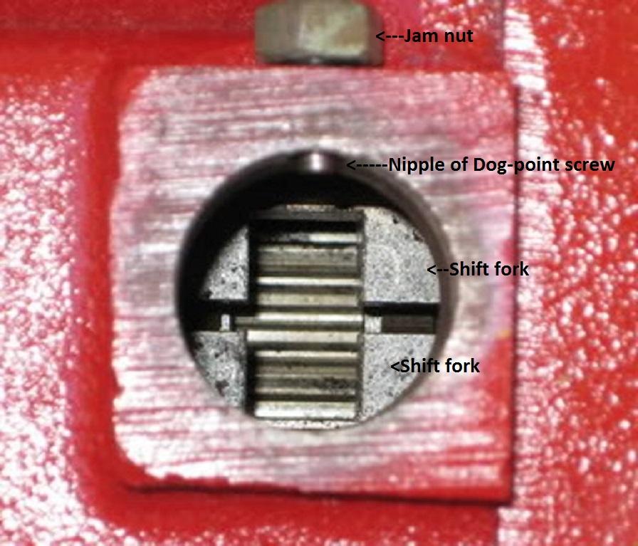

daveoman1966 3,882 #3 Posted September 1, 2018 Seems to me the BALL at the end of your gear-shift lever has come loose on the DOG POINT SCREW and is just flopping around. Pull the shift boot up and you'll see this image. This is the NEUTRAL position. To adjust the dog-point screw, first release the JAM NUT that holds it in place. There is a small hole in the ball of the shift lever....the dog-point screw fits in that hole. Wiggle the BALL of the shift lever to where you can FEEL it and tighten the SET SCREW to where the ball is rather stiff to move around. Then, back off the set screw 1/4 turn and tighten the JAM NUT to hold it. 2 1 Share this post Link to post Share on other sites
FatJackDurham 318 #4 Posted September 3, 2018 Well done, Dave! I got that tip from gwest_CA in another post, but your picture made the difference! She drives! 1 Share this post Link to post Share on other sites
daveoman1966 3,882 #5 Posted September 4, 2018 I'm an admitted thief. I stole that pic a while back from someone....lol. As long as it helps...all is well. 1 Share this post Link to post Share on other sites
