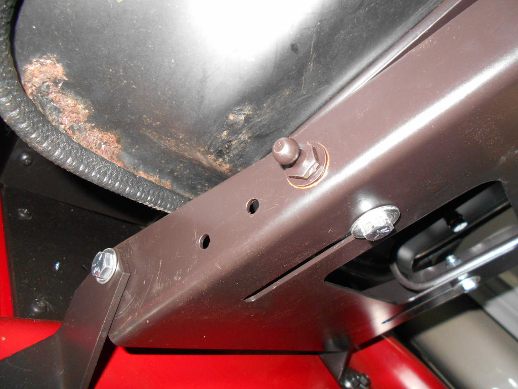

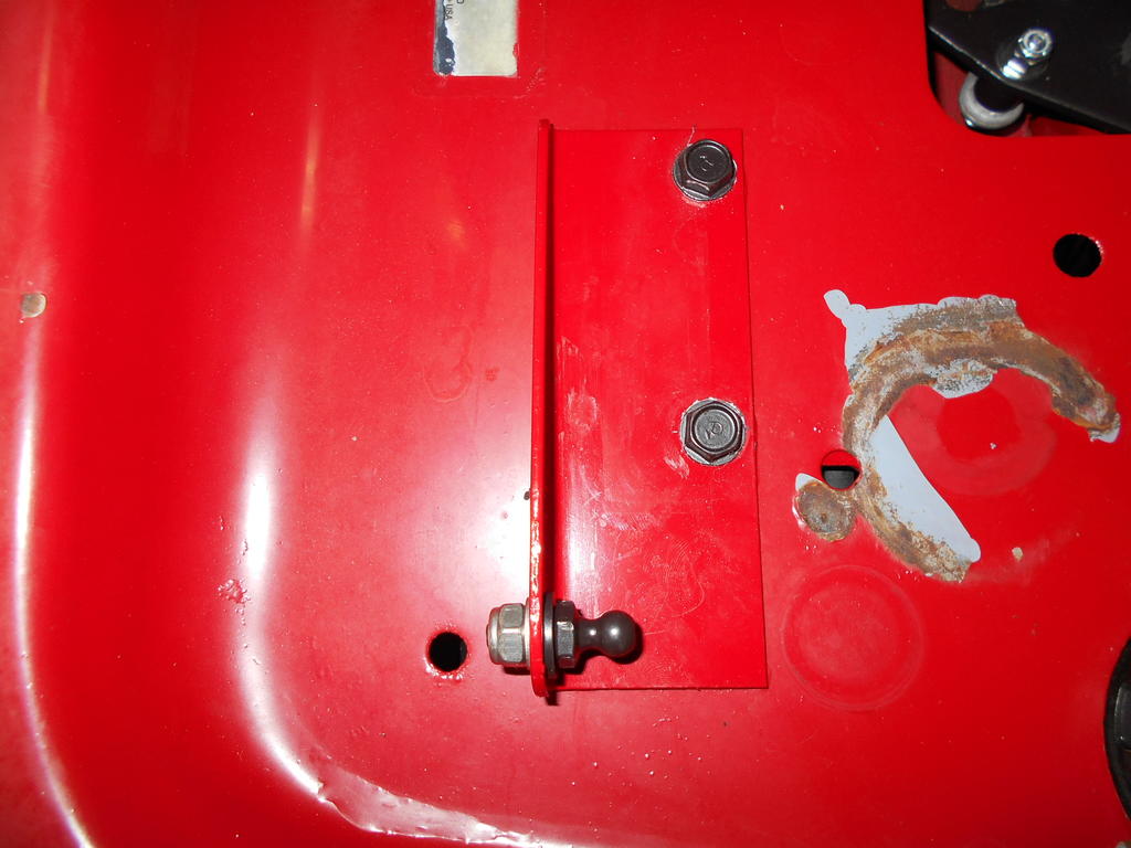

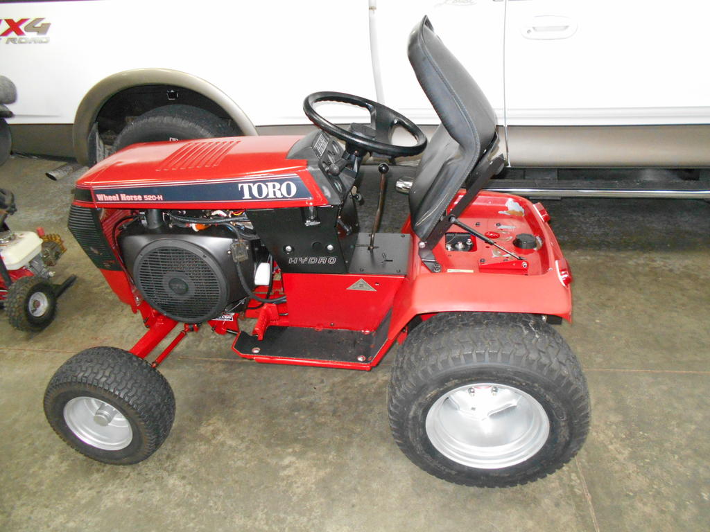

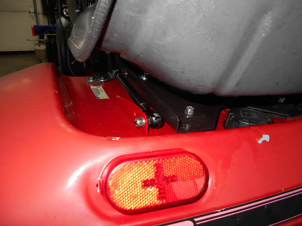

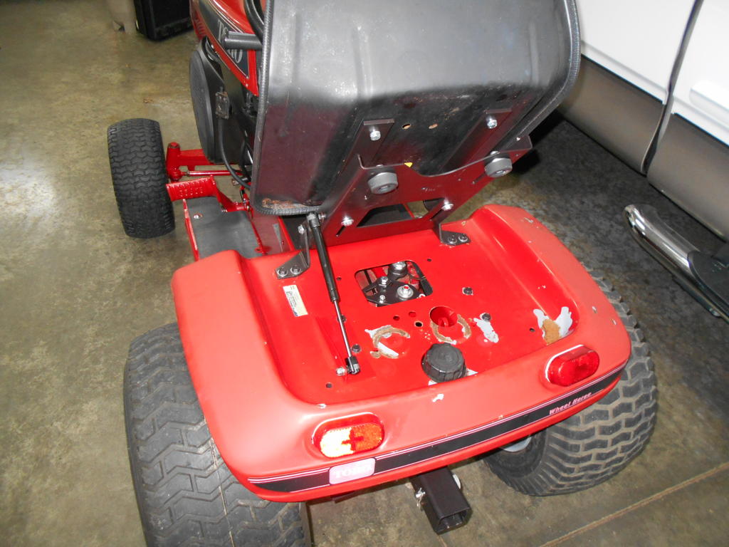

cleat 7,747 #1 Posted August 31, 2018 The proper seat lift support seems to be getting hard to find and expensive so I found this to work quite well. I use a Strongarm 6915 that uses ball mounts on both ends. The ball mounts can be bought new or do as I did and visit your local scrap yard and pilfer some from old cars. Cleat 7 Share this post Link to post Share on other sites
dclarke 4,110 #2 Posted August 31, 2018 That's good to know, Cleat.... Thanks. Share this post Link to post Share on other sites
Tankman 3,523 #3 Posted August 31, 2018 Did the same on my '90 520-8. Share this post Link to post Share on other sites
