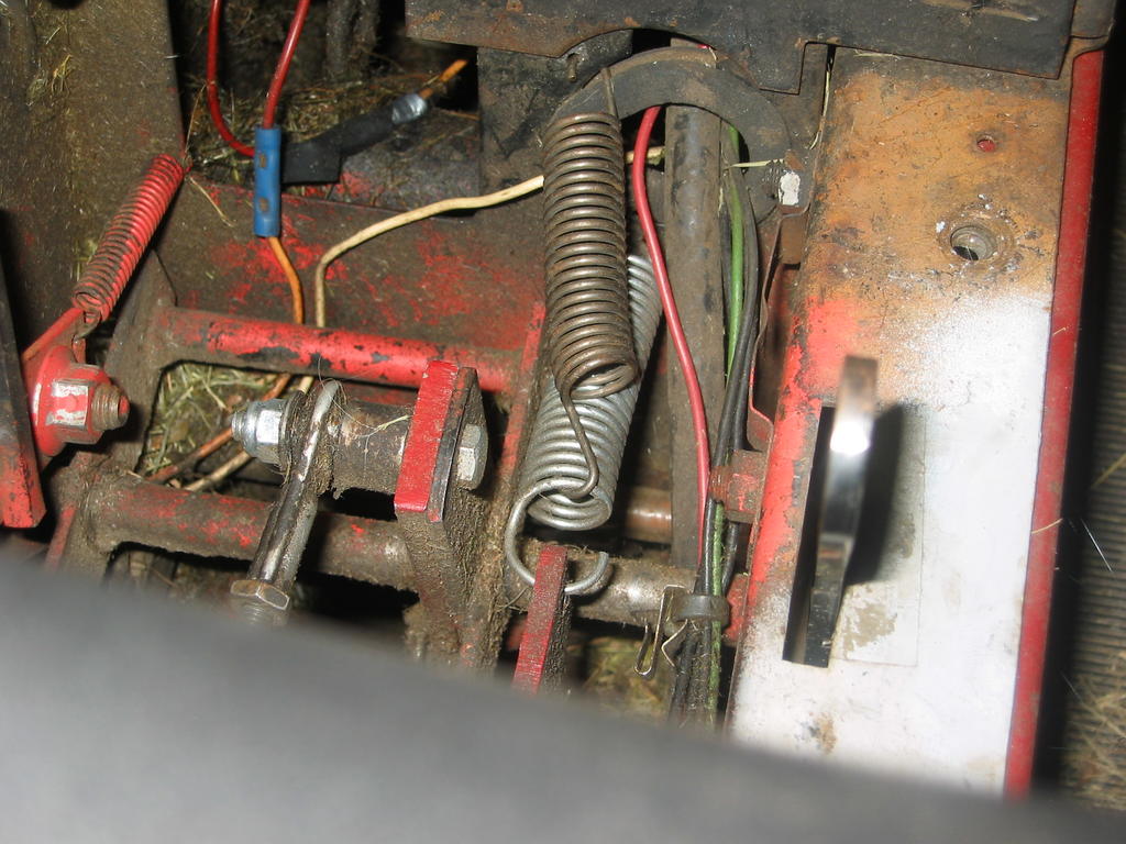

rmaynard 16,887 #6 Posted August 31, 2018 9 hours ago, cschannuth said: I guess I need to add the additional spring because I have everything loosened on the cam already. It’s a little bit tight in there. Did you put a smaller spring inside the large one that came with the kit or just another spring next to the original spring? Thanks Added a second spring next to the original one. I'd send you a picture but I'm sitting in Disney's Animal Kingdom with the grandkids watching the Nemo show. 😀😧 Can shoot you a picture next week when I get home 1 1 Share this post Link to post Share on other sites
pfrederi 19,941 #7 Posted September 1, 2018 Not pretty but i had the spring on hand and it works Share this post Link to post Share on other sites
cschannuth 3,819 #8 Posted September 2, 2018 7 hours ago, pfrederi said: Not pretty but i had the spring on hand and it works Thanks! Share this post Link to post Share on other sites
