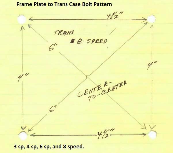

daveoman1966 3,880 #2 Posted August 30, 2018 Yes... but you MAY have to change around some of the brake linkage...not sure on that. The bolt pattern at the FRAME PLATE is the same as in this pic.... 1 Share this post Link to post Share on other sites

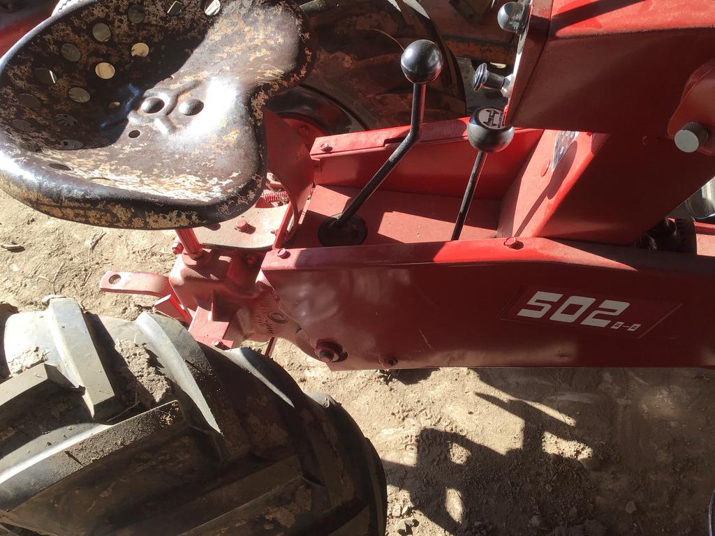

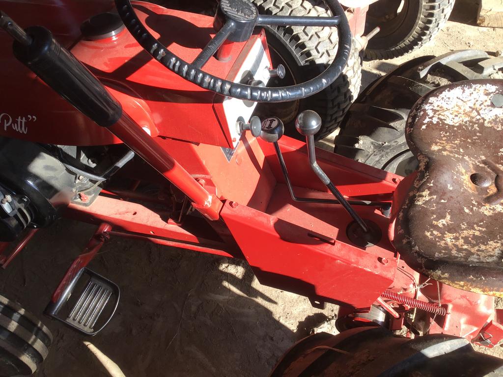

Pullstart 68,407 #5 Posted August 30, 2018 Hi @Johnboy609, to ! I put a 6/8 speed (if you count reverse) in my 502, the only thing I haven’t tackled yet is a parking brake. The donor tractor being available is a huge help, and with some fittin’ and trimmin’ the hi/low lever will look right at home on your Commando. 1 Share this post Link to post Share on other sites
