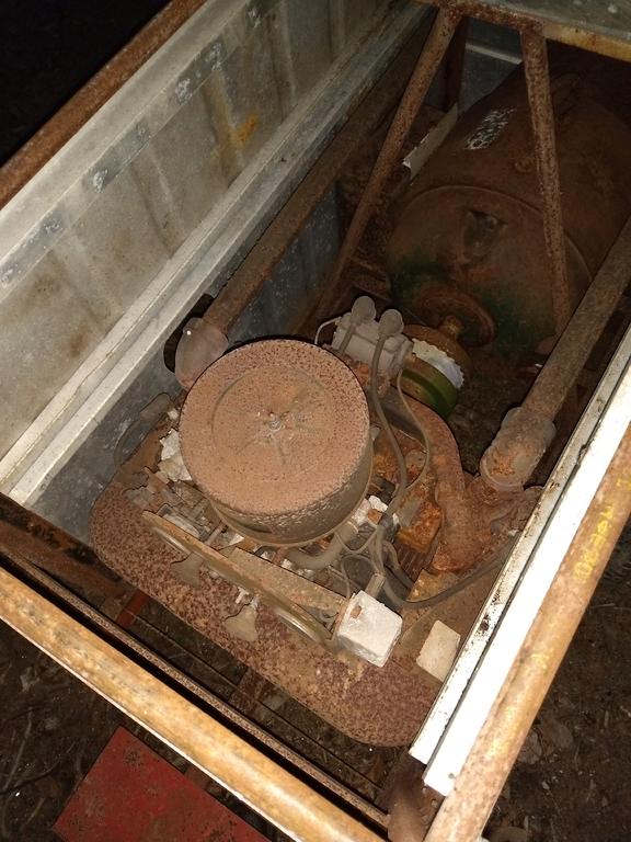

JAinVA 4,638 #2 Posted August 28, 2018 My guess would be an early Onan.Probably not but boy is it rusty. Share this post Link to post Share on other sites

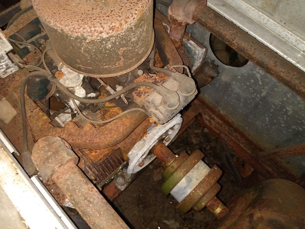

diesel cowboy 263 #3 Posted August 28, 2018 I'd say a K series Kohler twin. Either 482, 532, 582, or 662. Dipstick, exhaust manifold, ignition coil, governor, air cleaner, and points cover all look like Kohler to me 3 Share this post Link to post Share on other sites
953 nut 63,922 #4 Posted August 28, 2018 8 hours ago, diesel cowboy said: I'd say a K series Kohler twin. Either 482, 532, 582, or 662. Dipstick, exhaust manifold, ignition coil, governor, air cleaner, and points cover all look like Kohler to me I vote Kohler Twin also, spark plug location is correct for a KT. 1 Share this post Link to post Share on other sites
pfrederi 19,785 #5 Posted August 28, 2018 2 hours ago, 953 nut said: I vote Kohler Twin also, spark plug location is correct for a KT. 1 Share this post Link to post Share on other sites
boomers_influence 106 #6 Posted August 28, 2018 kohler, also. thank you. boomer Share this post Link to post Share on other sites
ebinmaine 77,069 #7 Posted September 1, 2018 Somebody just reminded me in another thread that I had forgotten all about this one. Thanks guys, for responding. If you look at the first picture you can see that this is basically in a big metal box and it is a generator that was home built by the fellow that owned all the material at the auction that we went to last week. The main frame rails are some kind of 2 inch I beam and then everything else is all welded together from there. The Main box part not counting the tongue is right around 4 ft long. The thing is Monsterously heavy. We are judging that it weighs more than a c series tractor having had experience moving those around several times. I bought it just because I was hoping that maybe that engine might run but even if it never does the trailer itself is worth the few dollars I paid for the whole assembly. 2 Share this post Link to post Share on other sites
wallfish 19,068 #8 Posted December 18, 2018 Connect a pulley on that generator shaft and spin it with a belt connected to one of your tractor's PTO to test it out and see if it produces power. If it does it's worth more than just the scrap price. or use it. It may or may not be designed for side load but you can test it. If using it, just make up a shaft with pillow block bearings to hold the side load. Share this post Link to post Share on other sites
ebinmaine 77,069 #9 Posted December 18, 2018 7 hours ago, wallfish said: Connect a pulley on that generator shaft and spin it with a belt connected to one of your tractor's PTO to test it out and see if it produces power. If it does it's worth more than just the scrap price. or use it. It may or may not be designed for side load but you can test it. If using it, just make up a shaft with pillow block bearings to hold the side load. Oh yeah.... If it still works we'd keep it. I could use it to run a welder. 1 Share this post Link to post Share on other sites
Mows4three 833 #10 Posted December 18, 2018 Yeah.......welder. I like that idea. Dave 1 Share this post Link to post Share on other sites
