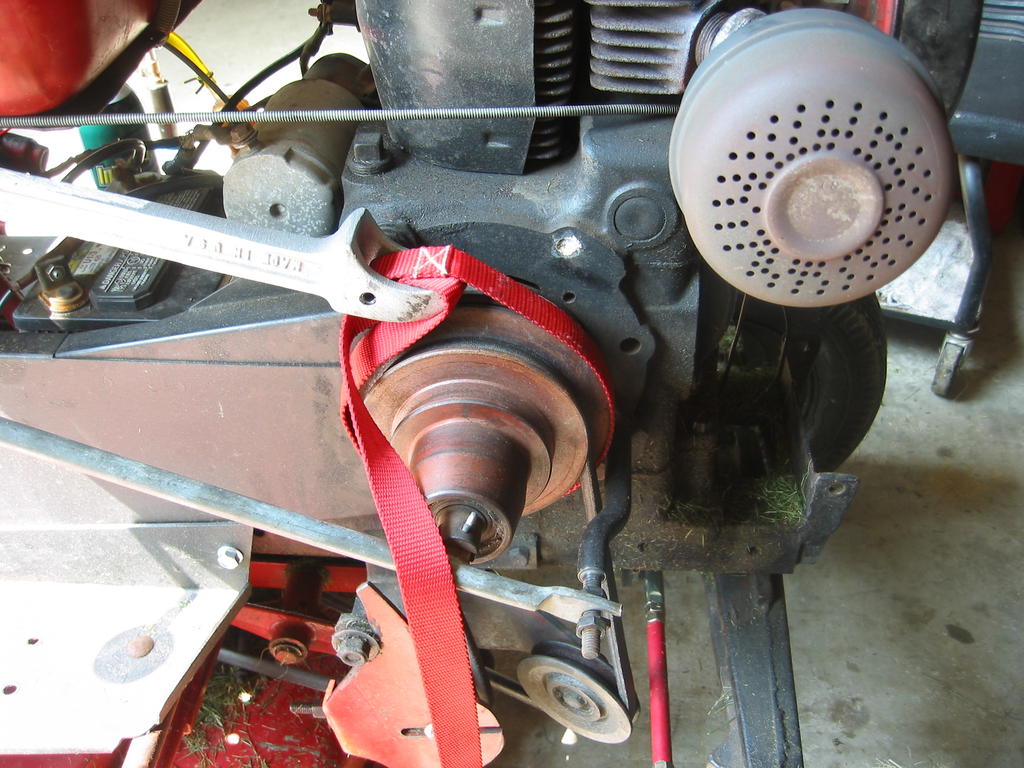

pfrederi 19,785 #1 Posted August 26, 2018 (edited) I am trying remove the flywheel screen on a Kohler 12 k301. Al 4 of the Philips head screws are frozen. I have soaked them with various witches brews heated one and wailed away with my impact driver and a BFH. All I have accomplished is to ruin the cross pattern. Heads are to small with slanted sides for vice grips so I filled opposing flat spots and got a good grip. Problem is when i try to turn it the engine turns over. It is a hydro so there is no way of putting it in gear and setting the brake. So obvious would be to wedge something in the flywheel fins or use a strap wrench to hold it....but you cannot remove the air shroud with out removing the screen first. I do not want to but I am thinking i may have to remove the belt guard and belt and see if i can get a strap wrench on the pulley. Any other ideas???? Edited August 26, 2018 by pfrederi 1 Share this post Link to post Share on other sites

pfrederi 19,785 #7 Posted August 26, 2018 Victory!! Tried the impact driver again no joy. I was able to get a strap wrench around the PTO friction disk. Filed flat spots on all of them and with vice grips and holding the strap wrench got them all out!!! Thank you all for the ideas... 2 2 Share this post Link to post Share on other sites
