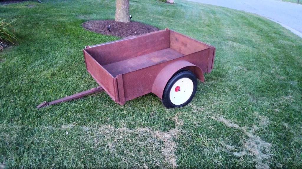

SylvanLakeWH 32,781 #26 Posted August 30, 2018 Look good to me and I bet the price was right... Cool funky little trailer... 1 1 Share this post Link to post Share on other sites
AlexR 3,136 #27 Posted August 30, 2018 39 minutes ago, SylvanLakeWH said: Look good to me and I bet the price was right... Cool funky little trailer... Yeah it looks good honestly once its painted up it will look good. The tires were about $20 each about as cheap as you can get for the rim size. So yeah paid the same for new tires as I did for the trailer 2 Share this post Link to post Share on other sites
Pullstart 71,482 #28 Posted August 30, 2018 (edited) 10 hours ago, AlexC120 said: Sorry guys, new tires. Couldn't justify the price of ag tires for just a trailer, the tri ribs probably wouldn't be too good on the ground with heavy weight. So I just got regular small trailer/boat trailer tires. Hey, you gotta be happy with your decisions, we just get to watch! Now you can use and enjoy the thing, that’s what really counts, right? Can’t beat that price, with wheels too? edit... I see the tires were bare, nice job repainting, looks new! Edited August 30, 2018 by pullstart 1 Share this post Link to post Share on other sites

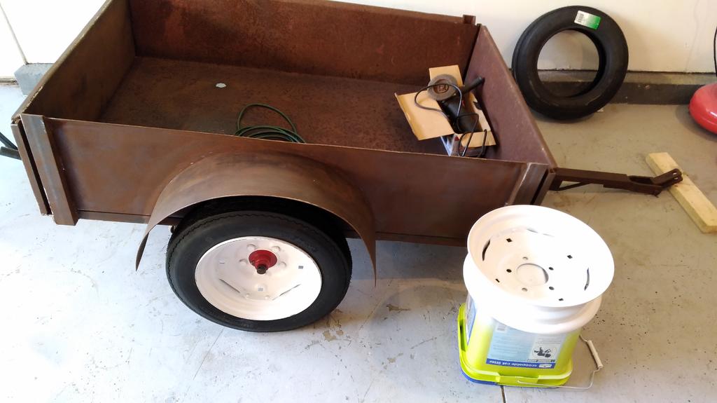

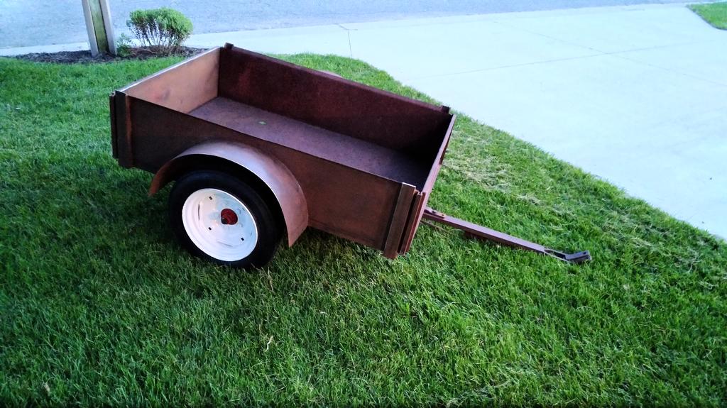

AlexR 3,136 #29 Posted August 30, 2018 Got a little more work done to it. And honestly I may just weld up the hole and just go with the bed it has, and just wait until I need to get a new floor, to replace it. Or if I find some metal that works. 3 Share this post Link to post Share on other sites
AlexR 3,136 #30 Posted September 2, 2018 Got the other tire mounted up. 2 Share this post Link to post Share on other sites

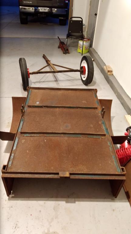

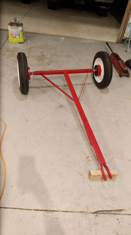

AlexR 3,136 #31 Posted September 2, 2018 And got the bed and frame apart so I can finish the frame and get the bed welded before painting. Also so you guys can see how it was built better. 5 Share this post Link to post Share on other sites

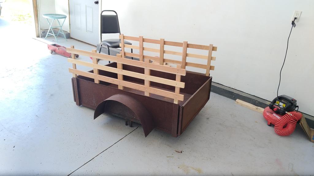

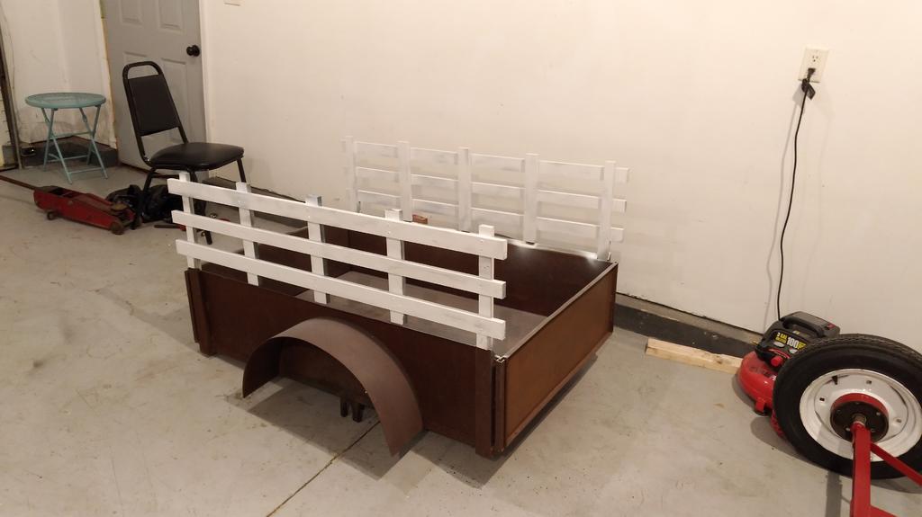

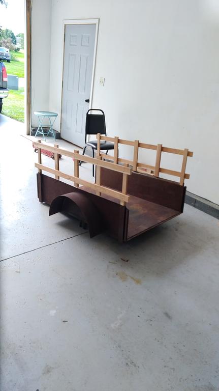

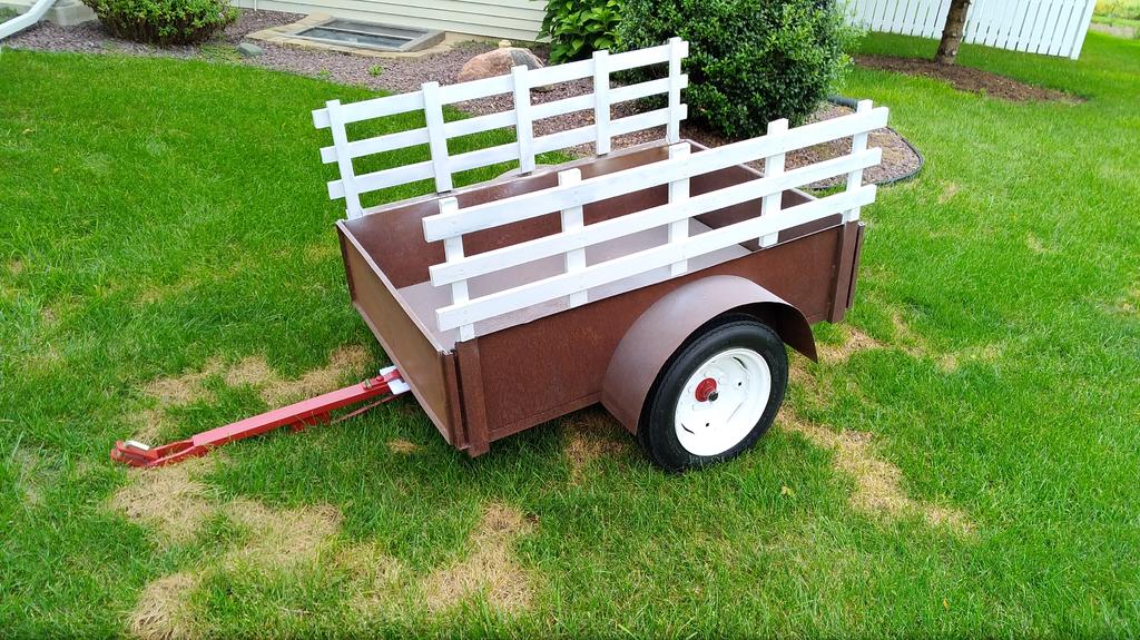

AlexR 3,136 #35 Posted September 3, 2018 (edited) Made sides for it that I will paint white. Edit: after I posted this I added another horizontal slat Edited September 3, 2018 by AlexC120 3 3 Share this post Link to post Share on other sites
cleat 9,403 #36 Posted September 3, 2018 I like the wood look. I would just varnish them. Cleat 2 Share this post Link to post Share on other sites
AlexR 3,136 #37 Posted September 3, 2018 3 minutes ago, cleat said: I like the wood look. I would just varnish them. Cleat I'm sorry too late lol but yeah that would have looked good too 2 Share this post Link to post Share on other sites

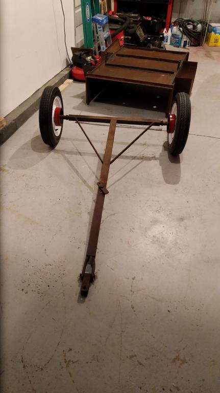

Pullstart 71,482 #38 Posted September 4, 2018 Does the trailer just sit on the axle with that U shaped pivot, or is there a method of attachment? Share this post Link to post Share on other sites
AlexR 3,136 #39 Posted September 4, 2018 1 hour ago, pullstart said: Does the trailer just sit on the axle with that U shaped pivot, or is there a method of attachment? There is a bolt that goes through the bottom of the u shaped pivot that keeps it on when dumping and such. 1 Share this post Link to post Share on other sites
Pullstart 71,482 #40 Posted September 4, 2018 4 hours ago, AlexC120 said: There is a bolt that goes through the bottom of the u shaped pivot that keeps it on when dumping and such. Ok, I see it if I zoom in! Share this post Link to post Share on other sites

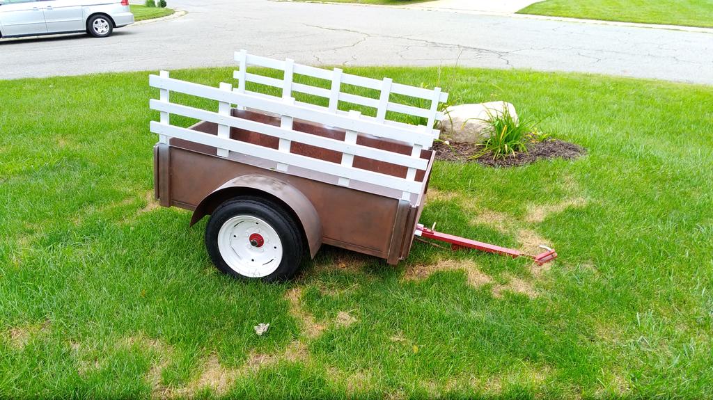

AlexR 3,136 #42 Posted September 6, 2018 (edited) Haven't done much to the trailer need to get some time to weld it up but I had to take the trailer out of the garage and into the shed because my wife is doing a garage sale so i took a photo of it together. Forgive the grass.. Mole problem. Edited September 6, 2018 by AlexC120 2 1 Share this post Link to post Share on other sites
SylvanLakeWH 32,781 #43 Posted September 6, 2018 Looks great! Mole problem? Another use for a ... Just a thought... 1 3 Share this post Link to post Share on other sites

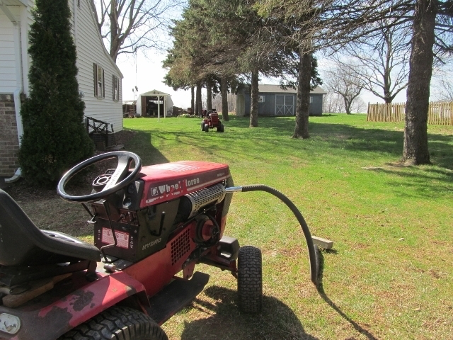

cleat 9,403 #45 Posted September 6, 2018 That is how I handled a ground hog this summer. I used a garage exhaust hose since he had dug such a large hole. I could have used a car but since the Wheel Horses have no emissions I figured they would be more deadly. Main thing is.......No more ground hog. I tried the smoke bombs but they did not work. Cleat 2 Share this post Link to post Share on other sites
Sarge 3,473 #46 Posted September 7, 2018 If you're slightly suicidal - this will take care of a mole right quick and provide some added seat time putting the yard back together, use at your own risk. Btw - this guy has no idea of the effect on his hearing from percussion shock, should have used full plugs and muffs, not to mention a face shield... Sarge 1 Share this post Link to post Share on other sites
Pullstart 71,482 #47 Posted September 7, 2018 Is that just an oxy/lp or oxy/aceteline torch with an igniter essentially? Share this post Link to post Share on other sites
SylvanLakeWH 32,781 #48 Posted September 7, 2018 9 hours ago, Sarge said: If you're slightly suicidal - this will take care of a mole right quick and provide some added seat time putting the yard back together, use at your own risk. Btw - this guy has no idea of the effect on his hearing from percussion shock, should have used full plugs and muffs, not to mention a face shield... Sarge Seems to be in the "hold my beer and watch this..." category... 1 Share this post Link to post Share on other sites
Sarge 3,473 #49 Posted September 8, 2018 The system uses Oxy-Propane as the fuel gasses - which after only 30 seconds or so, can really launch some dirt and cause quite an explosion underground. Now, that said - a slightly leaking buried gas pipe could really turn that into a bad day...lol. Most are running about 40psi of Oxygen, 5psi of Propane - that mix is critical to get the correct percussion effect without the danger of blowing yourself up. The factory equipment uses a back valve for safety and the ignitor is built into the tool. I suppose one could use a demolition torch with a tapered funnel to seal against the critter's tunnel, then use a barbeque grill ignitor with a battery box type ignition to set it off. Those types of ignitors have a piezo-electronic driver in the box, the wiring length is of no real concern so you could get back away from the ignition point. It's still pretty dangerous, so use your best judgment and sense of self-preservation here. In my younger days, we did similar things with Oxy-acetylene, but that resulted in throwing the dirt so far you couldn't find it. Oxy-Propane will produce a much sharper blast - that percussion wave in the tunnel is what kills it's offending resident humanely. Keep in mind, most times if you have moles it's not the moles that is the problem, it's the grubs they are seeking to eat as it's their favorite food source. For those, I've had a good record with a simple spike trap. Sarge Share this post Link to post Share on other sites
