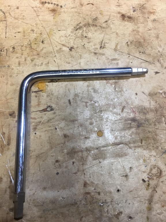

The Tuul Crib 7,347 #5 Posted August 26, 2018 You need to get you one of these. It's a plumbing tool which is the correct size for the drain plug. Worked great for me! Share this post Link to post Share on other sites
