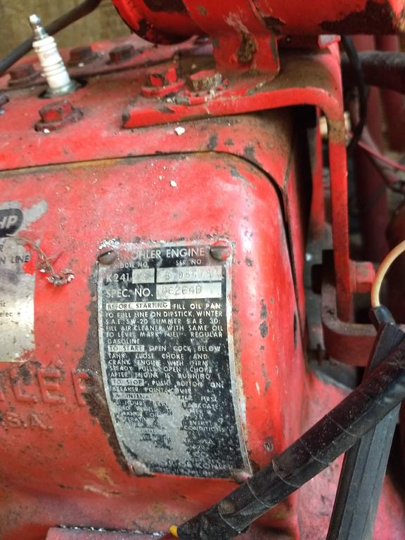

ebinmaine 77,072 #1 Posted August 22, 2018 You can see that there's some kind of a guard over the top of the exhaust Outlet on the engine. Also, the oil dipstick tube is different from any of the Wheelhorse tractor setups I've seen in the older rigs. 1 Share this post Link to post Share on other sites
gwest_ca-(File Mod) 11,978 #2 Posted August 22, 2018 https://www.partstree.com/parts/kohler-engines/engines-horizontal/k241-46264-kohler-k241-engine-k-series-jacobsen-10hp-7-5kw-specs-4600-46858/ Garry 1 Share this post Link to post Share on other sites

WHNJ701 4,168 #6 Posted August 23, 2018 just a guess, was it off a gravely? Share this post Link to post Share on other sites
WHX?? 54,508 #7 Posted August 23, 2018 3 hours ago, ebinmaine said: If I want to bench test this engine can somebody tell me what wires to put where? Does this look like this is our first rodeo? 3 Share this post Link to post Share on other sites
KC9KAS 4,746 #8 Posted August 23, 2018 7 hours ago, jabelman said: just a guess, was it off a gravely? No, a Jacobsen, per GWEST's post. Share this post Link to post Share on other sites
