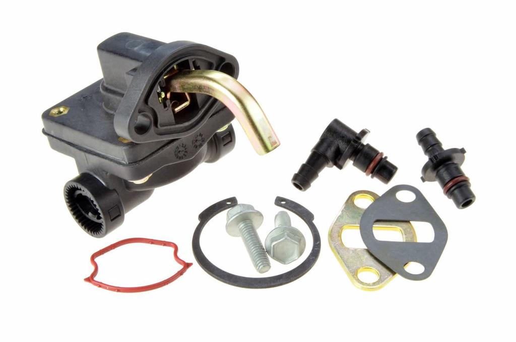

r356c 375 #6 Posted August 18, 2018 One of these, correct? Share this post Link to post Share on other sites
MAD MARK 74 #7 Posted August 18, 2018 I have tried one of those. And I have tried the OEM off the 92 312-H. Share this post Link to post Share on other sites
r356c 375 #8 Posted August 18, 2018 Right about now I would be trying the gravity feed IV fuel bag trick straight into the carb to see if an electric fuel pump was in my near future. A worn lobe for the fuel pump actuator arm or a too thick spacer between the pump and block are a few other thoughts. 1 Share this post Link to post Share on other sites
MAD MARK 74 #9 Posted August 18, 2018 (edited) I was leaning towards worn arm. But I searched the forums and saw that as a thought but, never the end cause. I will try a direct gravity feed into carb. If runs good, I see an electric boogie woogie going in. Edited August 18, 2018 by MAD MARK 1 Share this post Link to post Share on other sites

bds1984 1,506 #16 Posted August 23, 2018 I went through the same issue a couple years ago with a rescued 312-8 and tried all the "usual" fixes. The culprit: there was a second gasket on the fuel pump which prevented the pump arm from achieving a full stroke. Share this post Link to post Share on other sites
cleat 8,740 #17 Posted August 23, 2018 You really need a full stroke 1 Share this post Link to post Share on other sites
MAD MARK 74 #18 Posted August 23, 2018 I did just read something today about not using both the felt gasket and the squiggly one together. Maybe that's the problem with the newer mech pump. Share this post Link to post Share on other sites
