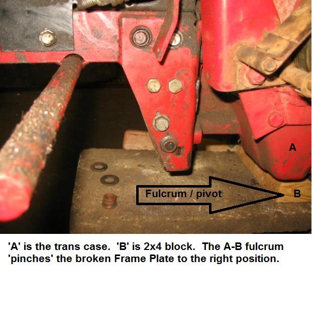

WHwest8597 85 #1 Posted August 15, 2018 I have 1997 314-8 frame that is cracked in the back plate. I'm trying to decided to repair the plate or just replace the whole frame. I have a 417-8 frame and 416H frame. Share this post Link to post Share on other sites

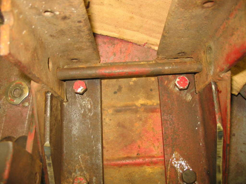

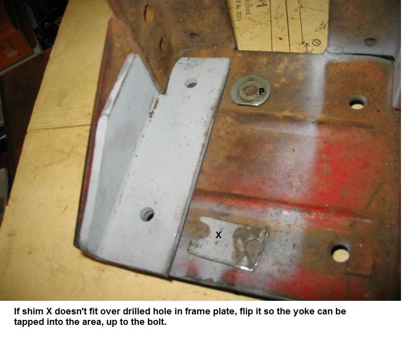

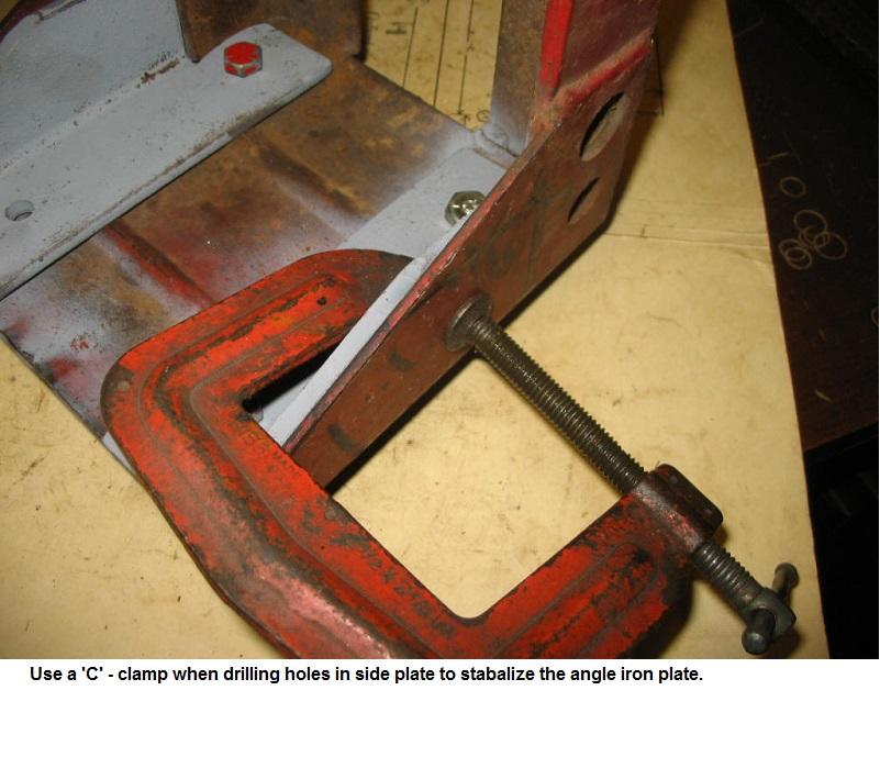

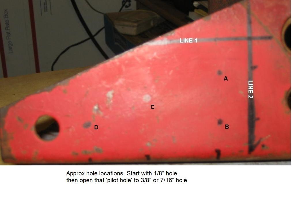

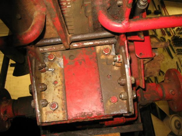

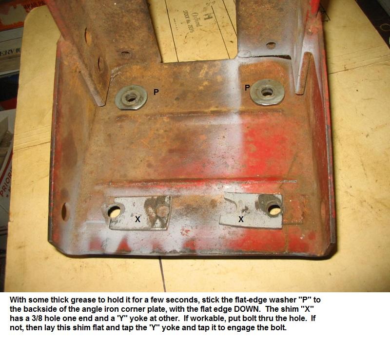

daveoman1966 3,839 #6 Posted August 15, 2018 (edited) Welding can make the metal brittle, and subject to future cracking. Here is a way to repair AND reinforce the corners to preclude cracking. Use 2" x 1/4" (or 5/16) angle iron about 6" long. When bolting up, use Nuylok nuts. You'll need 4 bolts 3/8"--1/2" or so longer than original 4 bolts holding the end plate to the trans case ...but not too long. Edited August 15, 2018 by daveoman1966 2 Share this post Link to post Share on other sites

daveoman1966 3,839 #9 Posted August 15, 2018 38 minutes ago, JAinVA said: I doubt you are going to get anyone to repair the cracked area with the transaxle .engine or front axle attached.It looks like the frame repair being shown by daveoman1966 is being performed on a bare frame. YES... I used a bare frame as a DEMO of what to do...how to prefab the angle iron by size and shape. It is easy enough to install this onto because, the tractor MAY drop if you take out all four mounting bolts at the same time. Share this post Link to post Share on other sites
daveoman1966 3,839 #10 Posted August 15, 2018 YES... I used a bare frame as a DEMO of what to do...how to prefab the angle iron by size and shape. I can't lay on my back to get the pics...I'm not 27 anymore....lol. It is easy enough to install this onto a working tractor...just work on and complete one side at a time. because, the tractor MAY drop if you take out all four mounting bolts at the same time. 3 Share this post Link to post Share on other sites
JAinVA 4,636 #11 Posted August 15, 2018 (edited) I'm not 27 or even double that anymore so I get it! You have a good idea for a repair that doesn't require welding.If someone wants to have one welded,a lot of stuff will have to be removed to do it right. Edited August 15, 2018 by JAinVA Share this post Link to post Share on other sites
