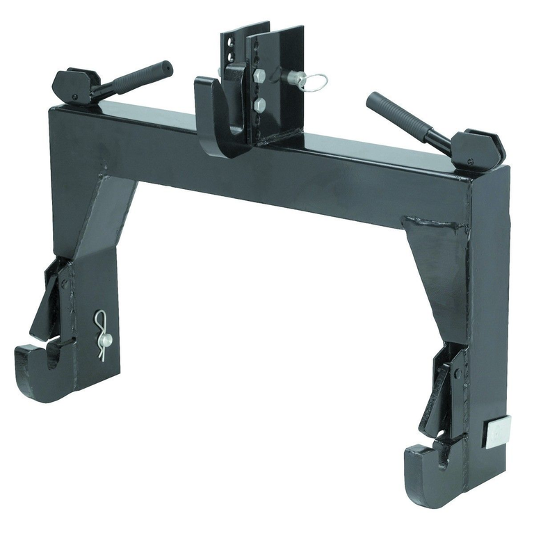

pacer 3,179 #2 Posted August 13, 2018 Yep, hooking up a 3 point can be stressful especially when tucked in as close as your mower. There IS a solution --- IF you can locate one for the cat 0 hitch, they are a bit pricey but if you have to connect often would be great, they range in price from $100ish ..... to way expensive. Quick Hitch 2 Share this post Link to post Share on other sites

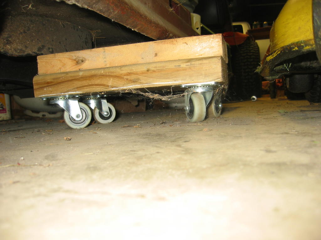

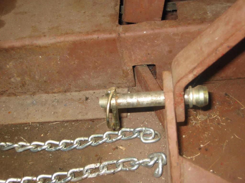

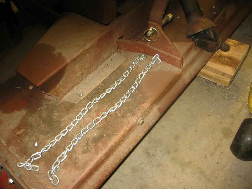

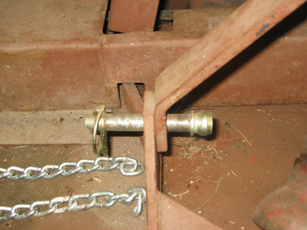

pfrederi 19,933 #4 Posted August 13, 2018 I use the chains as the ground i cut was very rough and uneven with depressions etc. I made up a simple dolly keep it under the front of the mower. 2x6 scraps an some cheap casters. Makes it easy to move around the storage area. Also gets her up high enough to line up with 3 pt. Also lets you move the deck around a bit to get the 3 point arms hooked up. (Skipper move the tract I move the deck 2 different solutions) 4 Share this post Link to post Share on other sites
Skipper 1,790 #5 Posted August 13, 2018 Looks like pfrederi also has non fixed hitch pins (they look like they can slide) and that means you get even more space and flexibility to hook up. You might even be able to drive right into the perfect spot! Brilliant idea! 3 Share this post Link to post Share on other sites
pfrederi 19,933 #6 Posted August 13, 2018 Yes they slide in and out makes hook up fairly easy 3 Share this post Link to post Share on other sites
