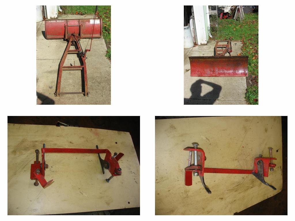

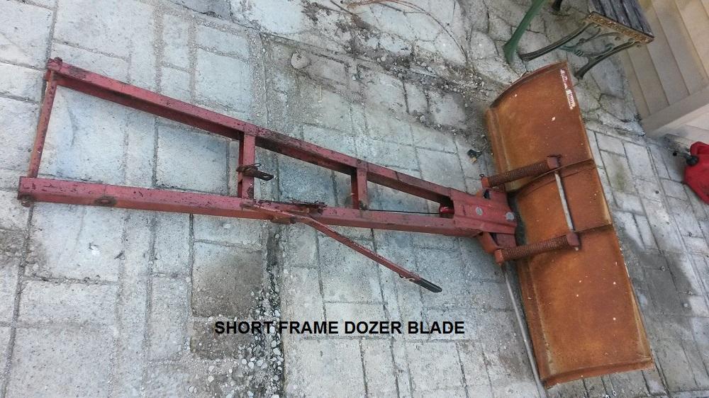

daveoman1966 3,882 #2 Posted August 13, 2018 Are you sure you have the right A-frame. There is a dozer A-frame made for a SHORT tractor, and another for a LONG FRAME traftor...they are NOT the same, and neither is the Axle bracket. It should look like this one...axle bracket is shown too. I'm also posting a pic of a SHORT FRAME dozer blade...(not for the 310-8). 4 Share this post Link to post Share on other sites
