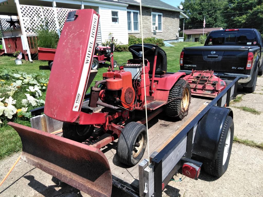

Daron1965 644 #1 Posted August 13, 2018 Went to a persons house that was advertising a wheel horse snow plow for sale for $50. He stated it was usable, but rough. I arrived and looked at the plow, He stated I could have the plow for $50, or whole, NON running tractor and deck for $75. It took me about 3 seconds to get my wallet out and give him the money. Hope I did out ok. Its a 1100 Special. Im sure I will be full of questions. I find myself looking at numerous websites, for wheel horse items. Im sure there has to be a cure, but Im not sure on what the number of tractors will be the cure. LOL 11 Share this post Link to post Share on other sites

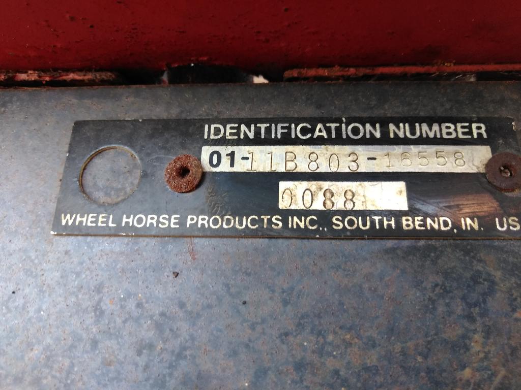

Sparky-(Admin) 24,636 #7 Posted August 13, 2018 You did great for only $75!! Here's what you have: 01-11B803 1980 C Series Garden Tractor 1100 Special 8-Speed Briggs 252417-0198-01 11 Wheel Horse 5086 1 Share this post Link to post Share on other sites
Daron1965 644 #8 Posted August 13, 2018 Thank you Sparky, for the info. I know I will need to rewire it, and put new fuel lines on it. It now only has a fuel line coming from the tank, to a block looking pump with two other outputs (i think) Not even sure the tank line is hooked up to the pump in the correct location. Trying to find a diagram of the fuel line routing now. 1 Share this post Link to post Share on other sites

953 nut 64,141 #10 Posted August 13, 2018 8 hours ago, Daron1965 said: It now only has a fuel line coming from the tank, to a block looking pump with two other outputs What you have is a "pulse pump" which is operated by the vacuum and pressures created in the crank case as the piston travels up and down. This manual should be helpful. 2 Share this post Link to post Share on other sites
