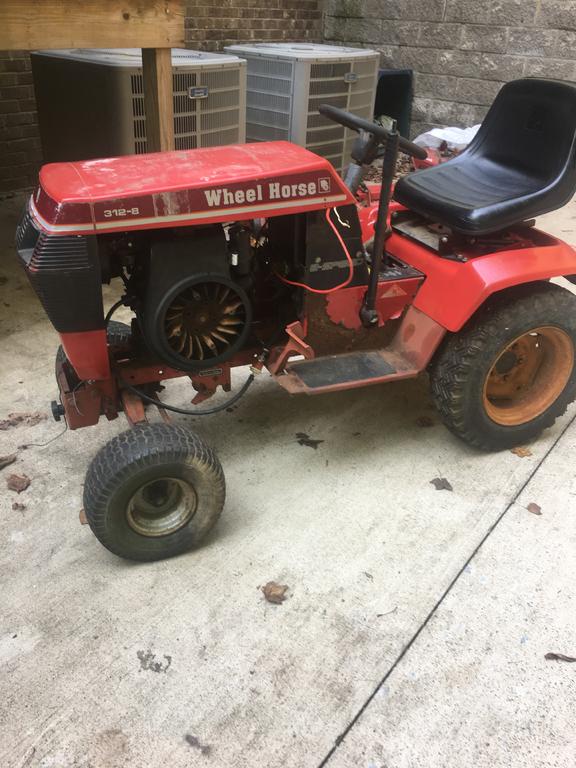

The Tuul Crib 7,340 #1 Posted August 11, 2018 I just got this hundred dollar turd I picked up did some adjusting cleaned it up a little runs like a top. Only one thing I'm having a hard time with is that it won't start up at the key I turn the key on and jump at the solenoid and it fires up. I know it has to be something simple maybe a starter relay or maybe a bad so annoyed! Ha! Share this post Link to post Share on other sites
gwest_ca-(File Mod) 11,978 #2 Posted August 11, 2018 Post the engine numbers or the tractor model number so we can determine what is involved in the starter circuit. It is 1989 or older but that still leaves 3 or 4 different wiring diagrams. Garry Share this post Link to post Share on other sites
The Tuul Crib 7,340 #3 Posted August 11, 2018 It's a k301 spec 47828 the serial starts with 16. An 87 model? 312-8 Share this post Link to post Share on other sites
