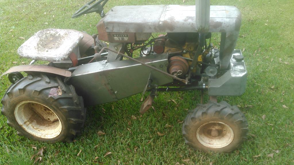

Lee1977 7,298 #27 Posted August 11, 2018 (edited) Both of my Wheel Horses are highly modified. The C-120/180 with an 18 Briggs Vanguard 5 lug front hubs and wheels with 6 ply tires. 1/2" heims joints on the tie rods new fan gear steering rod with nut adjustment ( not sure what model WH it was for I ordered it some time in the early 90"s ). Turned a new front axle pivot pin out of a Mercury tie rod. Built a front bumper and 2" receiver hitch to the rear. Added a oil pressure gauge and I'm sure I forgot something. The 312-8 has reinforced front spindles the, frame has been reinforced with 1/4" x 1 1/2" steel down the the bottom of the transmission mount. The rear fender, brackets and gas tank has been raised 1 3/4" for 25x900x12 rear tires also 2" receive was added braced off the top of the transmission. free image hosting sites I can't say what modification I like best, maybe the next one. The foot rest has been reinforced If you look close on the last picture I spot welded 3/8" rod under the out side edge. They were bent when I got the tractor I beat them back straight. Edited August 11, 2018 by Lee1977 4 Share this post Link to post Share on other sites

Lee1977 7,298 #29 Posted August 11, 2018 I had to scrape the built up grass out of my deck. We were dry for almost two months then the end of July I rained a couple of storms for two weeks. This last week It only rained three time. I had the tractor jacked up to get the grass out and one front wheel sounded dry. So I took it apart to add some grease and took a couple of pictures. Here is the modified front spindle. The big section is 1 3/8" and the small one is 1 1/16". Greased and back together good for another 30 years until the next greasing. host image 1 Share this post Link to post Share on other sites
Digger 66 3,488 #30 Posted August 11, 2018 Pop a greasable "bearing buddy" on there in place of the dust cap and you'll be able to grease them without taking the whole shebang apart . https://trailerparts.com/trailer-hub-grease-cap-kit-1-99-1-31-32-o-d-1-pair.html?gclid=CjwKCAjwkrrbBRB9EiwAhlN8_NBFkxMRe-XmEvCiLx5KKbqJMeEFPWbDlYqkeIaSeDqqifdspEF7exoCnFsQAvD_BwE 2 Share this post Link to post Share on other sites
Skipper 1,790 #31 Posted August 12, 2018 For trailer hub conversions I would suggest getting the hub type that has a grease zerk. That fills from the inside/middle, and pushes out old grease. Just an idea for the ones about to do it 2 Share this post Link to post Share on other sites
