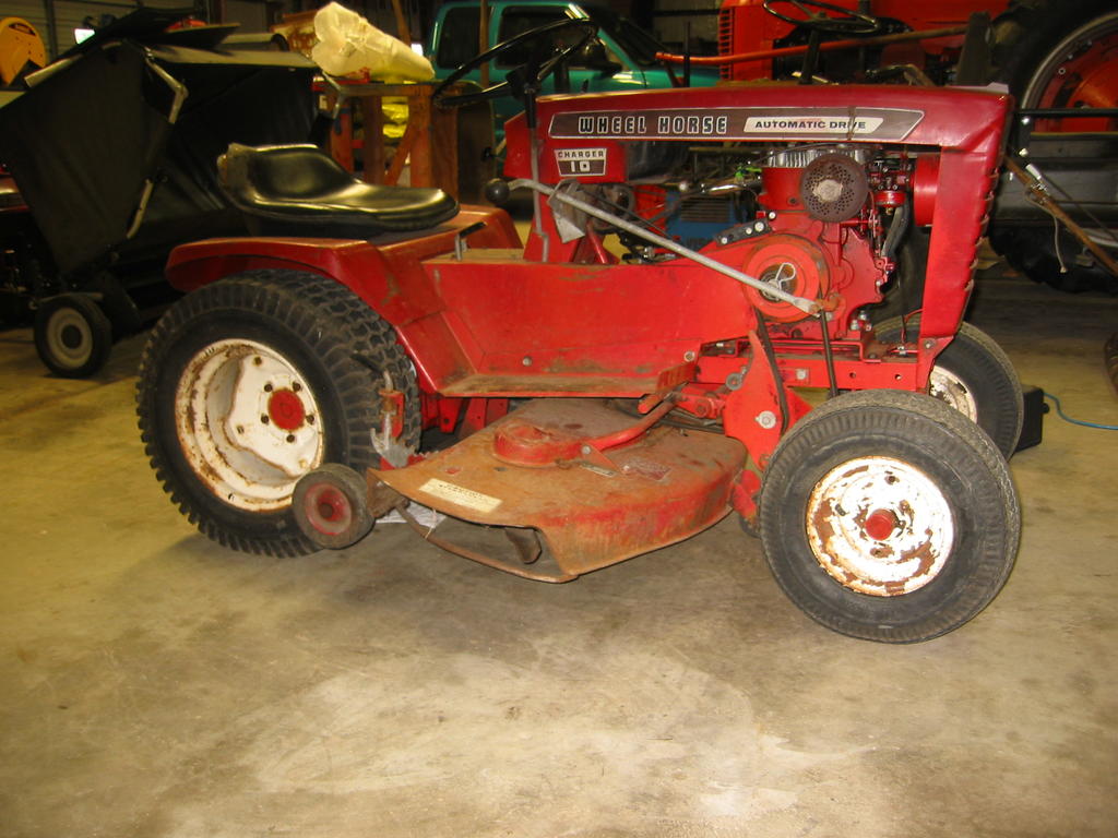

pfrederi 19,915 #2 Posted August 9, 2018 (edited) Welcome!!! It might be simpler and cheaper to convert it to a manual PTO. Also Electric PTOs show up on Ebay from time to time. This is a manual PTO set up on a Charger. You need the bracket that bolts to the hoodstand (holes are already there) the long rod and a PTO friction plate and cone. Is an easy job A modern Electric PTO would require fabricating a mount and would not have the dual pulleys that give different speeds for mowing or snowblowing Edited August 9, 2018 by pfrederi 2 1 Share this post Link to post Share on other sites
