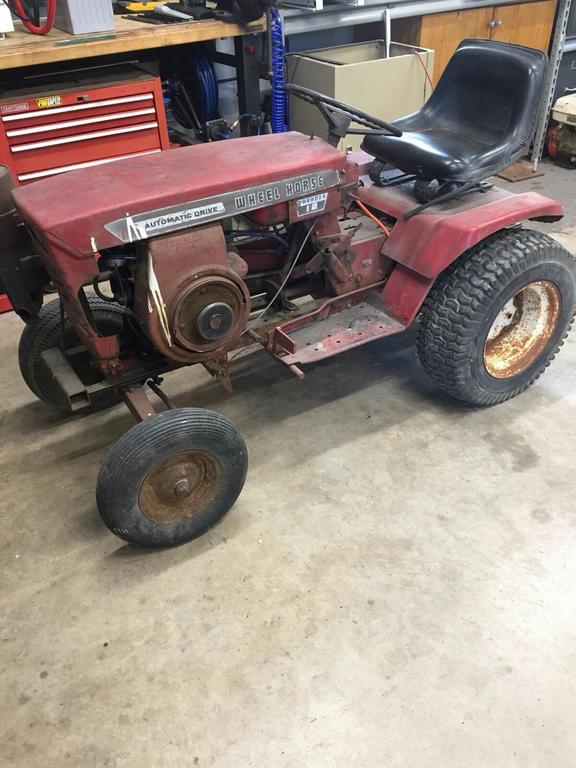

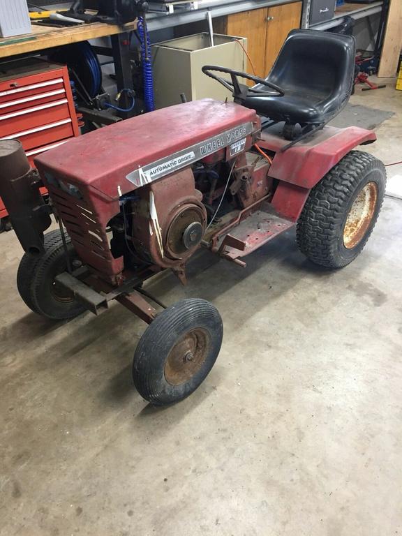

The Gman 476 #3 Posted August 6, 2018 (edited) I planned on bring a small gas tank and fuel line to hook direct to the carb. He's said it was the fuel pump. Here are the two pics from the ad. Edited August 6, 2018 by The Gman Share this post Link to post Share on other sites
pfrederi 19,941 #4 Posted August 6, 2018 If you have to pay to have the tranny fixed trust me it will be a lot!!! More than the unit is worth. If you are comfortable working on it yourself different matter. 1 Share this post Link to post Share on other sites
953 nut 64,278 #5 Posted August 6, 2018 1 hour ago, The Gman said: bring a small gas tank and fuel line to hook direct to the carb. Good idea! If it runs long enough to test the transmission and all seems good you have a nice parts tractor there! There is no lift, the hood has been butchered, I suspect there is probably nothing very pretty on the other side. If you are looking for a worker just keep looking. 2 Share this post Link to post Share on other sites

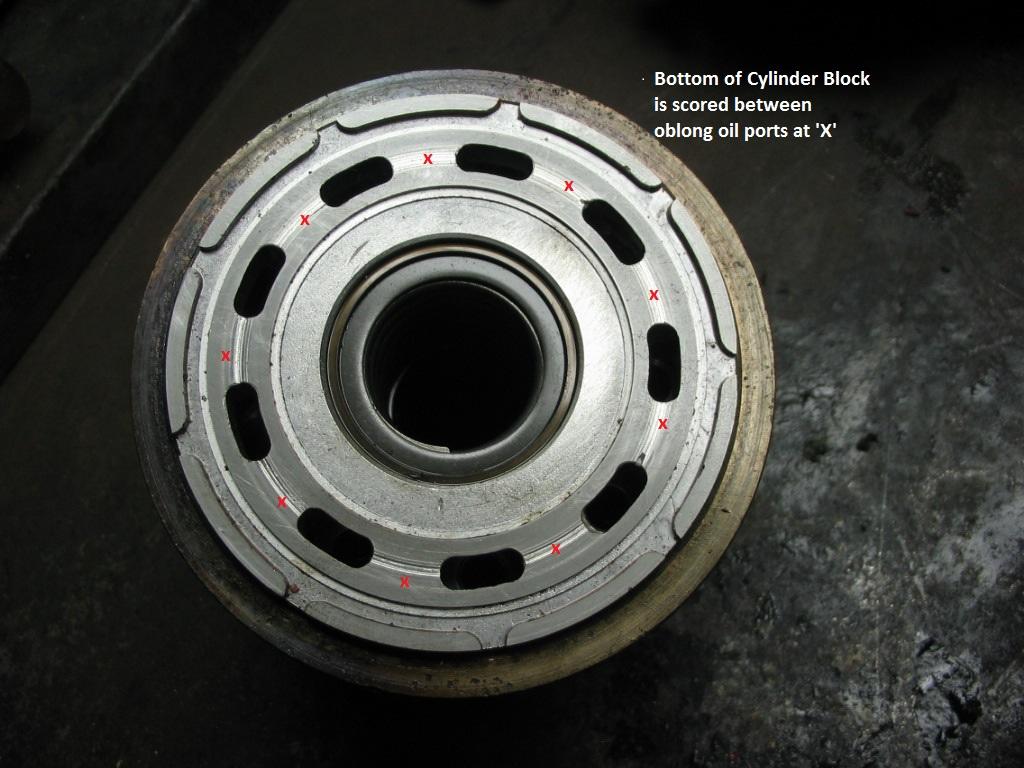

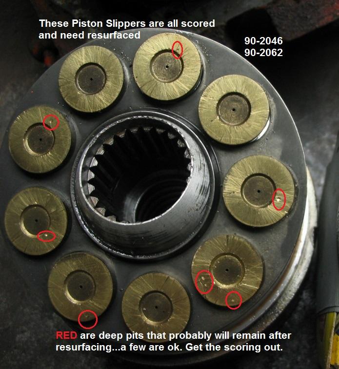

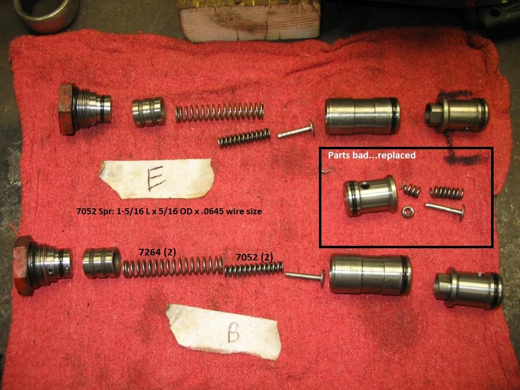

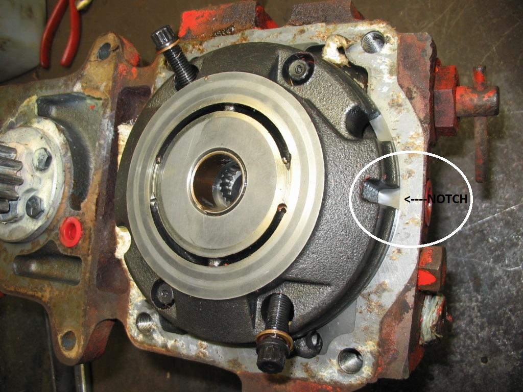

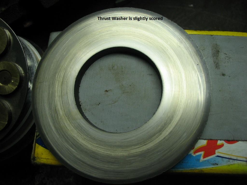

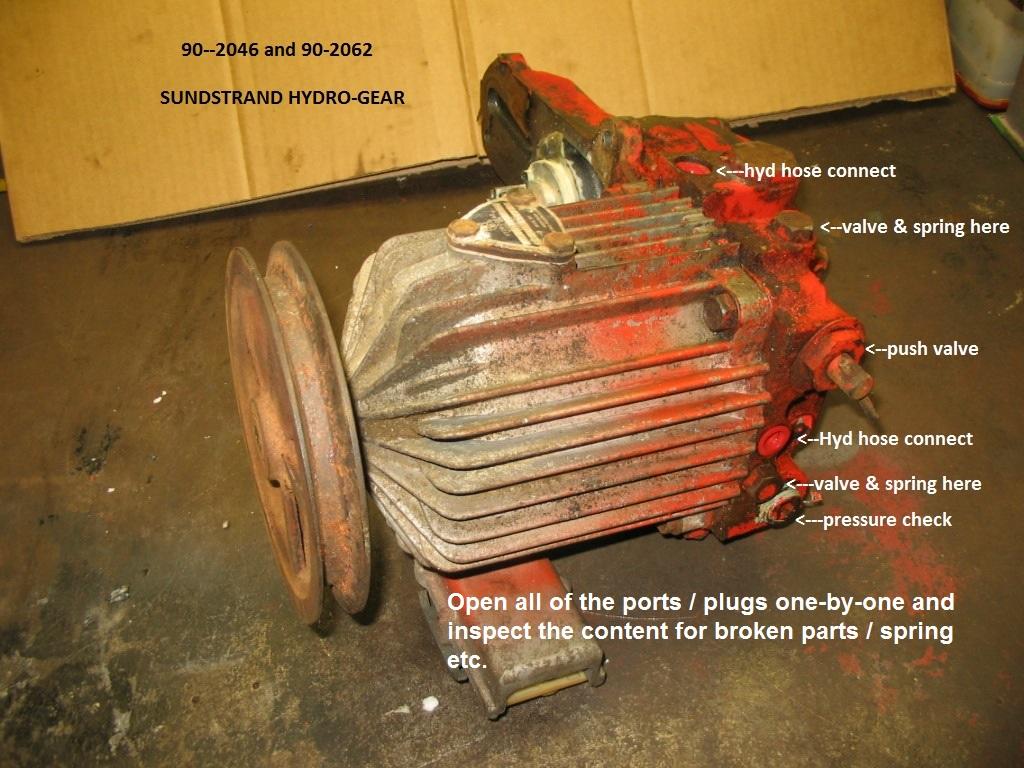

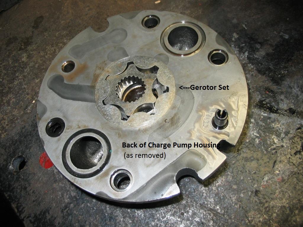

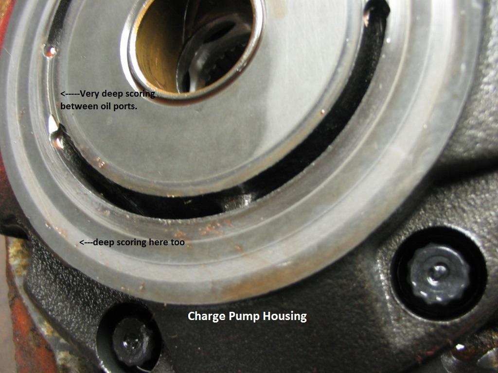

daveoman1966 3,882 #6 Posted August 7, 2018 (edited) W/H made the Charger 12 from 1968-72... That's 45-50 yrs old. The Sundstrand auto is model 90-2046 (if original) and actually not too difficult to service, if needed. The tuffest part is just refinishing the internal parts of the pump to restore the hyd pressure. Not difficult, but time consuming to do it right. I've done 8 or 10 of them over the years and have the same 90-2046 unit in my '72 Bronco 14. To do it yourself...with new bearings & seals...probably < a C note. Here is a pic or two of the guts of the 90-2046 unit: I have SOME spare parts, if needed. Edited August 7, 2018 by daveoman1966 2 2 Share this post Link to post Share on other sites
The Gman 476 #7 Posted August 7, 2018 Great assessment of what goes wrong and areas of damage Dave. Thankyou for the show and tell. I've never been shy at getting up to the elbows in it to learn something new. A "C" note wouldn't scare me off. I mean we would all put that and a bit more into a 301 or 341 to breath life back into a Kohler. He was asking 200 for it and I got him down to 140 so far. He's gone quiet since I asked about the tranny and the ads been up for 3 weeks. I have a charger deck for it. Also a charger frame with all the tins and a good lift arm for not much more than a bottle of scotch (the good stuff) and a case of beer. Just didn't know what the possible repair costs might be. This helps give me a ball park. Think I'll hound him (nicely) of course. Thanks again Gary Share this post Link to post Share on other sites
daveoman1966 3,882 #8 Posted August 7, 2018 Its your money but, if it was me..... go for the 140. It is, after all, only money. ps...I see the hood is chopped up...I ahve a replacement hood, and a lift handle to fit. Problem is, you're in kannuck country and I'm in the USA.. About 40m south of Erie, PA. Buffalo is a 2-hour drive from me. 1 Share this post Link to post Share on other sites

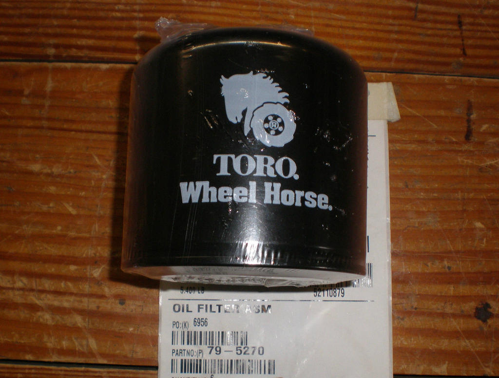

daveoman1966 3,882 #9 Posted August 7, 2018 It may be that the Sundstrand Hydro-gear 90-2046 pump and such is in good working order. Once you get the engine running, the way to test is: 1) run it around the yard for 20 min or so...until it gets to operating temp. 2.) chain it to a tree and see if it has the power to spin both back wheels. 3) if both spin (has a 10-pinion LSD) it is probably good to go, without a rebuild. 4) Change fluid (ATF is pink) or oil and use OEM filter. 2 Share this post Link to post Share on other sites
