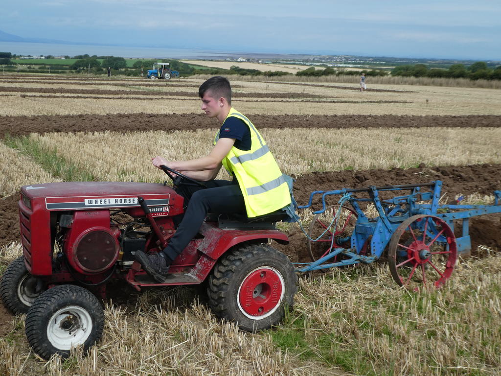

Stormin 9,986 #1 Posted August 6, 2018 (edited) Number 3 grandson ploughing for the first time with a friends Raider 12 and a Ransomes drag plough. Edited August 6, 2018 by Stormin 2 5 Share this post Link to post Share on other sites
stevasaurus 23,490 #2 Posted August 6, 2018 That is a calendar shot Norm. Gorgeous. Love that plow too. 1 Share this post Link to post Share on other sites
Pullstart 68,388 #3 Posted August 6, 2018 I’d love to see more angles of those machines working the soil! Share this post Link to post Share on other sites

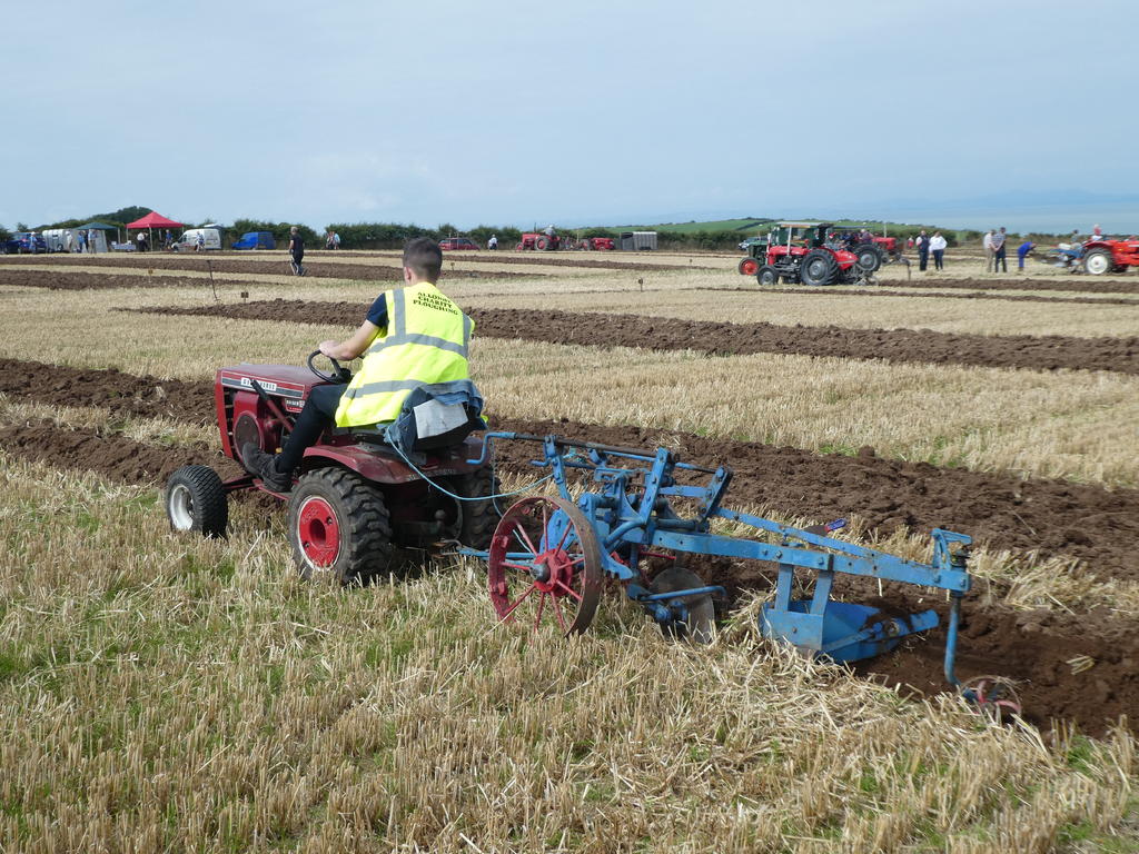

Stormin 9,986 #4 Posted August 6, 2018 Another photo taken from the rear. 2 1 Share this post Link to post Share on other sites
stevasaurus 23,490 #5 Posted August 6, 2018 Right Kevin...look at all the places to adjust that interesting piece of equipment. 1 Share this post Link to post Share on other sites
Stormin 9,986 #6 Posted August 6, 2018 It had never been used for sometime. Getting it the plough something like took some time. Rusty pins and clips. Not to mention the blind leading the blind. I'd never used one before and neither had my friend who owns it. Was fun though. 2 Share this post Link to post Share on other sites
farmer 1,081 #7 Posted August 6, 2018 Unique set up, how did it balance up when raised out of work? I’m guessing ransomes plough for a ransomes crawler, quite a test for a wheel horse. Nice. Share this post Link to post Share on other sites
Stormin 9,986 #8 Posted August 6, 2018 (edited) Yes Farmer, you are right. Built for a Ransomes crawler. Balances fine but the plough share is very close to the ground. If you look at the second picture, you will see, behind the wheel, half way up a bar with notches in. One of those ropes is tied to a rod. Pull that out and then release it and that bar drops down and engages with pegs protruding from the back of the wheel hub. As the wheel goes round, the pegs lift that bar and that raises that side of the plough till it locks. To lower it, you pull the same rope and that side will drop. Anyone standing at the side should keep fingers well clear. (Don't ask how I know) The handle on the left, looking from the rear, controls the depth wheel which is the wheel on the opposite side. The other handle controls the small trailing wheel at the end. That tilts the plough down or up. Lining it up behind the tractor is done by altering the position of the draw bar. It's in three pieces. There's a cross bar with several holes in which you can move left or right. Another bar again with holes in, goes to the tractor and one more from plough to that bar with a pin in the end. The pin can be fitted in any of the holes in the tow bar. That lot adjust plough left or right to suit the tractor. You can see them in the first picture. I hope that description is understandable. Edited August 6, 2018 by Stormin 3 1 Share this post Link to post Share on other sites
