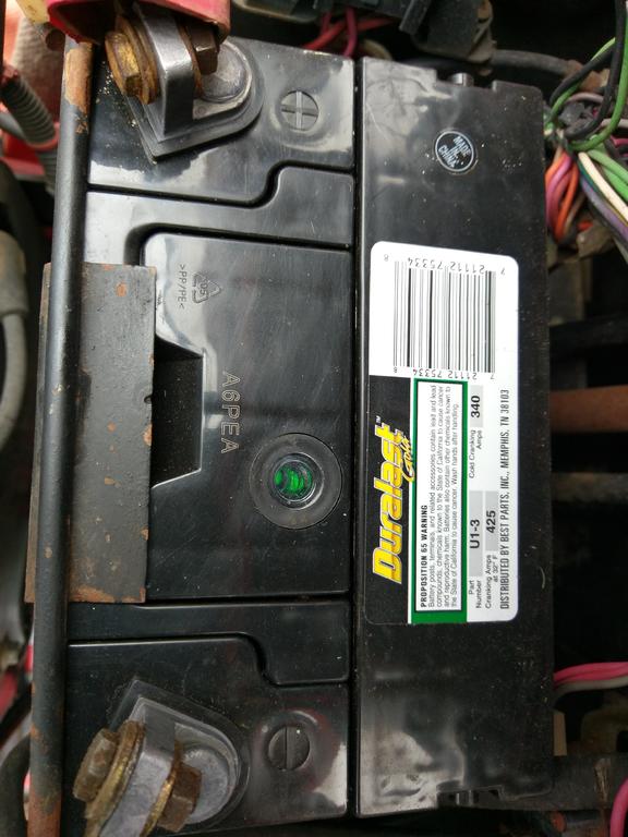

WVHillbilly520H 10,376 #3 Posted August 5, 2018 It's a bit more expensive but I've had good luck with AutoZone Duralast batteries in my 520s right at $50 with core,Jeff. Share this post Link to post Share on other sites
peter lena 9,231 #4 Posted August 9, 2018 for 50$ that's good , 340 cca is also good, do you have a battery tender? easy to bolt right on , and have the cable handy to plug in on those cold plowing days, pete Share this post Link to post Share on other sites
lynnmor 7,788 #5 Posted August 10, 2018 The 520H models had 280 CCA batteries from new. Anything from that level and up should be fine. Share this post Link to post Share on other sites
