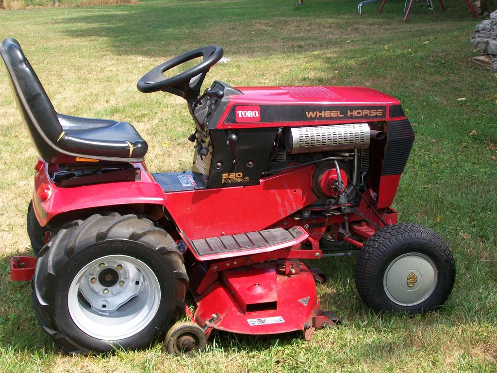

Anybody had any success mounting Kenda Terra 502 tires on 7.5 x 12 Wheel Horse rims?
Kenda says the tire needs a 8.5 x 12 rim. They spec. out as 23 x 10.5 x 12.
My 318 rims measure 7.5" from inside of bead to inside of bead. So they just might work.
Reason for all this being I have some steep slopes down to the lake. Yard has a toboggan run slope, a couple of 8 - 10 foot drops with flat areas in between.
Total drop of about 20 feet in about 100 feet. Plus the soil is Michigan sand. Grass is thin and the old original Carlisles just aren't cutting it anymore.
Looking for a more agressive tire for turf. Have read some goon reviews of the 502's on this forum. But not much detail on the rims they were mounted on.
Any experiences good or bad would be appreciated.
Thanks
Old 5 Foot
By tntatro
I recently put different rims and tires on my 1973 no name and found that the center on the hubs are smaller than the center on the rims. The original tires were 20 x 10 - 10 and I replaced them with rims from a C160 and put 23 x 8.5 - 12 lug tires on. I first tried chains on the tires but the plow would rub on the chains so I switched the rims out and put on the lug tires.
My question is, is this okay or will it likely cause problems. The lug nuts seemed to all go on normal except I had to hold the wheel up to start the first one.
