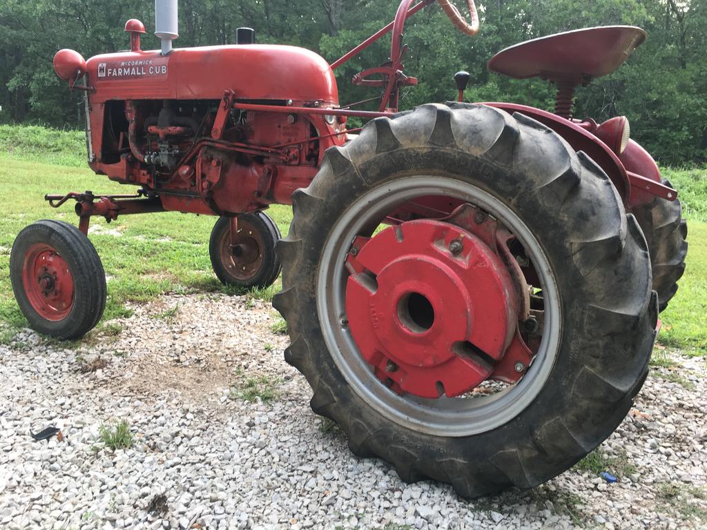

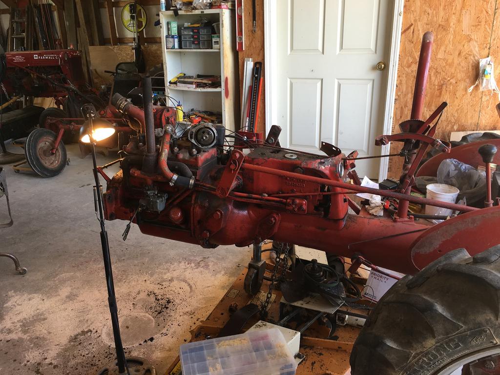

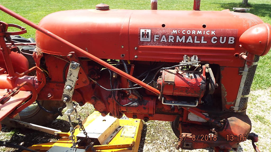

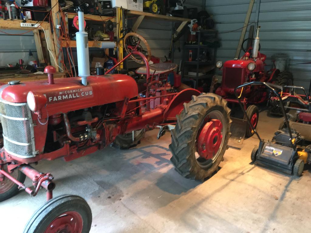

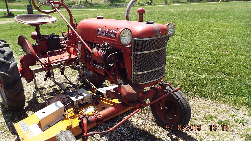

T-Mo-(Moderator) 4,690 #1 Posted August 4, 2018 I picked up a second Farmall Cub, a 1950, to go along with my 1947 one I bought last summer. This one runs good, but has some unique modifications that I have been addressing. It came from a buddy of mine's neighbor. He had passed away recently and his son wanted John to sell it for him. John already has 3 Cubs so he put this one up for sale. The previous owner, before he passed, had a bit of dementia, which is perhaps why the odd modifications. The generator, which is supposed to go under the hood, was relocated to the right side of the hood, and there was wires spliced everywhere. The 6V battery was connected backwards - in the Cub 6V system, the positive terminal is the ground. The front seal was leaking and there were a few other issues. I left it at John's place, and with his help, we have been working on it. First relocating the generator to it's proper place, plus a new voltage regulator, a new starter to negative terminal cable, the correct fuel strainer bowl, and are rewire the whole tractor. A new fuse holder and another light switch, was also added. I ordered a free safety gas cap from IHC and will need to still address the Woods mower issues. Here are some pictures, first the way I bought it. 7 2 Share this post Link to post Share on other sites

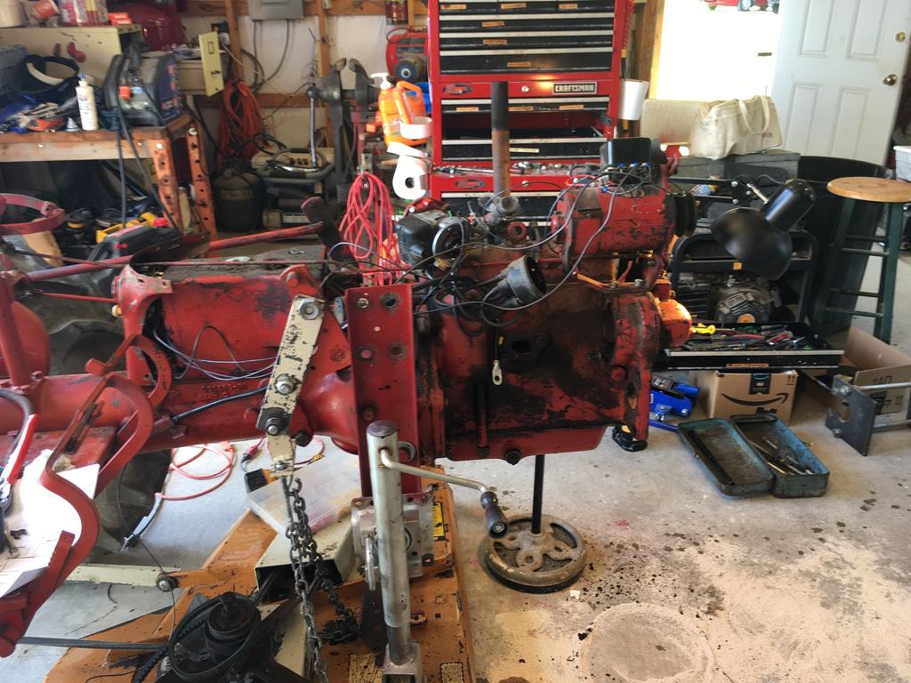

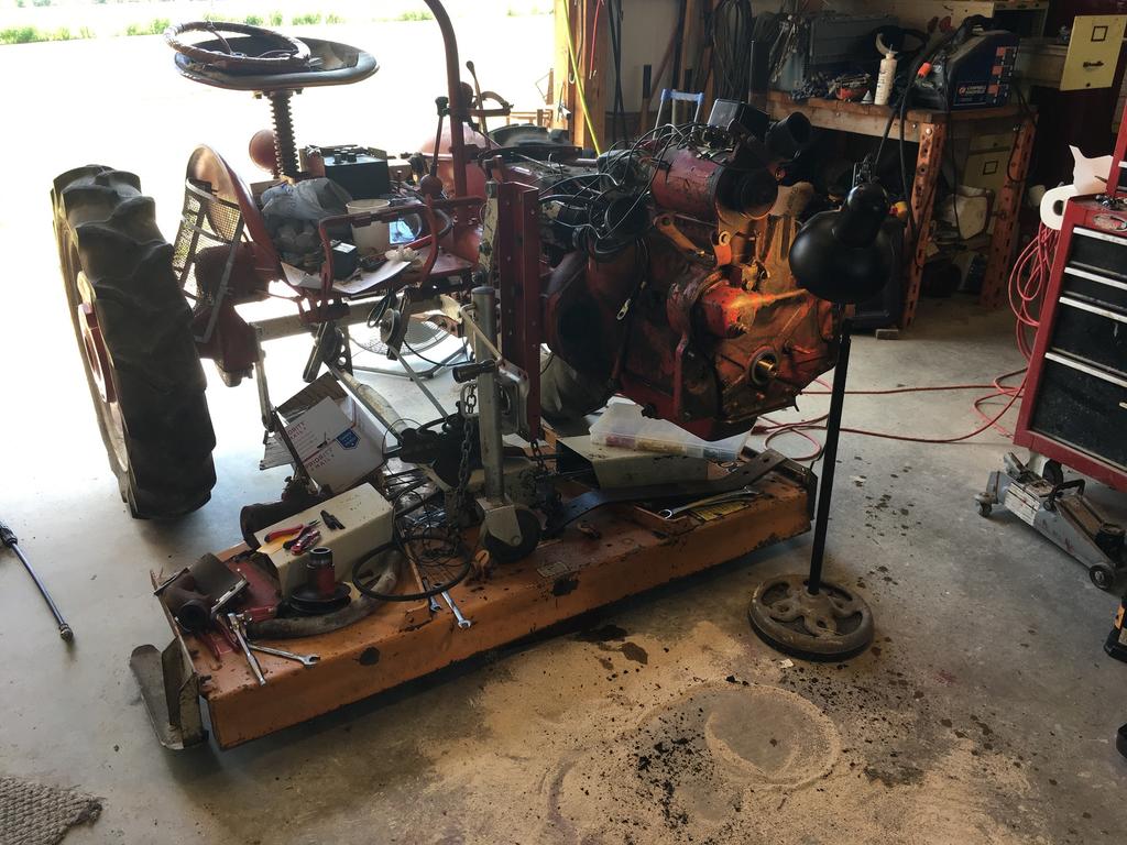

T-Mo-(Moderator) 4,690 #2 Posted August 4, 2018 Next, the work in progress. We should finish her up today and I will be taking it home. Hopefully, that is, and will include more pictures of it "fixed" then. 7 Share this post Link to post Share on other sites

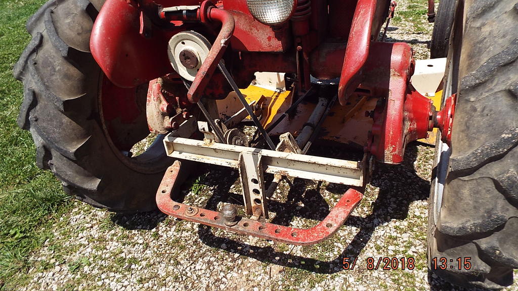

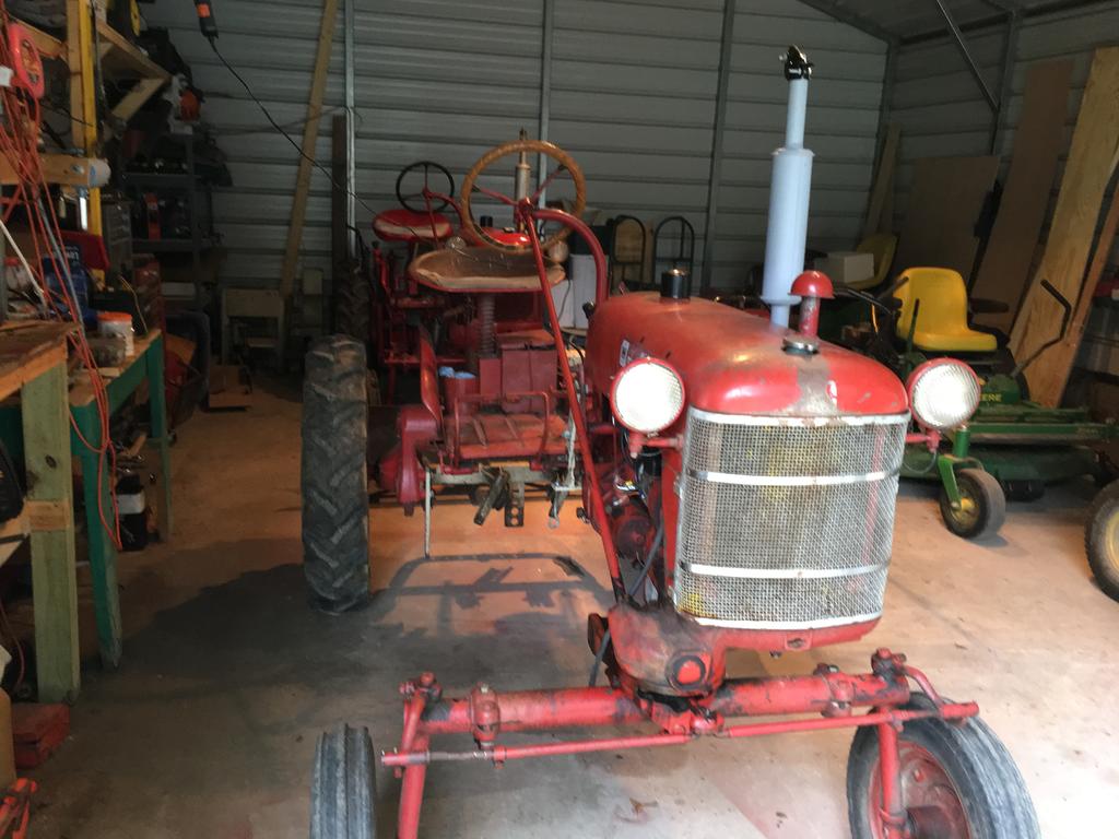

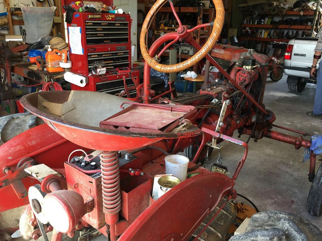

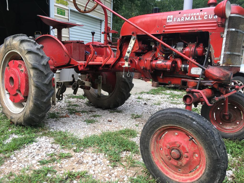

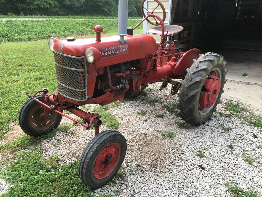

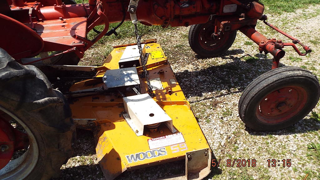

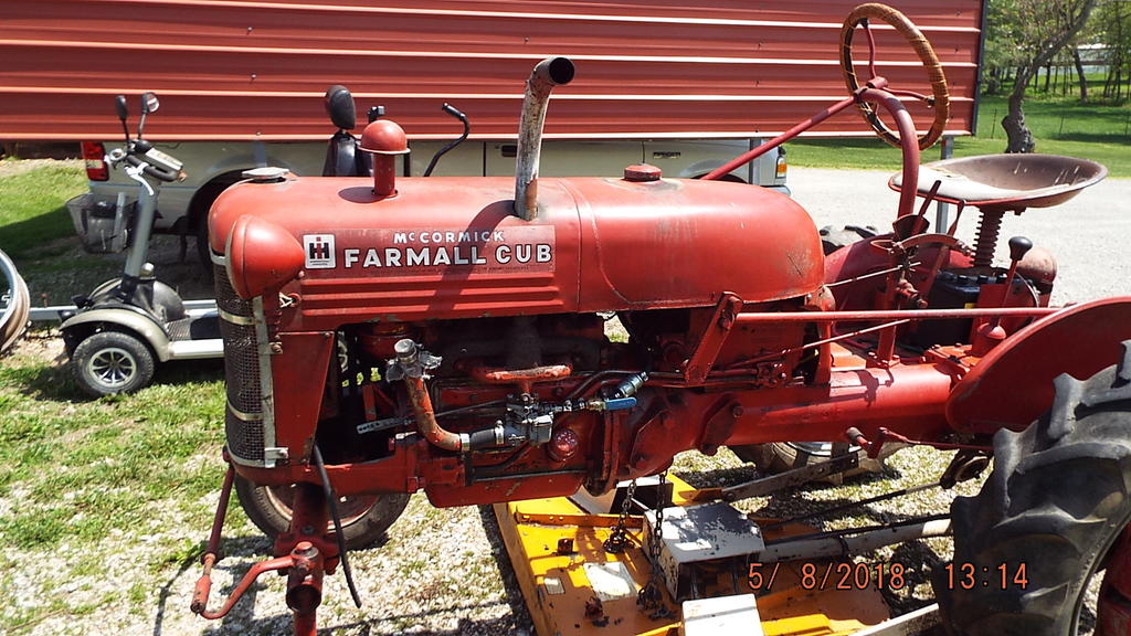

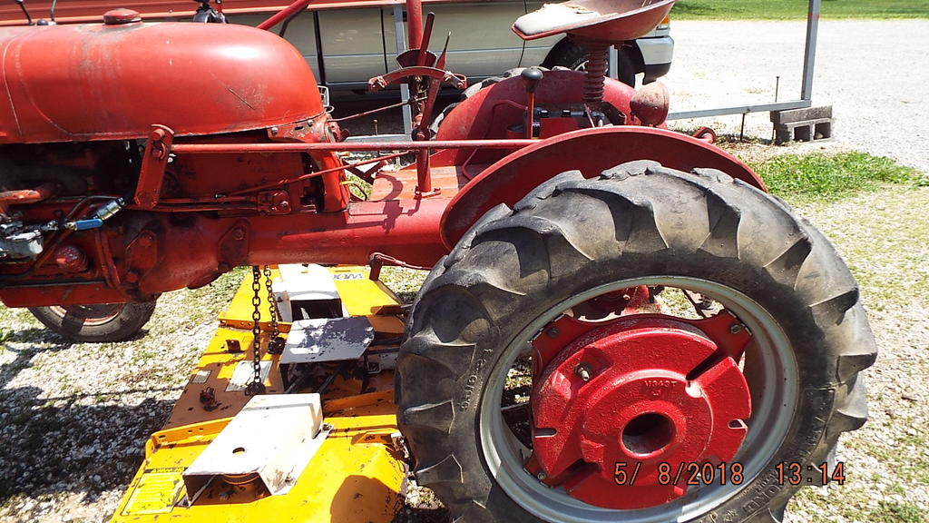

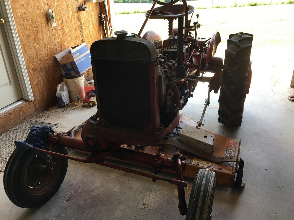

T-Mo-(Moderator) 4,690 #7 Posted August 25, 2018 Well, she's finished, sort of. Here are the "after" pictures. I'm not going to restore or refurbish this Cub, but leave it as is for the time being. I just wanted to get the wiring correct, fix some things and return some functionality. I removed the deck and removed a bent blade and power washed the deck. I still have to buy blades and a belt, but that may have to wait. I will be going to Cub-arama next month and will look for some bargains for both of my Farmall Cubs. 6 1 Share this post Link to post Share on other sites

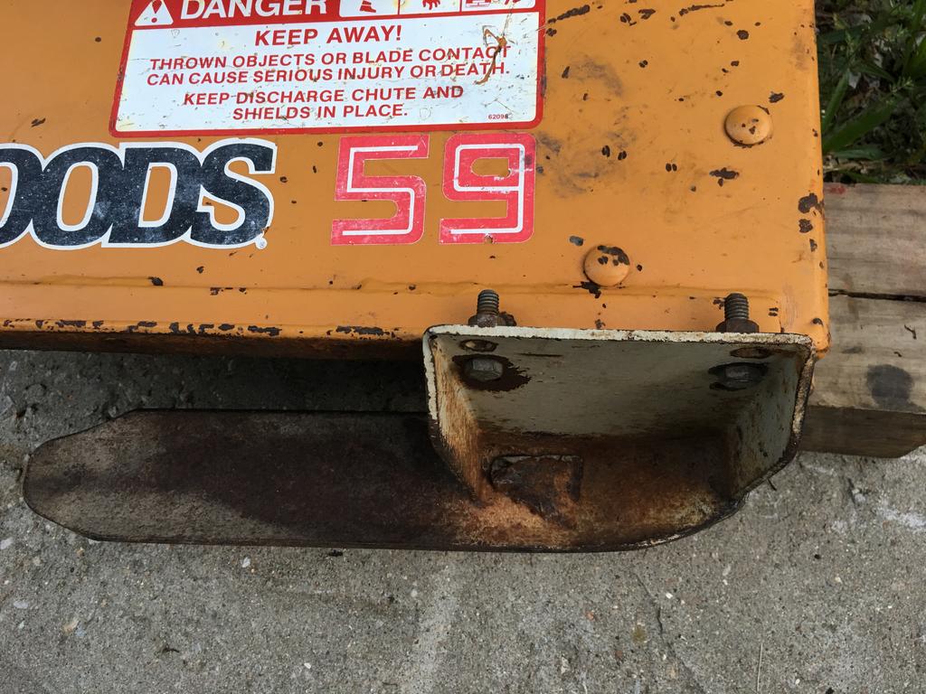

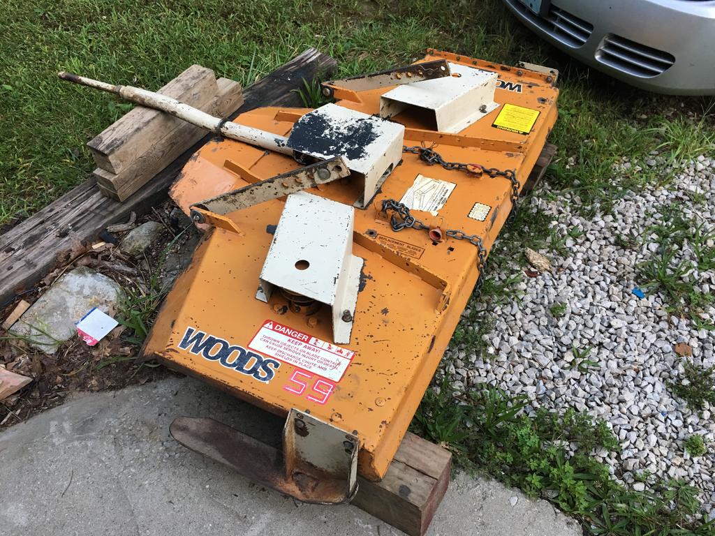

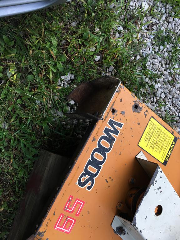

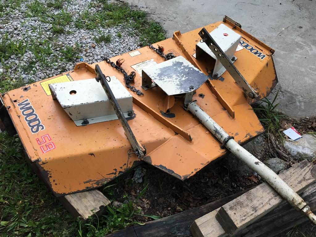

T-Mo-(Moderator) 4,690 #10 Posted August 26, 2018 Here is the Woods 59 mower after I cleaned it up a bit. As you can see, both runners aren't in the best of condition, especially the left runner, which is missing the runner part. I can get a new one for around $60, but that will have to wait. I might find one at Cub-Arama for a lot less, used. 1 Share this post Link to post Share on other sites
AMC RULES 37,250 #11 Posted August 26, 2018 Seems like, anyone with a welder around you... should be able to repair your existing runners for next to nothing. Share this post Link to post Share on other sites
T-Mo-(Moderator) 4,690 #12 Posted August 27, 2018 18 hours ago, AMC RULES said: Seems like, anyone with a welder around you... should be able to repair your existing runners for next to nothing. That's an option I'm considering also. The previous owner had a leaf spring that we believe he was going to use to repair the runners. It's about the same width and thickness of the original runners. 1 Share this post Link to post Share on other sites
AMC RULES 37,250 #13 Posted August 27, 2018 I was thinking, your one existing skid kinda looks like a leaf spring. Share this post Link to post Share on other sites
