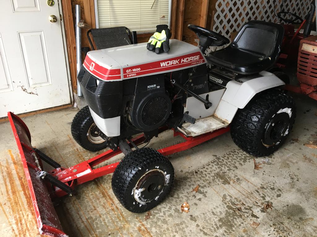

Sparky-(Admin) 23,892 #4 Posted August 2, 2018 There is no reason to stick with the exact same motor. This is my GT1600. Someone before me swapped in a Kohler Magnum 10. 3 1 Share this post Link to post Share on other sites
