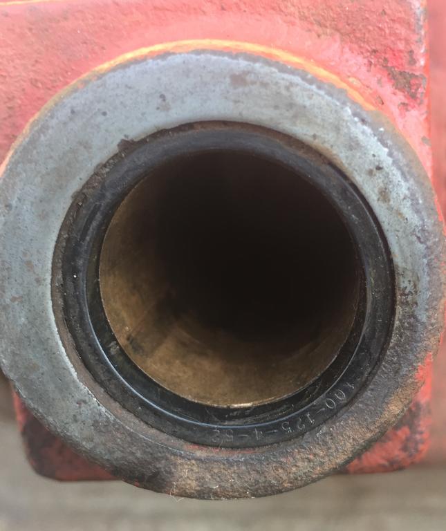

crazyhorse1056 109 #1 Posted August 1, 2018 For the people that have rebuilt the 5025 or 5053 transmission have you ever had a transmission that had the bronze bushings instead of the needle bearing for the axle shafts I have rebuilt many and they all had needle bearing in them but one I torn down this week had the bronze bearing like the three pieces transmission in the RJ and suburban 1 Share this post Link to post Share on other sites
WHX?? 52,646 #2 Posted August 1, 2018 Never... any chance someone has been in there before? 1 Share this post Link to post Share on other sites
stevasaurus 23,420 #3 Posted August 1, 2018 @crazyhorse1056 I feel very confident in stating that is not factory...and you have the only one that somebody did. Would like some pictures and the casting date on the top of that transmission...and what horse you found that in. Please I am sure you can make that work, but it is not factory. Say it ain't so. The 2 piece transmission basically got rid of all the bronze bearings...except in the cluster gear shaft. 1 Share this post Link to post Share on other sites
crazyhorse1056 109 #4 Posted August 1, 2018 I would have to say that when I was taking it apart it didn’t look like it was ever mess with but I cannot say for sure thought wheelhorse did something different like maybe thay ran out of needle bearing and just had bronze bushing so to keep building they use the bronze bushings Share this post Link to post Share on other sites
crazyhorse1056 109 #5 Posted August 1, 2018 The casting date on the cases is 1965 and it was from a 1045 tractor Share this post Link to post Share on other sites

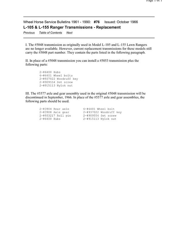

Wild Bill in VA 1,542 #9 Posted August 2, 2018 OK let me chime in here YES some of the Lawn Ranger Unidrive transmissions used a bushing at the axle ends and if I remember correctly it was early 1965 was the last they used the bushings. The ealry 1965 Lawn Ranger also used a steel flanged axle hub instead of the cast iron hub. Wild Bill in Richmond, VA 4 3 Share this post Link to post Share on other sites
WHX?? 52,646 #10 Posted August 2, 2018 (edited) Interesting Bill in the fact that a LR was meant to be a lower end tractor hence bushings instead of bearings? Perhaps one of those transmissions errantly found it's way on a 1045 on the production line? By chance did the tractor have steel hubs Crazy? Edited August 2, 2018 by WHX20 2 Share this post Link to post Share on other sites
Wild Bill in VA 1,542 #11 Posted August 2, 2018 Let's keep in mind ...... once again Wheel Horse used up lots of old parts. The bronze bushing (# 1503) was a industrial standard part and Wheel Horse purchased lots of 'em, now since the Lawn Ranger was not designed for ground engaging attachments and did not need the reliability of the Torrington needle bearings here was a way to use the supply of bushings up. Now the steel flanged hubs I mentioned were on this transmission. I have not had a Unidrive from a 1045 opened BUT since this model did use old and new styled parts (old round hood fenders with the new square hood) I would bet they might have used the #1503 bronze bushing too. Wild Bill in Richmond, VA 1 2 Share this post Link to post Share on other sites

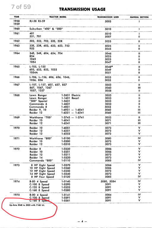

gwest_ca-(File Mod) 11,664 #12 Posted August 2, 2018 Model 5048 transmission Check item #3 https://www.partstree.com/parts/toro/mowers-lawn-garden-tractor/l-155-toro-l-155-tractor-1965/transmission-parts-list/ Garry 1 1 Share this post Link to post Share on other sites

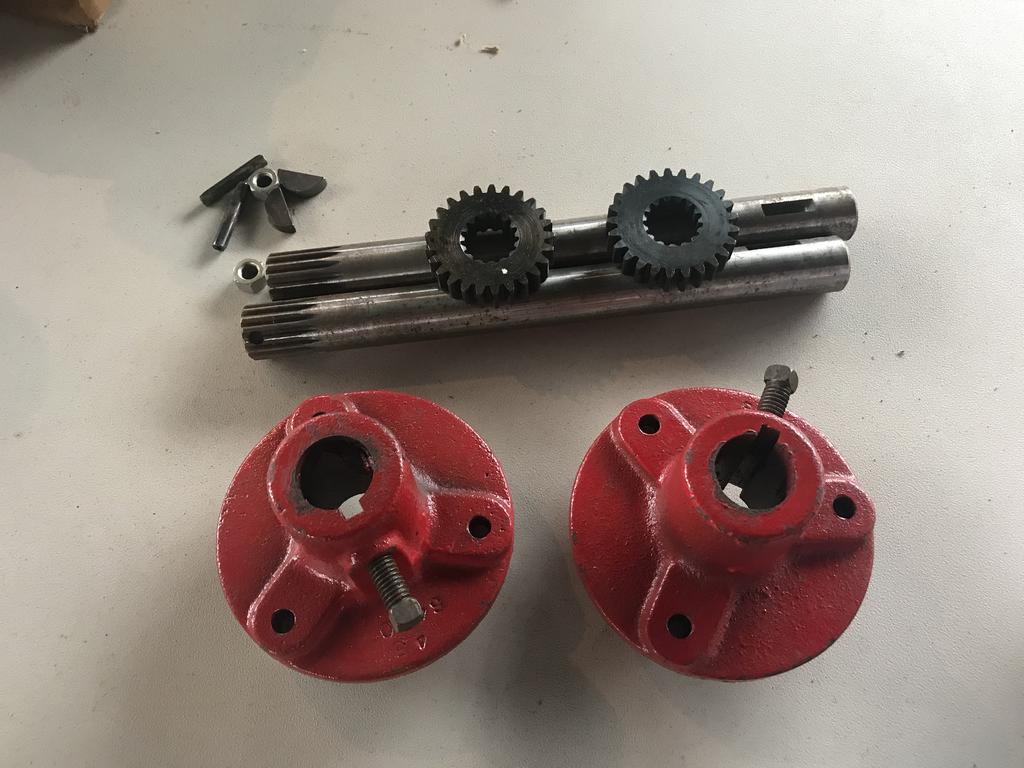

wheelhorseman 3,240 #13 Posted August 2, 2018 (edited) 4 hours ago, gwest_ca said: Model 5048 transmission Check item #3 https://www.partstree.com/parts/toro/mowers-lawn-garden-tractor/l-155-toro-l-155-tractor-1965/transmission-parts-list/ Garry Ok this kinda makes sense now Wheel horse offered a update kit for the 5048 transmission kit # 7168. Below is a picture of the #7168 kit that I took at the big show this year that my friend Alan had for sale. Also here is a picture of the wheel horse transmission manual notice at the bottom of the page where I circled it, it references the kit to update the 5048 transmission to the 5053 transmission you will notice it gives you new axles and the cast-iron hubs but begs the question where are the needle bearings? I am dying to know were the original axles soft? Did Wheelhorse receive a batch of unhardened axles and wanted to use them up and not waste any parts for the same reason we have 754s, 1045s and 1046s today so they used a bronze bushing instead of a needle bearing??? Edited August 2, 2018 by wheelhorseman 1 1 1 Share this post Link to post Share on other sites
