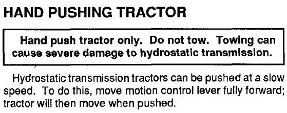

WVHillbilly520H 10,376 #6 Posted July 30, 2018 As the operators manual states as well as a decal that "used" to be on the unit..."HAND PUSH ONLY DO NOT TOW" DAMAGE MAY RESULT!...now let's say you get yourself stuck , yes you can tow it enough to get the unit out of a jam, Jeff. 2 Share this post Link to post Share on other sites

gwest_ca-(File Mod) 11,472 #12 Posted August 1, 2018 This is taken from the 1993-1996 520-H operator manual Garry 1 Share this post Link to post Share on other sites
