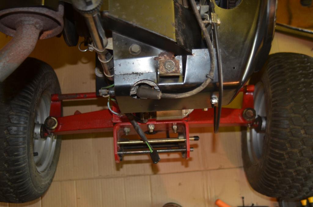

Arthur England 5 #1 Posted July 27, 2018 I have a 520H which I believe to be a 1994 model Model No73520, Serial No 4900129) and has a 1994 P220G engine. What I was wondering is when and why did the 520 get a forward swept front axle. Mine has a straight front axle which I assume is original. Cheers Arthur Share this post Link to post Share on other sites
lynnmor 8,631 #2 Posted July 27, 2018 That is NOT a 1994 front end. From 1991 up, all had swept axles and those large tie rod ends. 1 Share this post Link to post Share on other sites
MalMac 1,334 #3 Posted July 27, 2018 I believe they started putting the swept front axel on some of the 520HC's back in 89 I think. It did not have steering reduction. It was to accomodate the 60in deck. In 90 they just had the 520H and 520-8. Both had swept front axel's but still no steering reduction. They put the reduction on in 91 to help with turning the tractor because it was a bear to turn with the 60in deck and the 2 stage snow blower. I am not 100% on the HC's date. Maybe someone else will chime in here. Like said in the prior post, ether thats not the right front end or someone has switched the fender pan with the model number sticker on it. 2 Share this post Link to post Share on other sites

Arthur England 5 #6 Posted July 27, 2018 Sounds like the export situation is the answer then as the engine number goes with 1994 and has a toro badge on the fan shroud and the tractor has a toro badge on the rear of the hood. Arthur 1 Share this post Link to post Share on other sites
