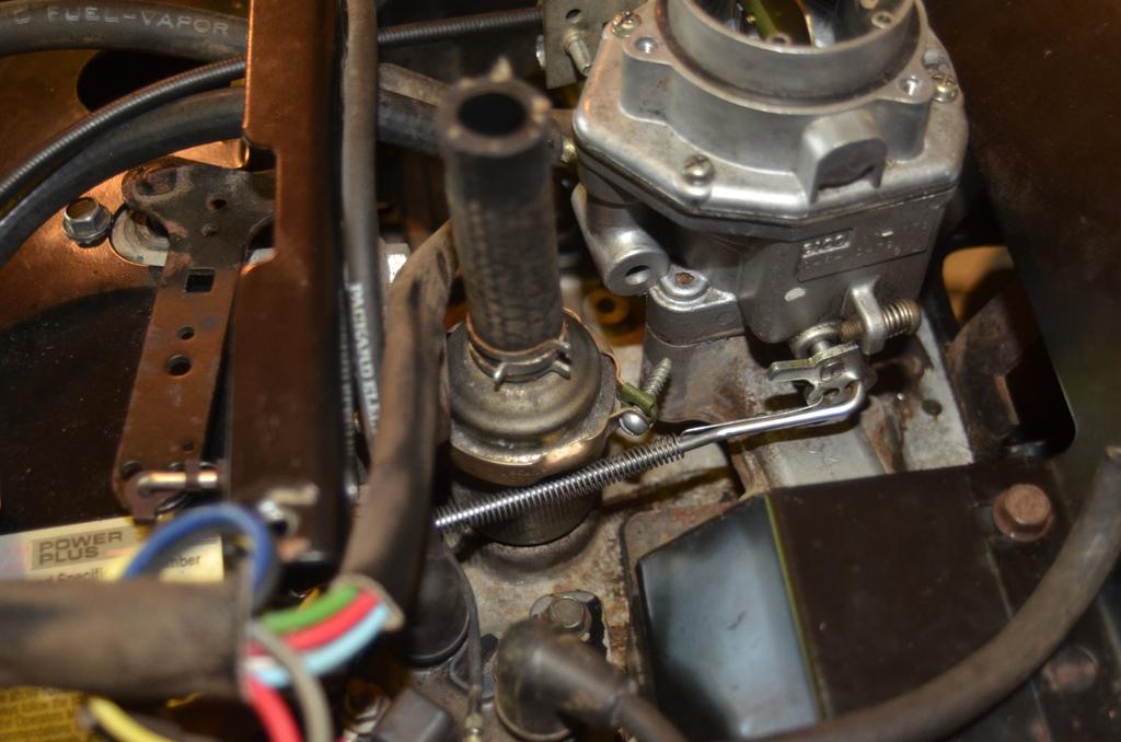

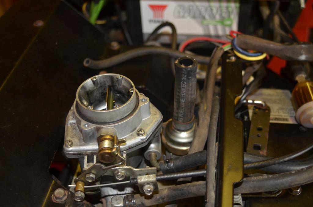

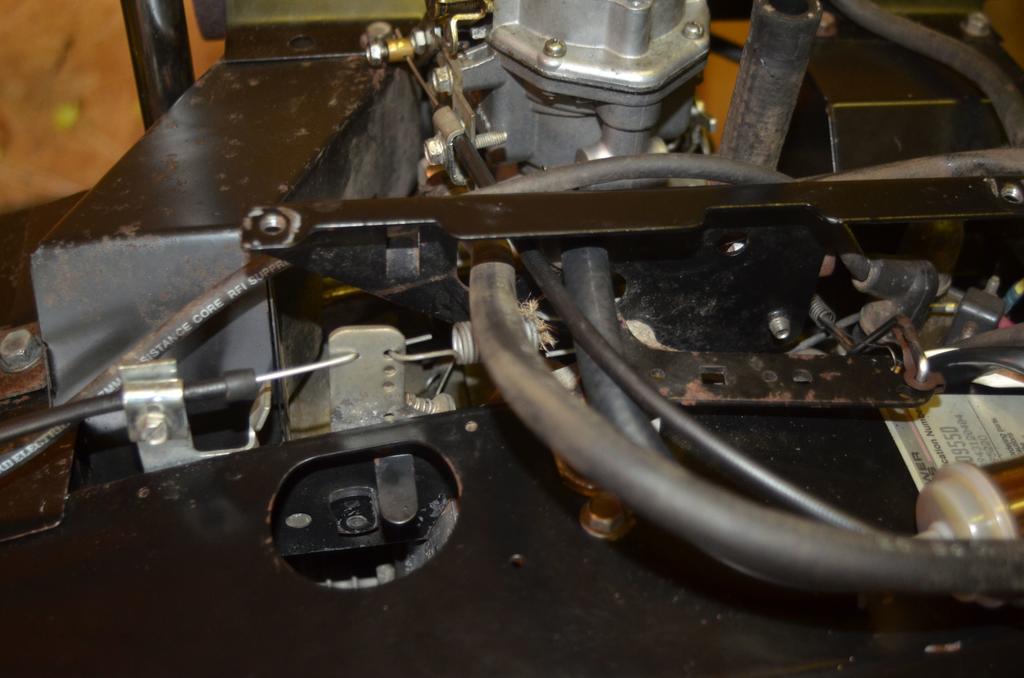

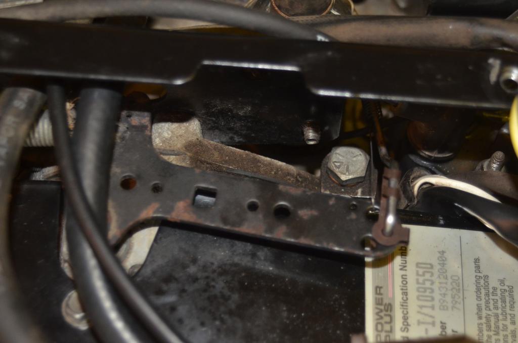

Arthur England 5 #6 Posted July 27, 2018 Photos as requested. Cheers Arthur Share this post Link to post Share on other sites
lynnmor 8,547 #7 Posted July 27, 2018 Be sure to plug the vacuum hose when running the engine. The link runs real close to the breather on these engines, be sure that it has a bit of clearance. The current position of the carb throttle is wide open, will it go against the the idle stop screw on the carb, as soon as it starts? Does the throttle go against the idle speed screw, (the one near the throttle cable end), or does the cable need adjustment? Share this post Link to post Share on other sites

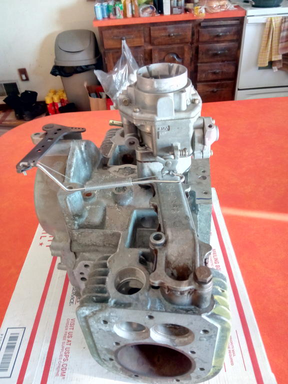

boomers_influence 106 #8 Posted July 29, 2018 arthur you DO NOT have the throttle arm correctly installed installed on the carb end. also the spring in the governor arm goes to the SMALL hole. please e/mail me and i will send a pic of the correct install. boomers_influence@yahoo.com thank you. boomer ( the used onan engine parts guy, also nOS and new ) Share this post Link to post Share on other sites
Arthur England 5 #9 Posted July 30, 2018 How I should do it! Photo courtesy of Boomer. I will make suitable adjustments and retry. It would also be nice if my motor looked like this. Mine is cleaner now that it hasn't got half the sump oil spread all over it. Cheers Arthur Share this post Link to post Share on other sites
Arthur England 5 #10 Posted August 5, 2018 Thanks to the photo I have now been able to get the carb linkage correctly set up and the engine will now idle and rev out to max revs as it previously did. The down side is that once warm it is now hunting on the governor at higher revs. Looks like it might be time to renew the fuel lines, filter and possibly re-seal the intake manifold as well as clean the carb again. Arthur Share this post Link to post Share on other sites
