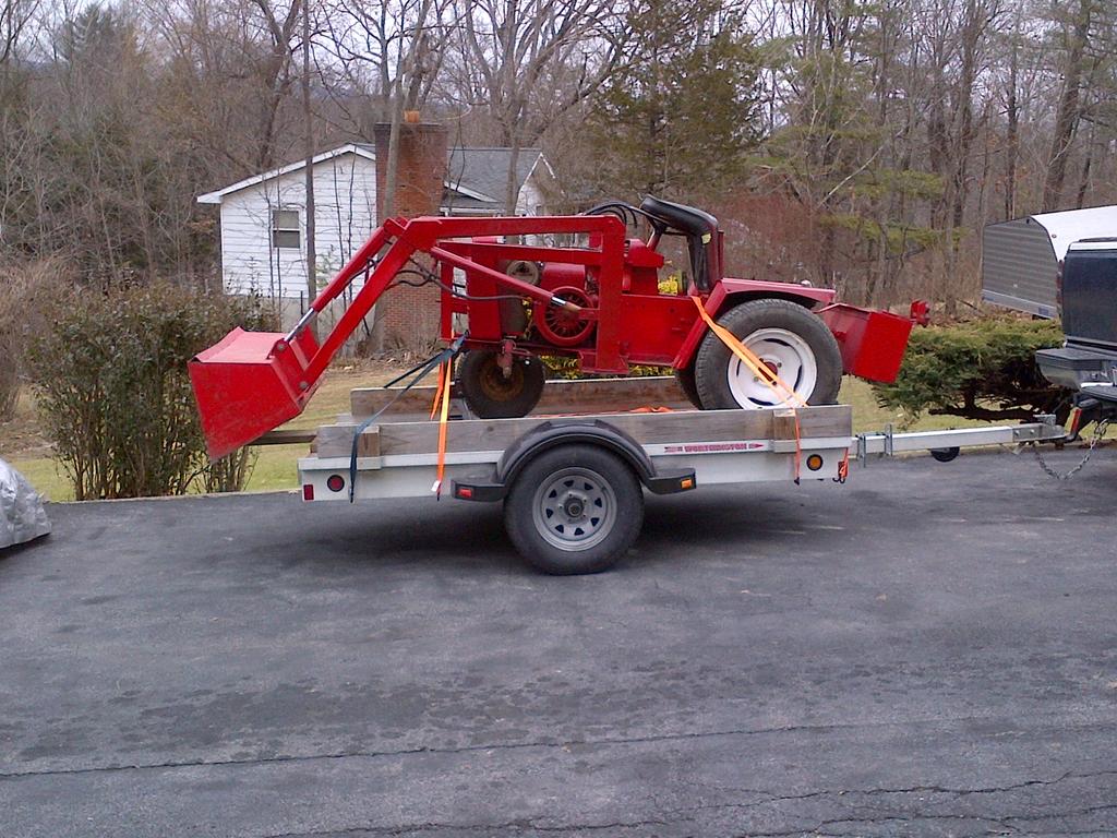

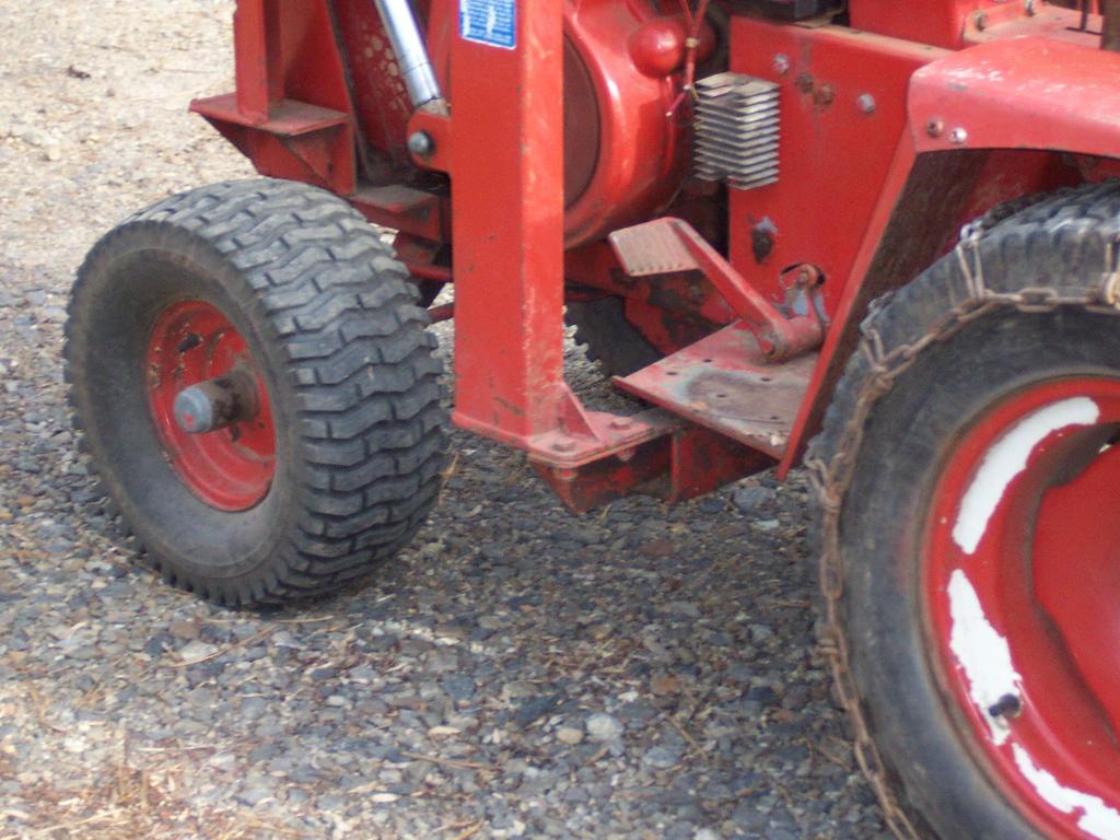

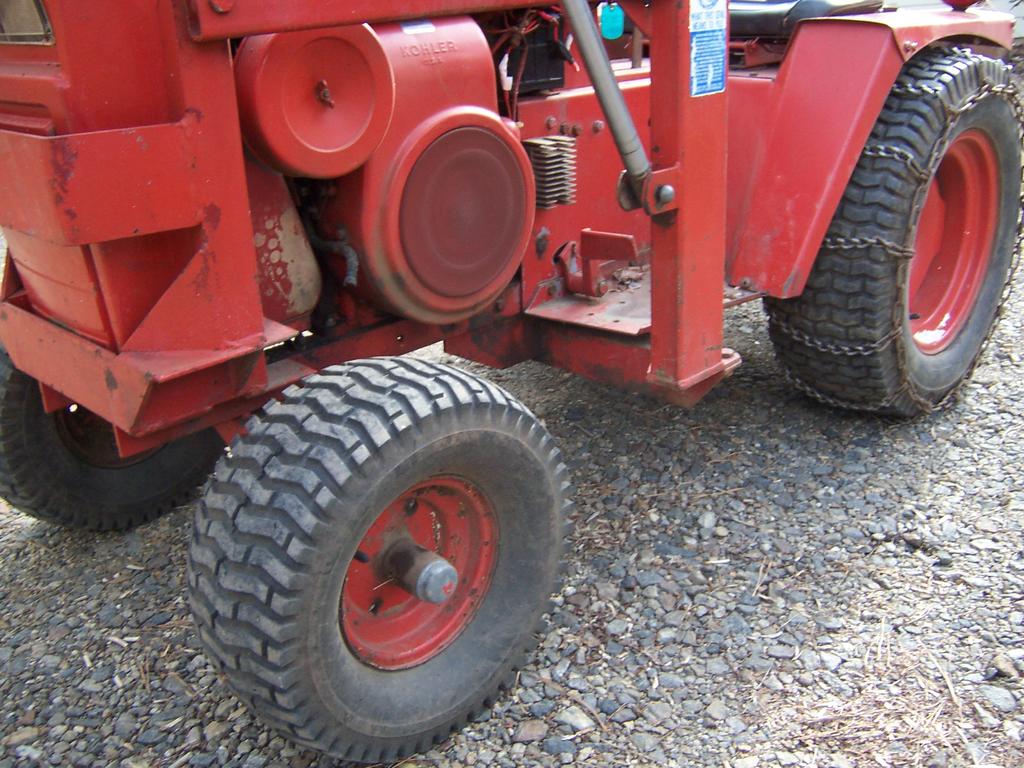

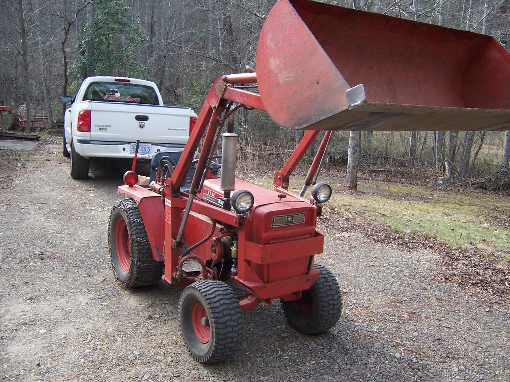

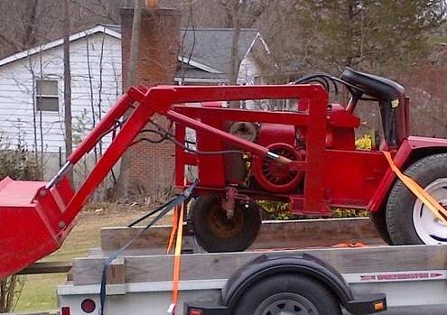

953 nut 64,141 #2 Posted July 25, 2018 Jack, I bought the GT-14 with the loader attached. It is a Johnson Workhorse had been owned and operated by a landscaping contractor prior to my purchase. The sub frame appears to be a factory built and is very stout. The sub frame is bolted directly to the frame in several positions. I have several photos of the unit and if you need more I can fix you up in a couple of days. 5 1 Share this post Link to post Share on other sites
953 nut 64,141 #3 Posted July 25, 2018 Check out this post. 2 1 Share this post Link to post Share on other sites

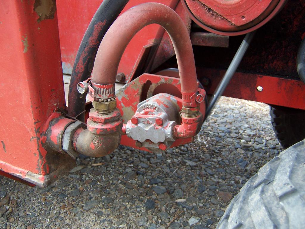

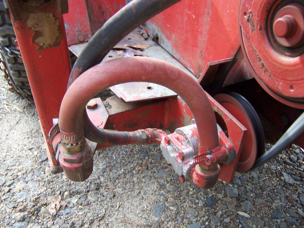

FatJackDurham 318 #4 Posted July 26, 2018 Thanks so much! Man, that front end is BRUTAL!!!!! Two questions, 1) What kind of hydro pump is that? It seems nice and compact, but I haven't seen one like it in my searches. 2) Is that the rectifier bolted on the outside of the left side? Curious why? COnvenience? Cooling? 1 Share this post Link to post Share on other sites

wallfish 19,324 #7 Posted July 26, 2018 10 hours ago, FatJackDurham said: 1) What kind of hydro pump is that? It seems nice and compact, but I haven't seen one like it in my searches. Here's the one I used for the back hoe https://www.northerntool.com/shop/tools/NTESearch?storeId=6970&ipp=48&Ntt=.517+pump This is the same one recommended by PF Engineering for their loaders and micro hoes http://www.p.f.engineering.50megs.com/ If you're building a loader, do yourself a favor and order the plans. It saves a bunch of time eliminating the search for the right parts and most of the trial and error. The design is already proven. You can easily modify the plans as you go along to suit your own particular needs and wants but all of the important information is right there. I did the micro hoe and it was the best money spent on the whole project. 1 Share this post Link to post Share on other sites

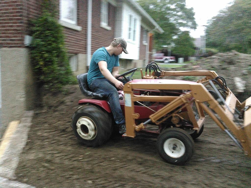

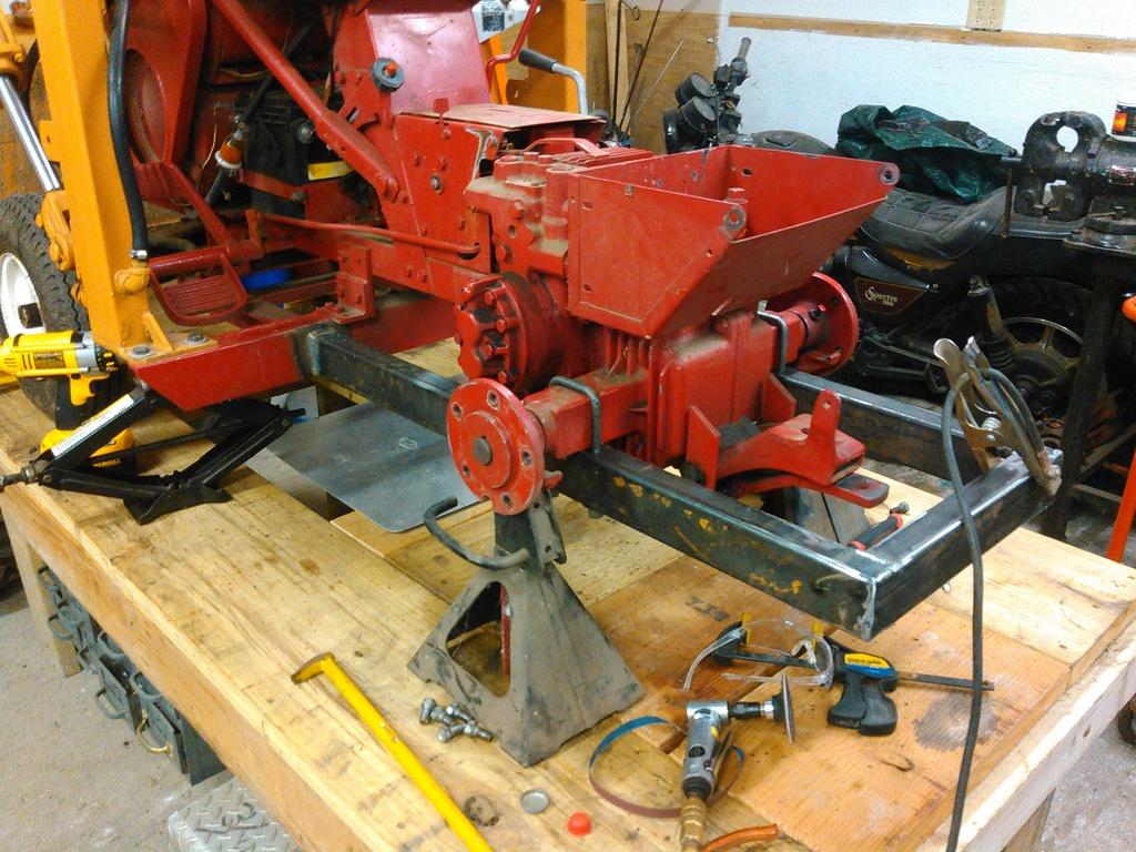

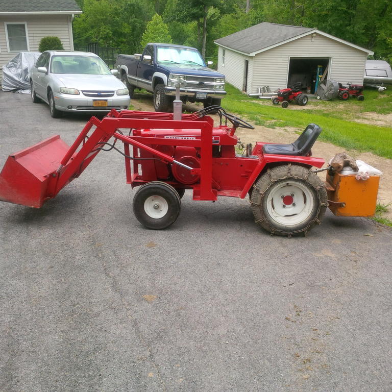

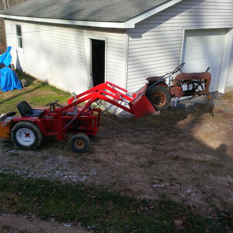

RandyLittrell 3,944 #8 Posted July 26, 2018 Jack, here are some pics of my 1277 with a johnson 10 loader. Its important to attach your loader to front, mid and rear points of your tractor. If you only connect to front and mid, your loader can twist the frame because the counter weight on the rear will try to hold the rear down and sometimes your loader will twist left or right depending on what you doing. My loader was added by the PO and really did not do that great of job. I added to the subframe to go around the rear end, but there are lots of way to do things different from how I do it. Just thought I would give you some ideas. First pic is my son in action. 4 1 Share this post Link to post Share on other sites
953 nut 64,141 #9 Posted July 26, 2018 11 hours ago, FatJackDurham said: Is that the rectifier bolted on the outside of the left side? Curious why? COnvenience? Cooling? The Rectifier is bolted to the outside because I'm old and my arthritic hands don't work well enough to bolt it to the back side of the cover without removing the side cover. Getting old ain't for sissies! 2 Share this post Link to post Share on other sites

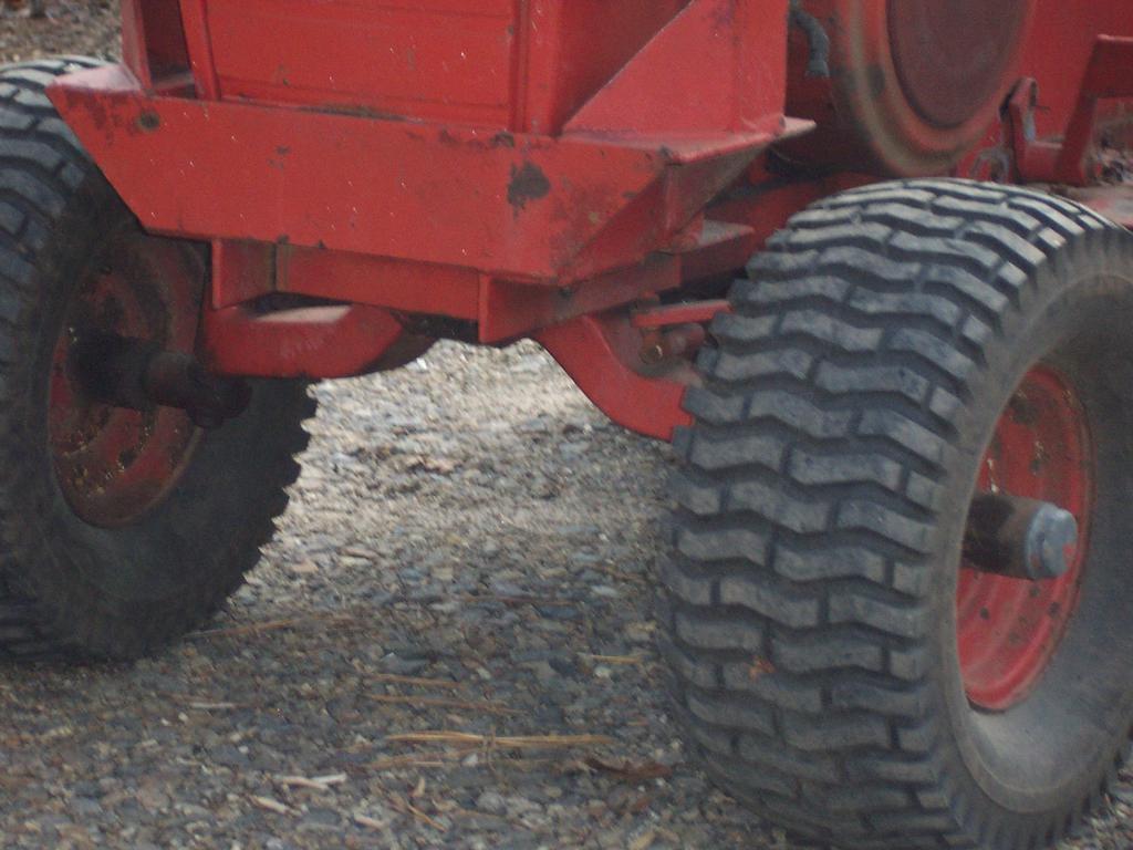

fast88pu 3,372 #10 Posted July 28, 2018 Mine is a gt 14 with the factory ark loader. It was the first horse I bought a the best investment yet. Last photo is the day I brought it home 2 2 Share this post Link to post Share on other sites
elcamino/wheelhorse 9,363 #11 Posted July 28, 2018 @fast88pu I have looked at your last picture 4 times and can't figure out what is going on with the front tires . Share this post Link to post Share on other sites
AMC RULES 37,254 #12 Posted July 28, 2018 Looks like one is missing. Share this post Link to post Share on other sites
Machineguy 877 #13 Posted July 28, 2018 (edited) Awesome little machines! Great stuff! Edited July 28, 2018 by Machineguy Share this post Link to post Share on other sites
fast88pu 3,372 #14 Posted July 28, 2018 8 hours ago, elcamino/wheelhorse said: @fast88pu I have looked at your last picture 4 times and can't figure out what is going on with the front tires . Broken spindle 1 Share this post Link to post Share on other sites
