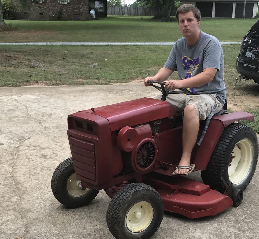

Schrumgmc 150 #1 Posted July 23, 2018 (edited) Finally bought me a GT-14 the other day for a pretty penny working on getting it running currently it sat for two years the model number is 1-7252 its a 1970 If if you know me, I’ve been looking everywhere for one Edited July 23, 2018 by Schrumgmc 2 Share this post Link to post Share on other sites

Schrumgmc 150 #18 Posted July 24, 2018 Found out why, my MB was used up on my photos i ordered a new carb for it replaced the spark plug, fuel filter and got the fuel pump to start working in full order again. Replaced the fuel line from the pump to the carb as well The paint isn’t too good in person ive looked everywhere for one of these though and finally have one 4 2 Share this post Link to post Share on other sites

Schrumgmc 150 #23 Posted July 28, 2018 It runs!!!! new carburetor and some work 1 1 Share this post Link to post Share on other sites
