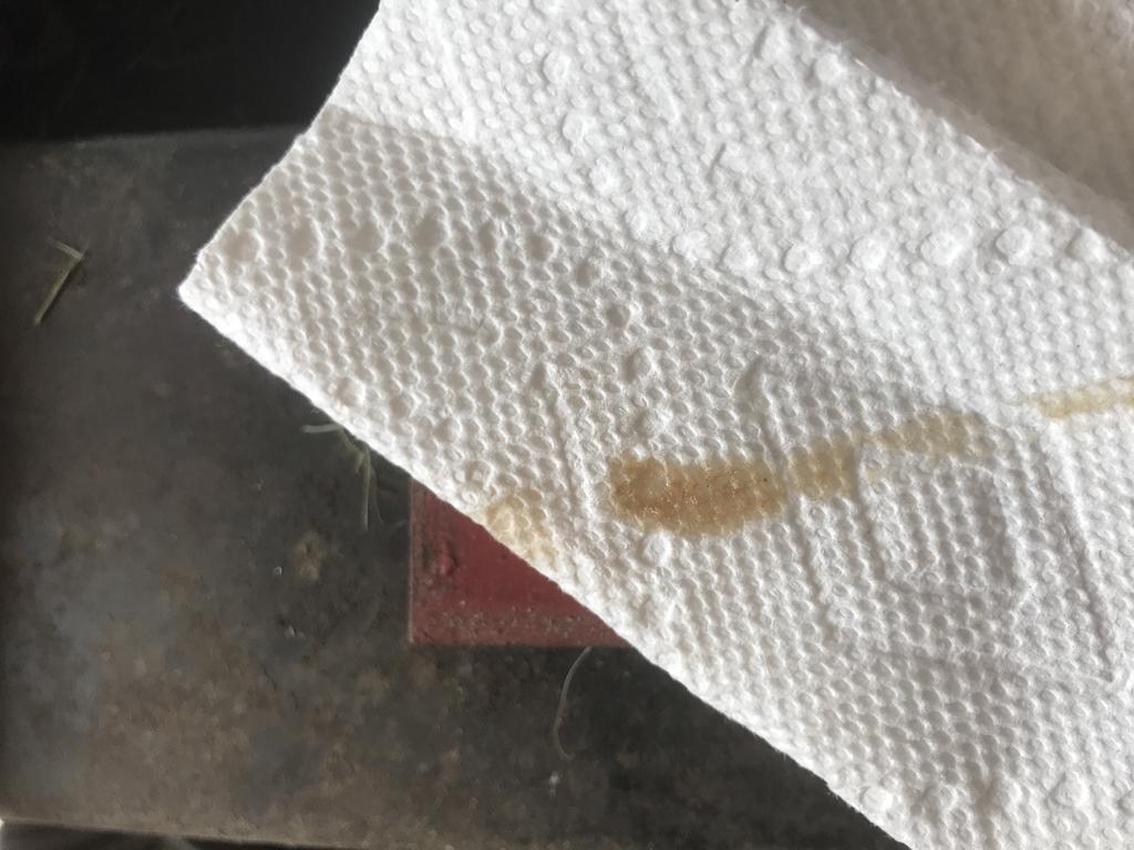

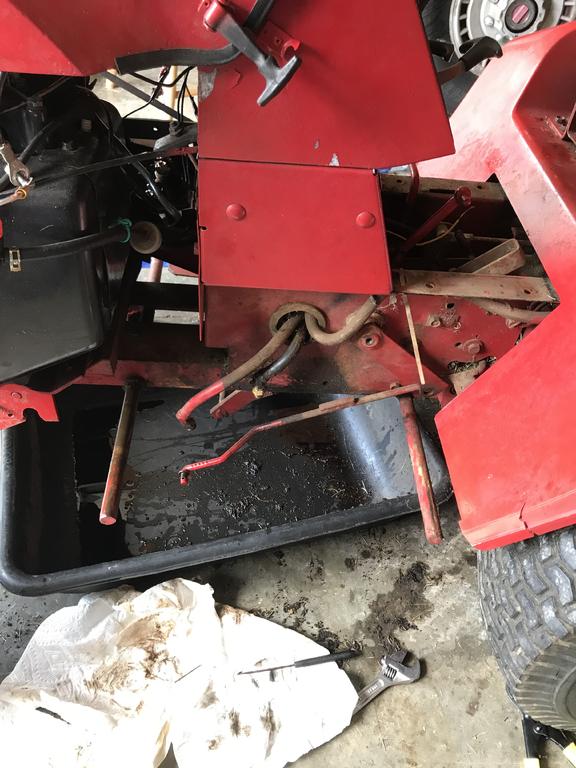

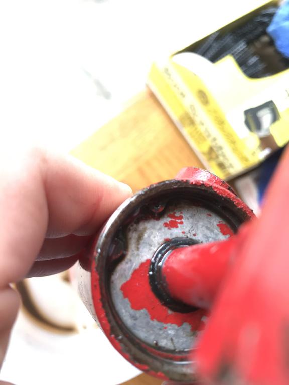

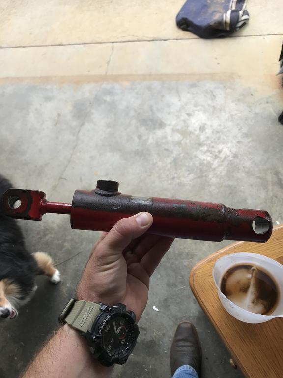

Ephillips2582 6 #1 Posted July 19, 2018 Hey folks! Recent new wheel horse owner here. Some of y’all helped in identifying my c-175 automatic, much obliged! New question! (Back story) After I acquired my c-175, I had to rebuild the starter, new relay and new battery. After mowing our two acre yard twice,one of my mule pulleys began smoking. Took them off, yep, one completely seized. Replaced both. (Side note) I noticed one day that my mower deck had settled all the way down. Wasn’t sure if that was normal, although I doubted it. Well, while waiting for the pulleys to come in I decided to replace belts and blades. With absolutely no luck getting the blade lugs to budge, I finally broke down and took the deck to my local mower shop to replace them for me. Still waiting for that. I’ve had to use my c-175 for miscellaneous uses around our 6 acre property. After parking it last weekend, I came out to a small leak under her. I’ve never had a leak that I’ve noticed before. Turns out it was the hydraulic under the left foot rest. Decided not to chance it and bought a deal kit from wheelhorsepartsandmore.com, it’ll be here in a day or two. I already pulled out the hydraulic, which has the snap ring. Is seemed to be filled with transmission fluid? I assume that’s running off the transmissions fluid? Looking for clarification so I can be ready as soon as the seals come in. Thanks in advance! Share this post Link to post Share on other sites
pfrederi 18,970 #2 Posted July 19, 2018 It shares fluid with the transaxle and hydro system. By the time C175 came along using motor oil 10w-30 or 10w-40 was the norm in the hydro Is your fluid yellow gold colored? Older units used Automatic Tran fluid (Dexron) it is Cherry red. 1 Share this post Link to post Share on other sites
953 nut 62,162 #3 Posted July 19, 2018 Hard to say what a previous owner may have done. As Paul said if the fluid is RED it is ATF. Last year I bought a 1987 418-C and when time came to service it I bought five quarts of 10-W-30 in anticipation of refilling the Eaton 1100. Pulled the plug and son of a gun has ATF in it. Works fine so I went back with ATF. Unless you are doing a complete tear-down you should stick with what is there now. Remember, in hydraulics 1 Share this post Link to post Share on other sites
Ephillips2582 6 #4 Posted July 19, 2018 Yellow gold on the dip stick. And nice and clean looking. I plan on draining when I get the hydraulic seals replaced. I’d rather not do what 953 nut did and buy the wrong stuff. Lol 1 Share this post Link to post Share on other sites
953 nut 62,162 #5 Posted July 19, 2018 Your filter is a NAPA 1410. One more tip, when you go to fill the transmission it will need a vent path or the oil will probably burp through the dip stick tube. remove one of the seat support bolts as a vent, once you have about 3 1/2 quarts in the oil will be apt to come out of the bolt hole so you will have to put the bolt back in and fill slowly. 1 Share this post Link to post Share on other sites
