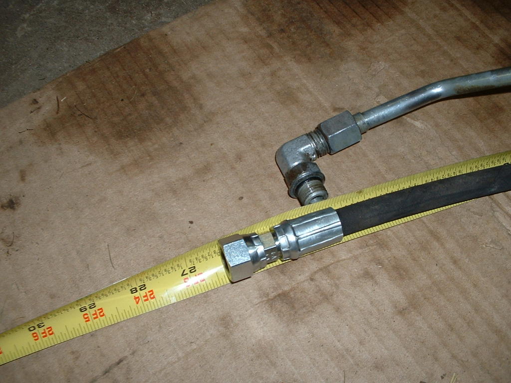

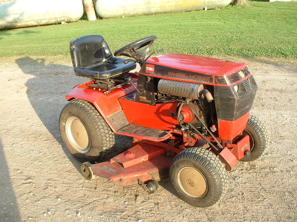

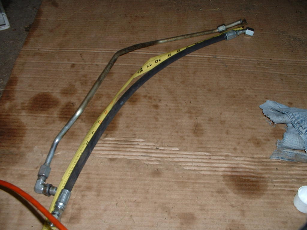

Redline69 27 #17 Posted September 21, 2018 OK, I got the machine fixed, but am finally getting around to getting the repair posted. Cleat gave me the best advice, which was to work by removing the panel below, but in front of the battery. I didn't have to fully take it out, but just get enough room to maneuver. Had a hose made up at the local NAPA. Added a picture of it. We used 1/4" hydraulic hose rather than 3/8" for easier maneuvering. The ends are 3/8" JIC (37degree). We put a 45 degree on the end going to the lift valve. I'm glad I used 1/4" line because 3/8" line would've been a bear to get in through the opening going to the pump. Once I installed it and topped up the fluid, it worked like a charm. Here is the old 412-H sorta cleaned up. Just in her working clothes. 1760 hrs on it. Thanks for the help fellas. Frank 1 Share this post Link to post Share on other sites
cleat 8,441 #18 Posted September 22, 2018 Good looking tractor and also has the 48" deck. Best deck out there. Cleat 1 Share this post Link to post Share on other sites
Redline69 27 #19 Posted September 22, 2018 Thanks Cleat. It's no 520, but still cuts like a knife with that deck! Share this post Link to post Share on other sites
1995 520H+96+97 938 #20 Posted October 14, 2018 Could you post a picture of the line, fitting that was leaking? Was it cracked, the fitting or the line? Share this post Link to post Share on other sites
Redline69 27 #21 Posted October 14, 2018 Thought I posted it. There was a crack in the flare. Very fine, but a crack none the less. Share this post Link to post Share on other sites
