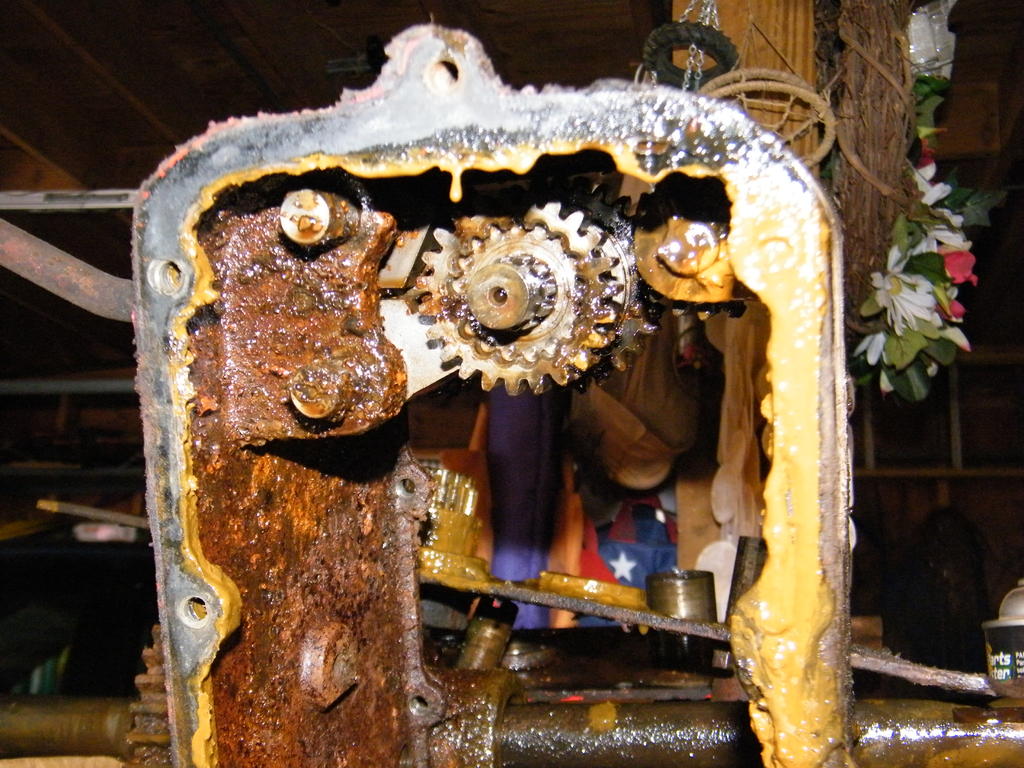

stevasaurus 23,506 #8 Posted July 18, 2018 OK...I would open up the trans with what you said. The shift forks in your trans sit up high in the case...even if they were not in the water, those shift forks could rust because of condensation. I'm sure your trans is savable. Usually, a wire wheel will clean up the shafts and gears, light sand blasting works and electrolysis with the wire wheel or sand blasting will do things that are really rusted. I was able to save this one with electrolysis. This one would not shift either. I doubt yours is this bad, but it does show why you maybe can't shift into gear. Do not force the shifter. You might try...drain the oil...fill the trans to the top with diesel (put a pan under the trans to catch any drips)...let set a few days. Gently try to shift once in a while. I would still open it and clean it out. 1 Share this post Link to post Share on other sites
