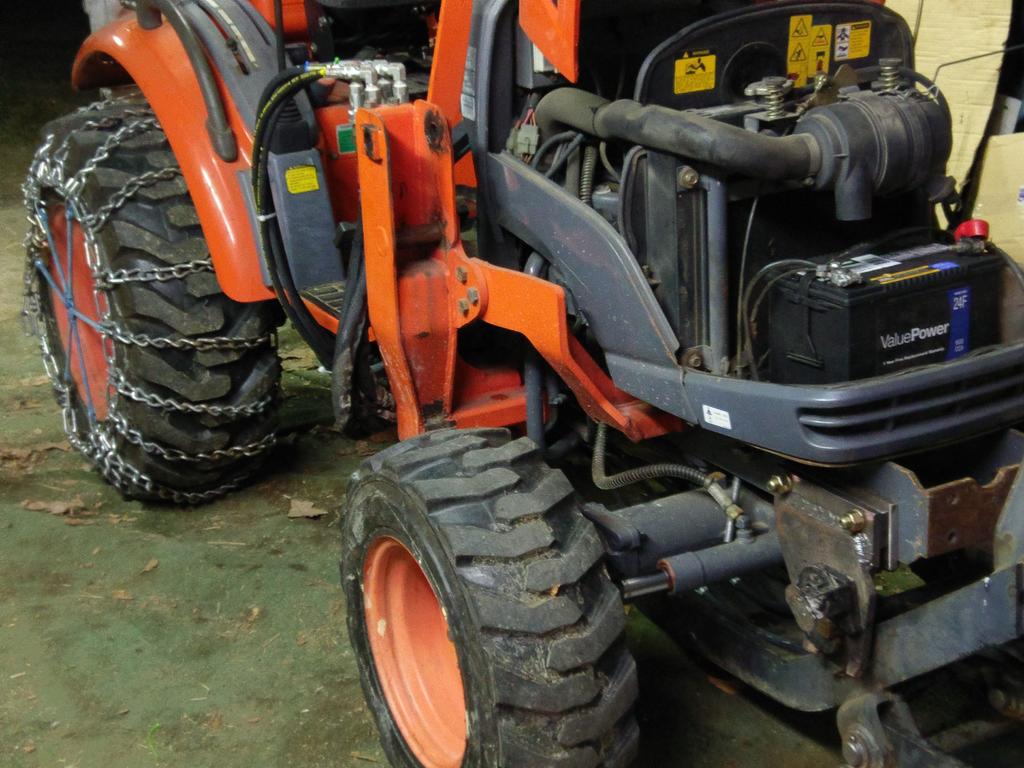

WVHillbilly520H 10,378 #14 Posted July 14, 2018 15 minutes ago, squonk said: No such thing as a $ 39.99 car battery anymore. $50 is the cheapest I can find. You can get "remanufactured" automotive batteries for $30...had one in the Kioti don't know how long it was in it before I bought it but it lasted 4 years before I just couldn't take the posts constantly corroding if after cleaning and treating multiple times so I bought one of Wal-Mart's economy group "75" batteries that I also have in my street rod. Share this post Link to post Share on other sites
