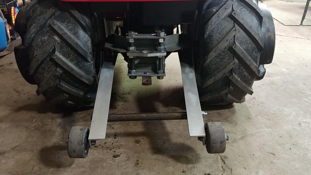

huey 7 #1 Posted July 11, 2018 Pulling a little bit locally its a stock tractor pull with a transfer sled. I have a c-120 with a K-341 (16hp) when pulling it spins out in 2nd and 3rd it looses power. What i'm wondering how big of engine pulley can i go on the engine and still use the stock belt gaurd as i could use a little more speed also running 23x8.50x12 ag tires. Share this post Link to post Share on other sites
RandyLittrell 3,944 #2 Posted July 11, 2018 Larger tires would be a good start, and do you have as much weight on it as they allow? Randy Share this post Link to post Share on other sites
huey 7 #3 Posted July 11, 2018 (edited) tractor is in a stock pull so can't go bigger on the tires thats why i was hoping on changing the engine pulley! also have it weighted just under the limit for the class Edited July 11, 2018 by huey Share this post Link to post Share on other sites

Ralph S 342 #7 Posted April 9, 2019 On 7/10/2018 at 11:22 PM, huey said: tractor is in a stock pull so can't go bigger on the tires thats why i was hoping on changing the engine pulley! also have it weighted just under the limit for the class you can go with 23 x 10.50 - 12 and still be stock. Share this post Link to post Share on other sites
