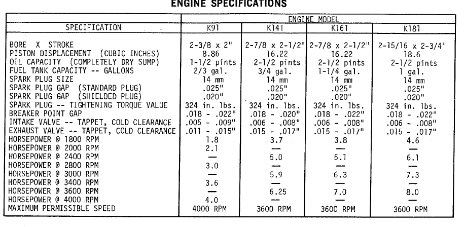

857 14 #3 Posted July 15, 2018 Thank you very much Garry. Most of the information I needed I found, But I couldn't find how far the exhaust valve should lift on the second compression stroke, the reason I ask is before I found the correct valve stem cap which should be .006 I had reground the valve that every one I spoke to said the gap should be .015 which I did, but is WRONG so I am getting less lift by .010 how important is the gap on the lift? I hope some one can help. Thank you. Terry Share this post Link to post Share on other sites
rmaynard 16,700 #4 Posted July 15, 2018 According to all the info that I have, the exhaust gap is .015. I have rebuilt K-181's, and K-161's and that is the gap that I use, per the Kohler manual. You must be looking at the intake spec. Share this post Link to post Share on other sites
857 14 #5 Posted July 16, 2018 Thank you maynard for your reply. I think I was looking at the valve to guide clearance. Rgds Terry Share this post Link to post Share on other sites
