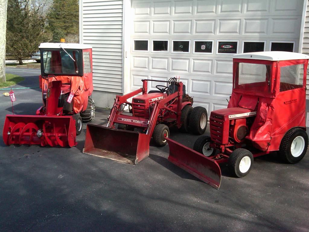

c-series don 11,235 #7 Posted July 6, 2018 I have a two-stage snowblower on a 417-A and love it. It's my dedicated snowblower tractor, with cab, lights and heat. Ed is right about the heat. I tapped into the shrouds that cover the cooling fins and ran some 1/2" heater hose into the cab, then to a piece of 3/4" pvc pipe with 1/8" holes drilled 1" apart. That pipe is just below the windshield and it helps with defrosting. 3 Share this post Link to post Share on other sites
roadapples 6,986 #8 Posted July 6, 2018 Would like to see that setup up close...... Share this post Link to post Share on other sites
