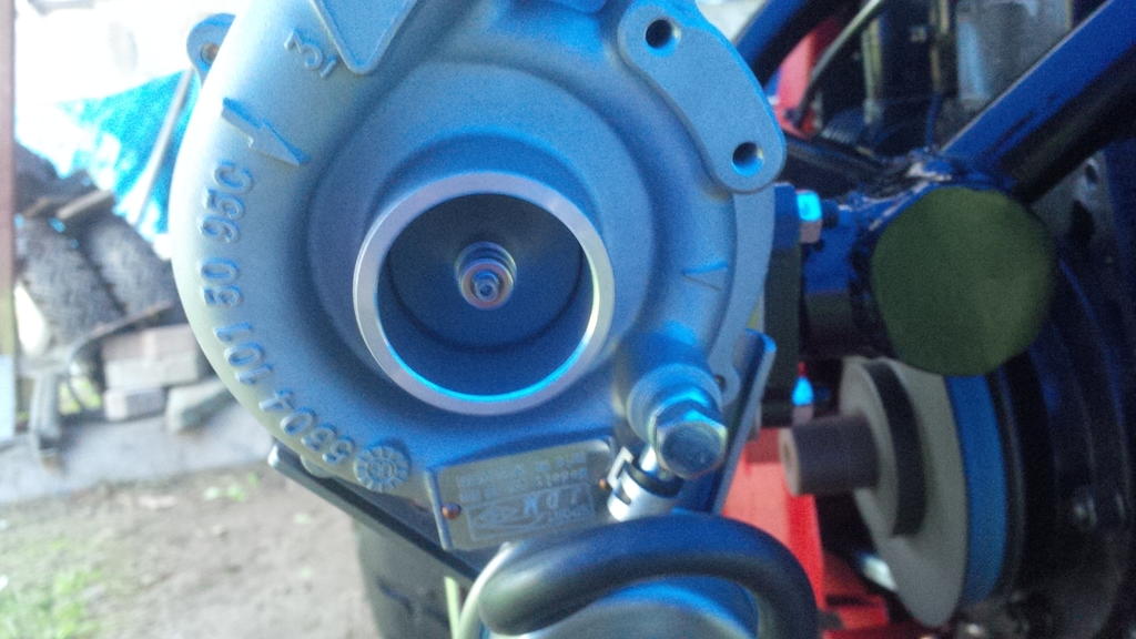

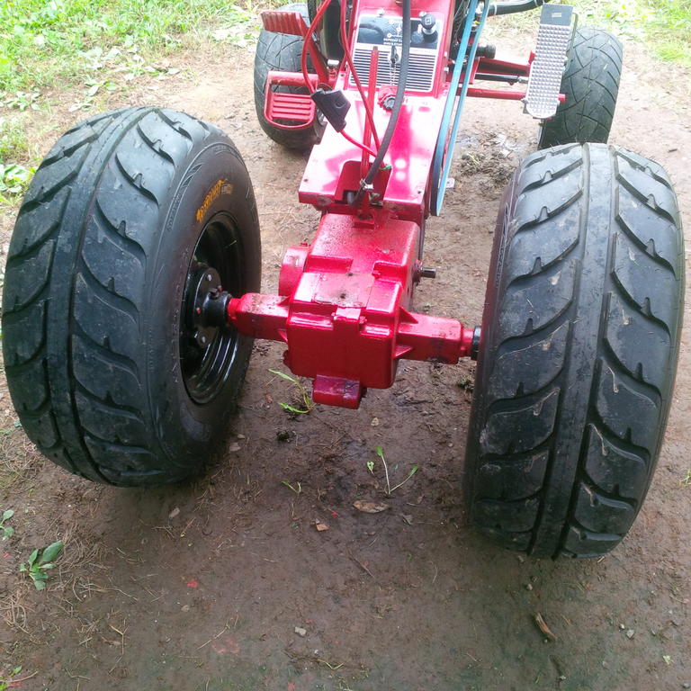

fast88pu 3,394 #126 Posted September 12, 2018 9 minutes ago, stevebo said: or speed ....lol Ask bo about speed lol Share this post Link to post Share on other sites

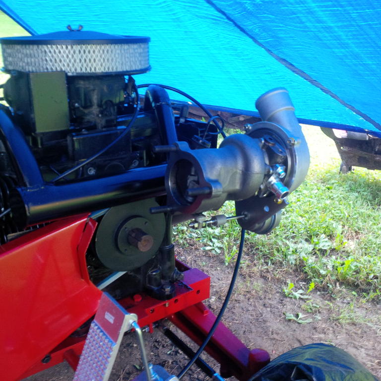

Pullstart 70,943 #127 Posted September 12, 2018 Awesome pics, gotta see the turbo finished! Is it self oiling, or do you have to run a supply and drain? Share this post Link to post Share on other sites
fast88pu 3,394 #128 Posted September 12, 2018 18 minutes ago, pullstart said: Awesome pics, gotta see the turbo finished! Is it self oiling, or do you have to run a supply and drain? I have to run the supply and drain lines for it 2 Share this post Link to post Share on other sites

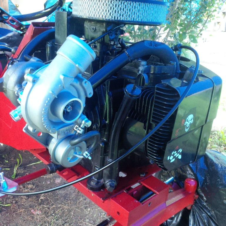

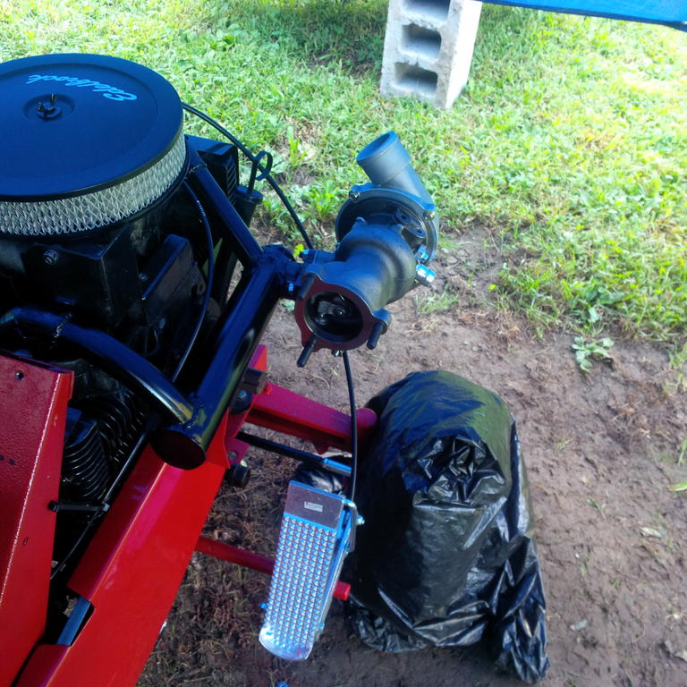

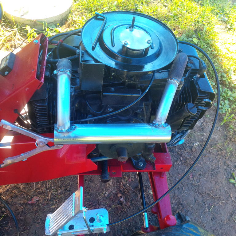

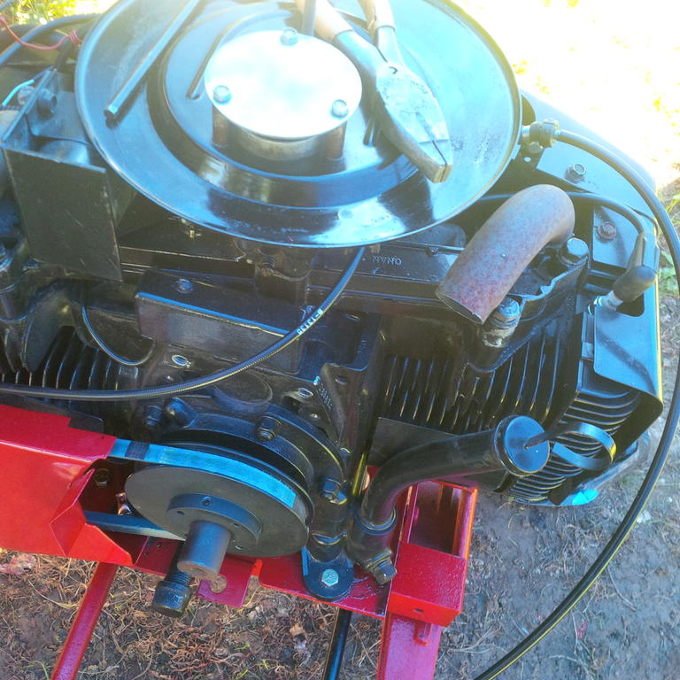

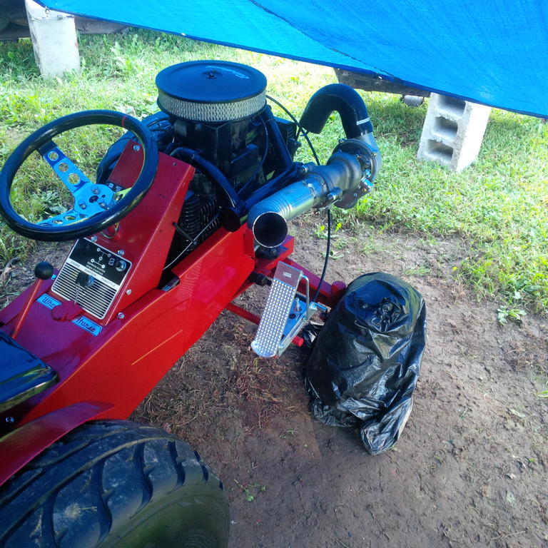

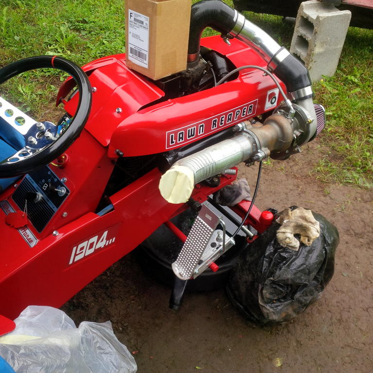

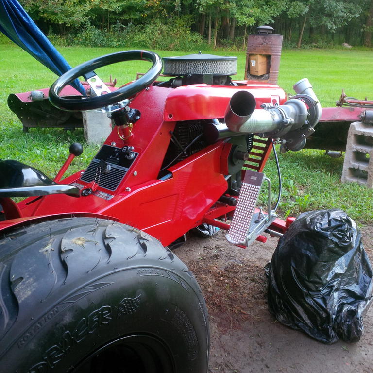

fast88pu 3,394 #129 Posted September 13, 2018 I'm starting on the turbo Exhaust manifold and plumbing. For now I got the hot side flanges welded on. 2 Share this post Link to post Share on other sites
19richie66 17,930 #130 Posted September 13, 2018 Gonna fit that under the hood are ya? looking great! 1 Share this post Link to post Share on other sites

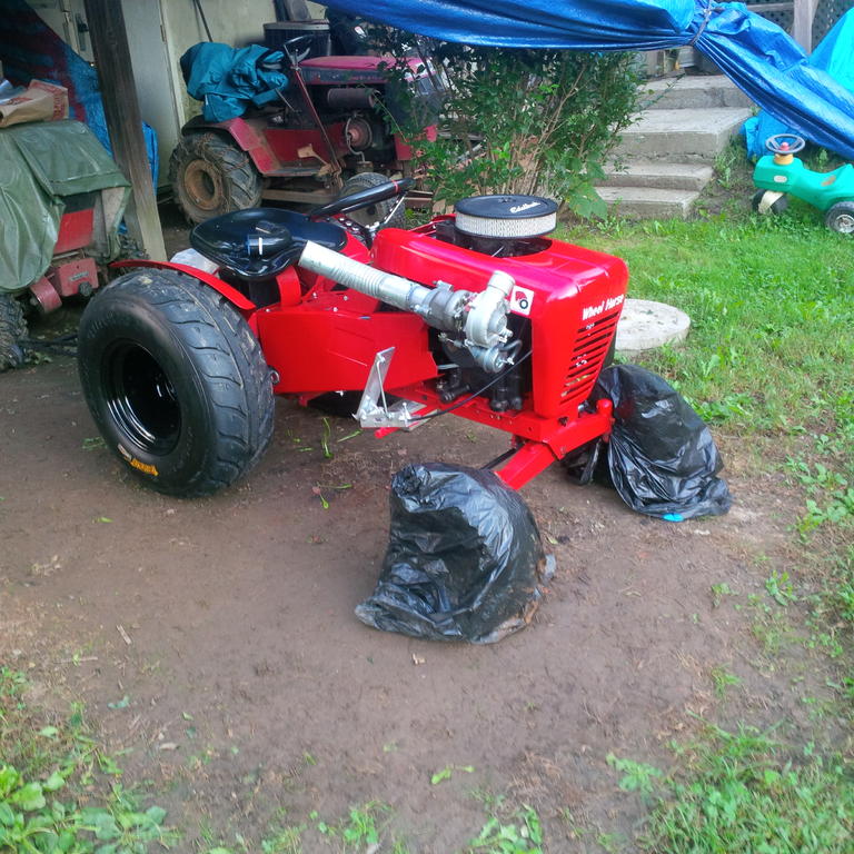

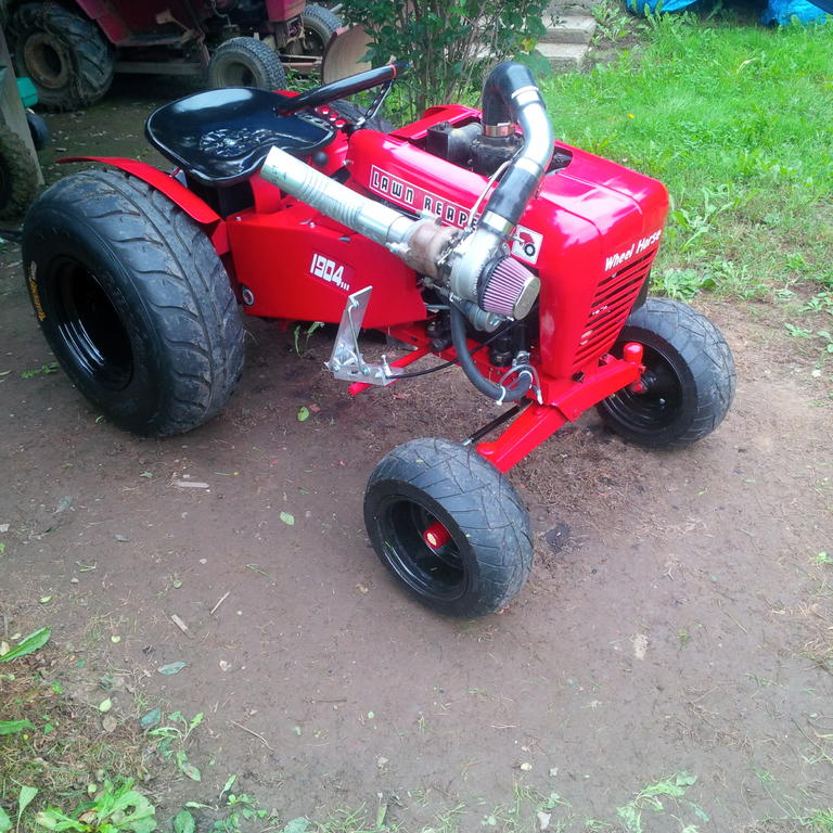

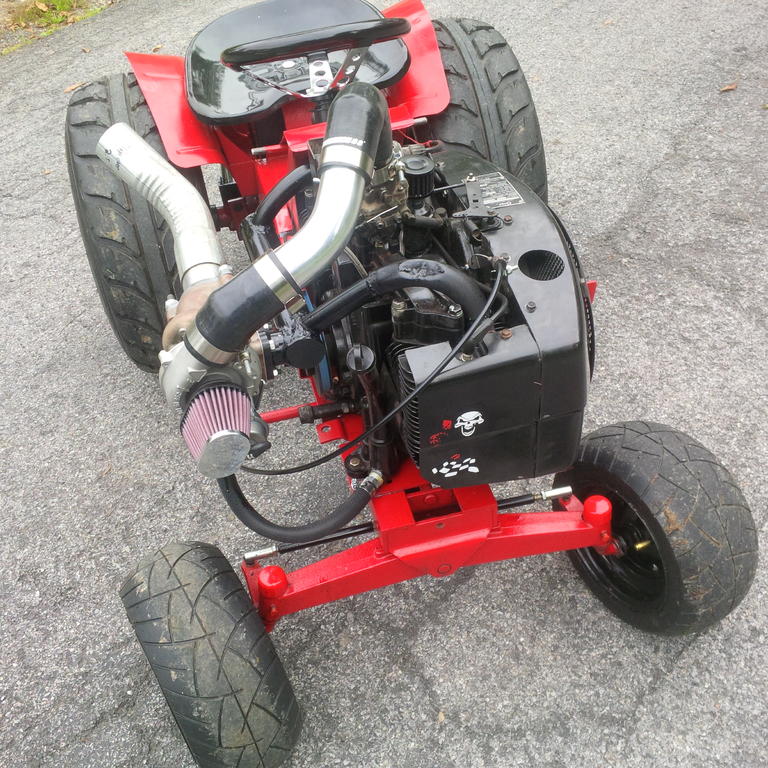

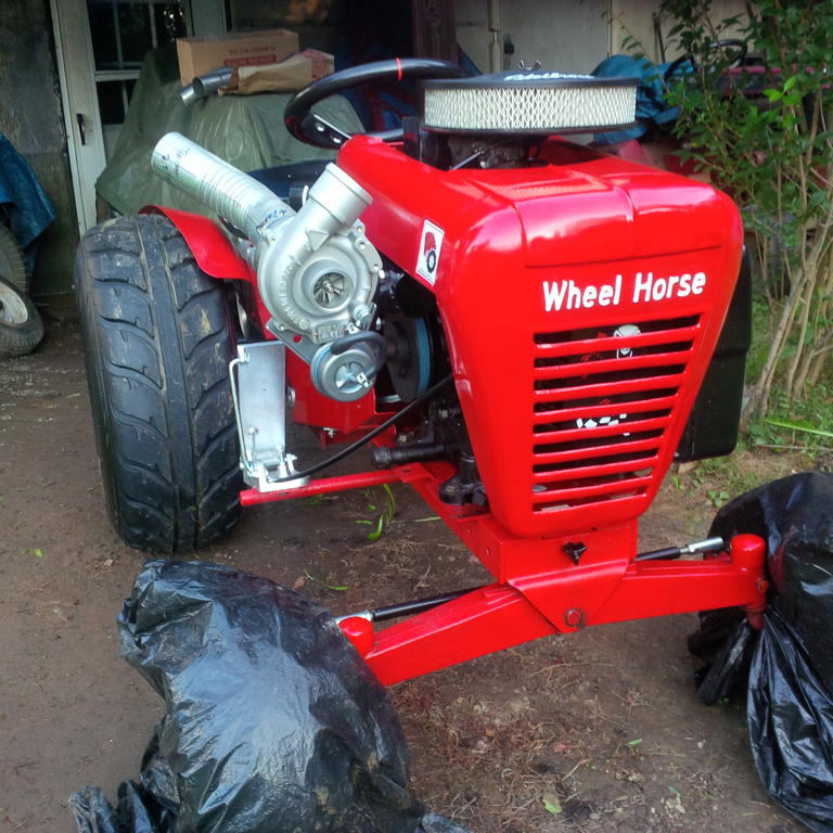

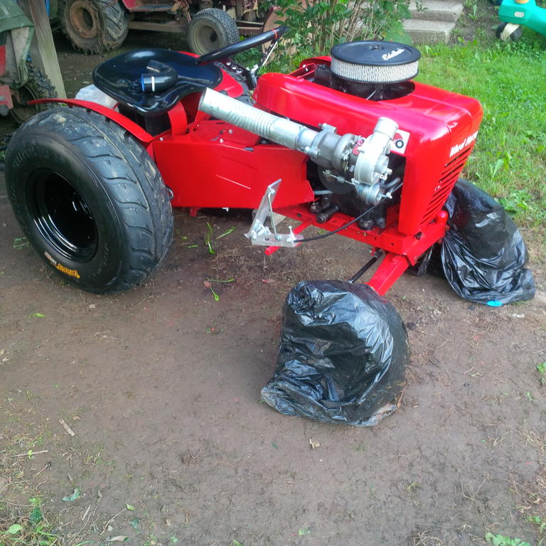

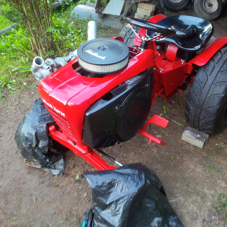

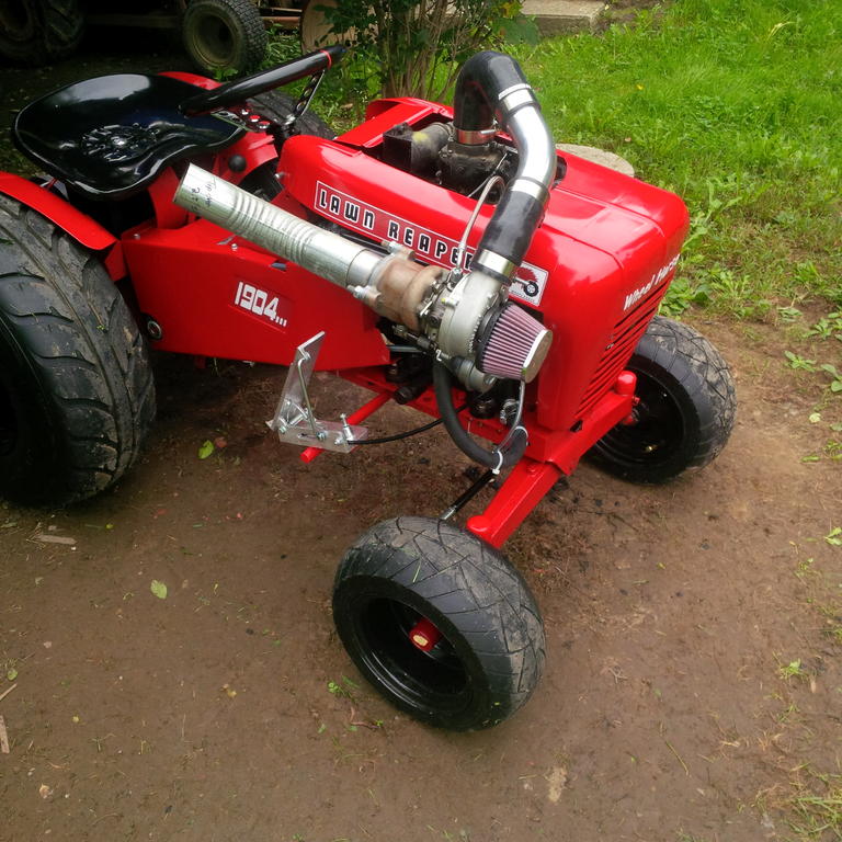

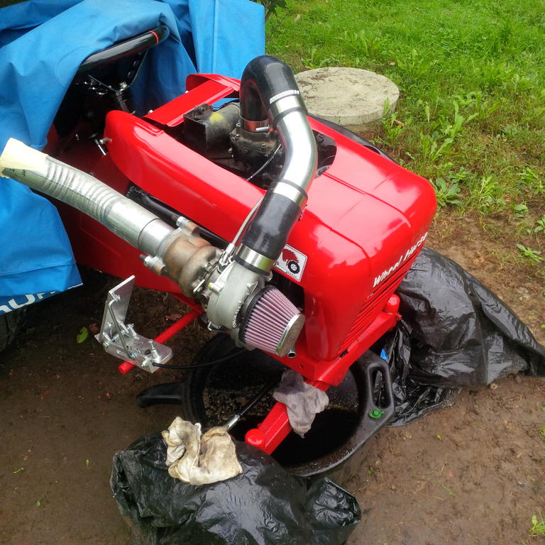

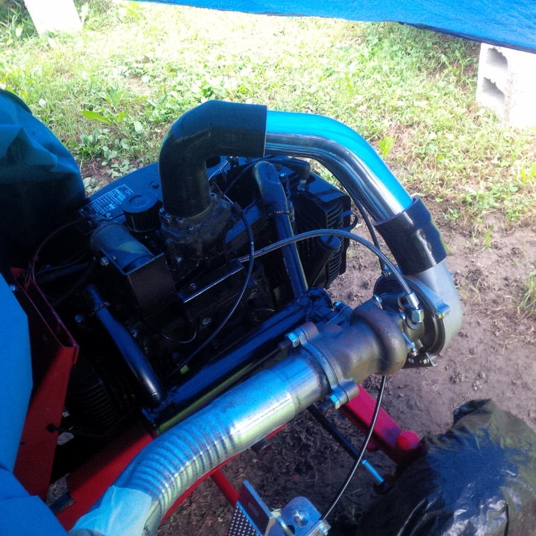

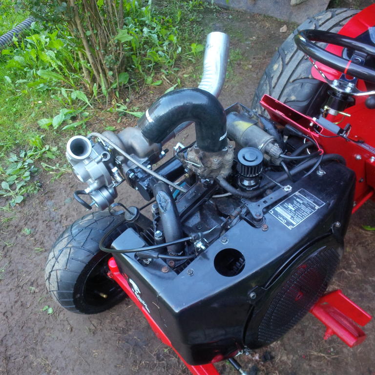

fast88pu 3,394 #131 Posted September 16, 2018 I started the turbocharger install this afternoon. I made the exhaust manifold and mounted the turbo. Next will be the charge plumbing and oil lines and exhaust. It sounds good now 4 5 Share this post Link to post Share on other sites

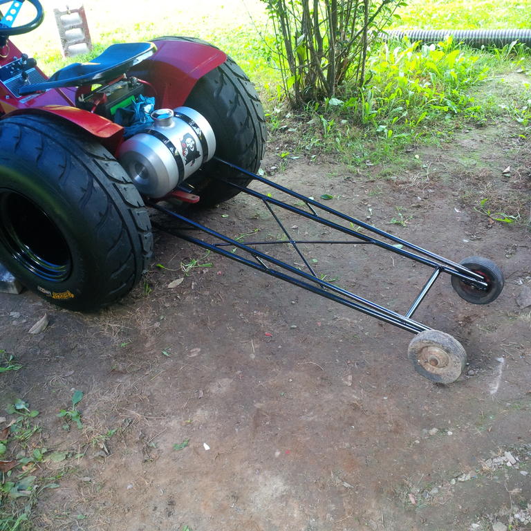

AMC RULES 37,259 #132 Posted September 16, 2018 Umm...better lower them wheelie bars Kyle. 1 Share this post Link to post Share on other sites
fast88pu 3,394 #133 Posted September 16, 2018 17 minutes ago, AMC RULES said: Umm...better lower them wheelie bars Kyle. Should be strong enough. It scoots now 2 Share this post Link to post Share on other sites
Pullstart 70,943 #134 Posted September 16, 2018 “Oooo, that ain’t no Putt Putt” - Mrs. Pullstart I think she likes the turbo! 1 1 Share this post Link to post Share on other sites

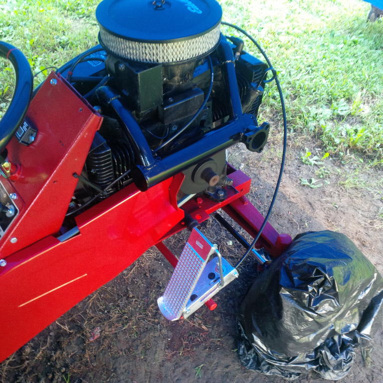

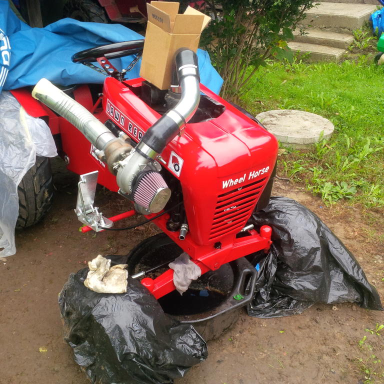

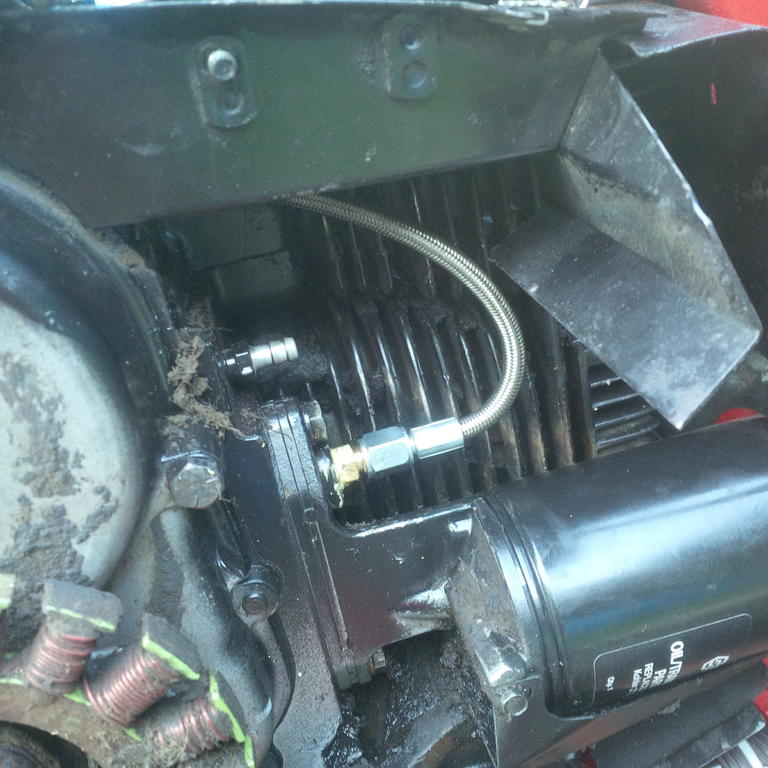

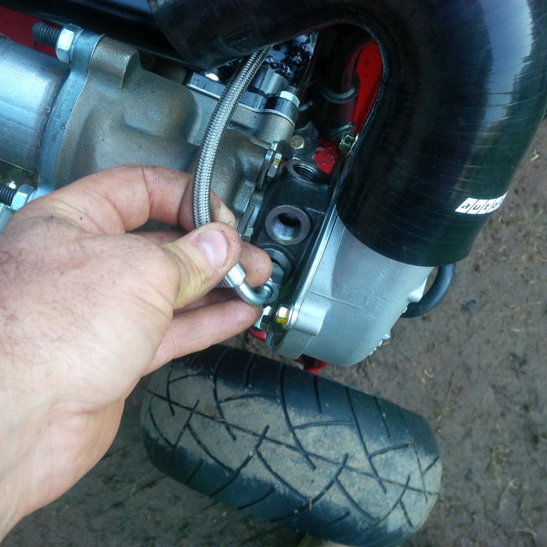

fast88pu 3,394 #135 Posted September 17, 2018 A little more work today. Started doing the oil lines and removed the air filter housing. 3 2 Share this post Link to post Share on other sites
19richie66 17,930 #136 Posted September 17, 2018 Are you going to put the carb in a pressurized box. Not all up on the turbo stuff but heard with a carb it should be in one. Share this post Link to post Share on other sites
fast88pu 3,394 #137 Posted September 17, 2018 15 hours ago, 19richie66 said: Are you going to put the carb in a pressurized box. Not all up on the turbo stuff but heard with a carb it should be in one. I've heard mixed things. I am not putting it in a box 1 Share this post Link to post Share on other sites
19richie66 17,930 #138 Posted September 17, 2018 I’ll be interested in how it works. Looks fantastic! 1 Share this post Link to post Share on other sites
Aldon 4,832 #139 Posted September 18, 2018 Looks better without the garbage bags on front wheels. Seriously though....it’s awesome. 2 Share this post Link to post Share on other sites
Pullstart 70,943 #140 Posted September 18, 2018 How much boost are you planning on and how are you handling fuel pressure? I imagine this might be part of the reason why Richie asked about a sealed box? I’m not sure, as I’ve never heard of that method, but I do know that boost pressure can overcome fuel pressure and essentially starve the engine of fuel. Share this post Link to post Share on other sites
fast88pu 3,394 #141 Posted September 18, 2018 4 hours ago, pullstart said: How much boost are you planning on and how are you handling fuel pressure? I imagine this might be part of the reason why Richie asked about a sealed box? I’m not sure, as I’ve never heard of that method, but I do know that boost pressure can overcome fuel pressure and essentially starve the engine of fuel. Not much boost cause I'm pretty sure the 2 piece onan intake would Explode. 2 3 Share this post Link to post Share on other sites
Sarge 3,473 #142 Posted September 20, 2018 You can use a rising rate pressure regulator and an electric pump or a matching pressure system - either one isn't cheap but they do work. I'd prefer a blower myself, much easier to work with and I love the sound, lol. Sarge 1 1 Share this post Link to post Share on other sites
fast88pu 3,394 #143 Posted September 20, 2018 22 minutes ago, Sarge said: You can use a rising rate pressure regulator and an electric pump or a matching pressure system - either one isn't cheap but they do work. I'd prefer a blower myself, much easier to work with and I love the sound, lol. Sarge I was looking at the boost compensating regulators. I will probably go that route with an electric pump 2 Share this post Link to post Share on other sites

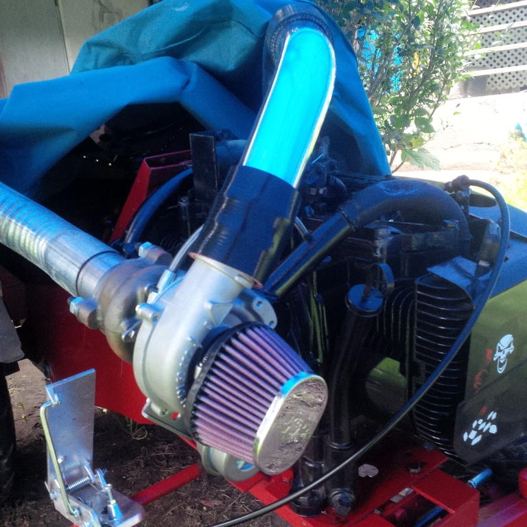

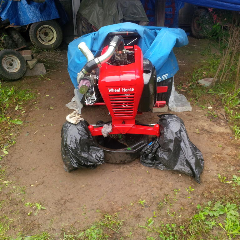

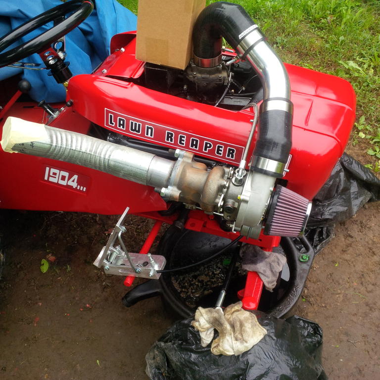

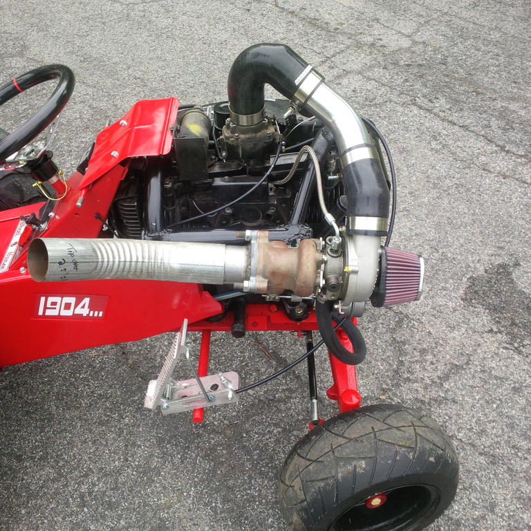

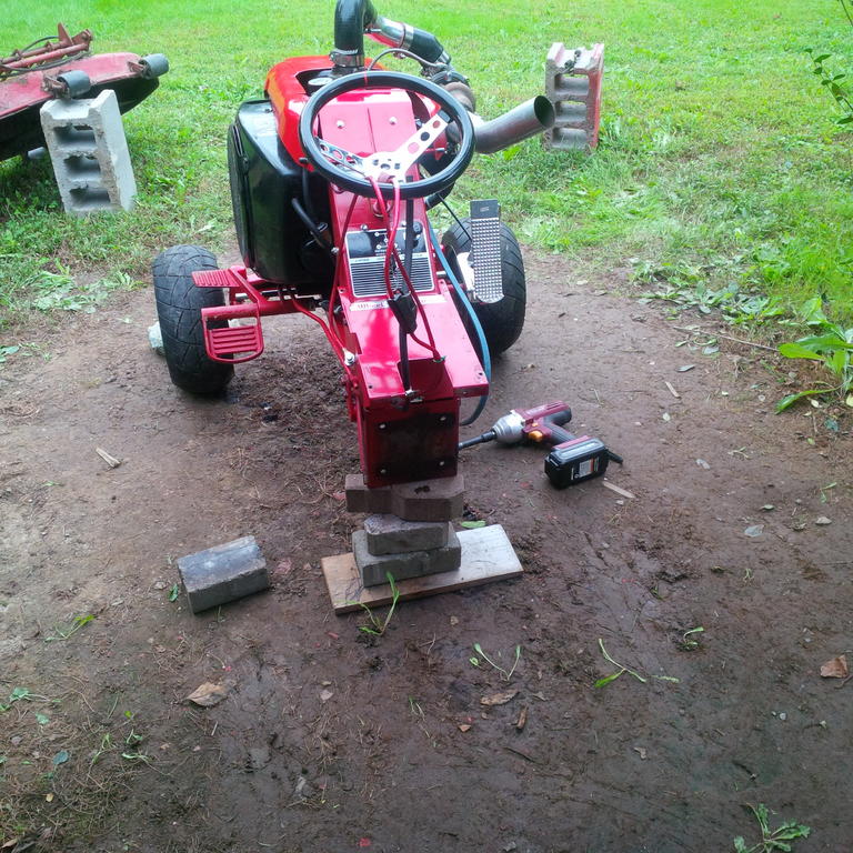

fast88pu 3,394 #145 Posted September 24, 2018 I got the oil lines ran today and also the charge tubes. She now has boost. NEXT it to get the new rear in and the upgraded fuel system. And also got all Terry's A+ decals on it. 2 6 Share this post Link to post Share on other sites
Daron1965 644 #146 Posted September 24, 2018 Your work and creativity impress me. That is one awesome scary looking Wheelhorse. 2 1 Share this post Link to post Share on other sites
AMC RULES 37,259 #147 Posted September 24, 2018 Hole in the hood... is looking much better now Kyle. 2 1 Share this post Link to post Share on other sites
