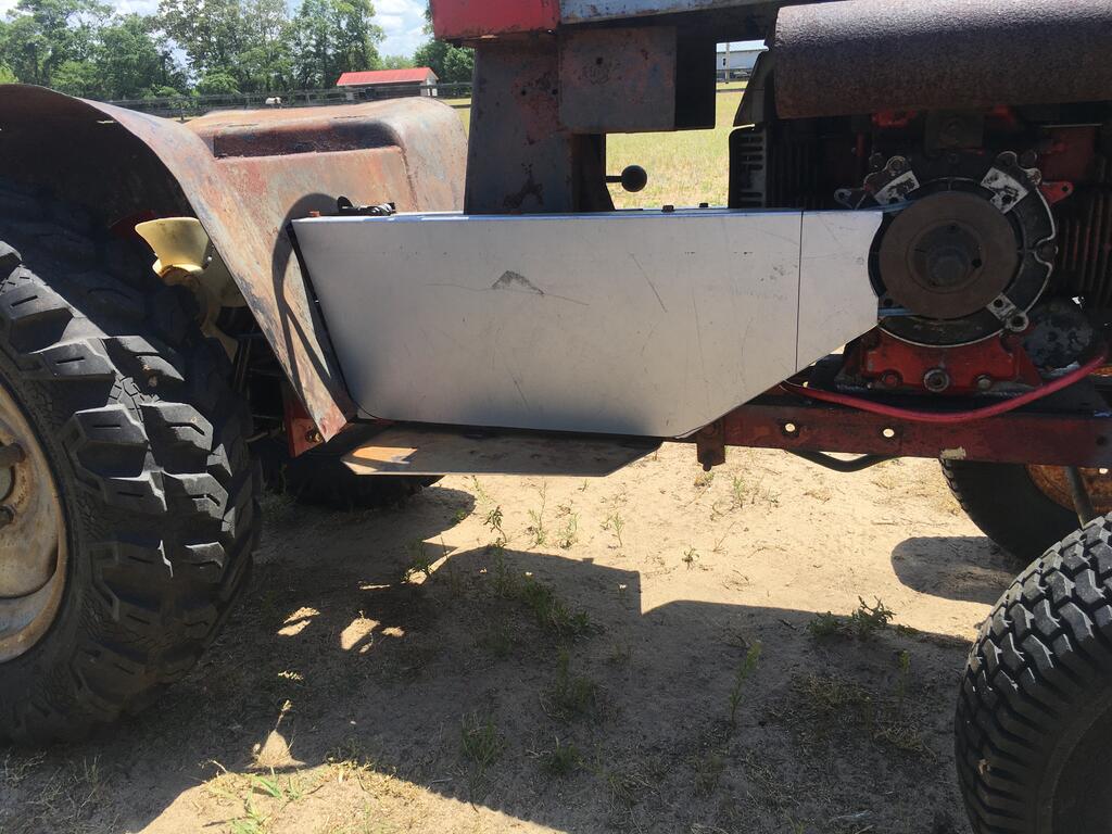

19richie66 17,950 #179 Posted May 8, 2021 New belt cover. Still have a little tweaking to do. 3 8 Share this post Link to post Share on other sites

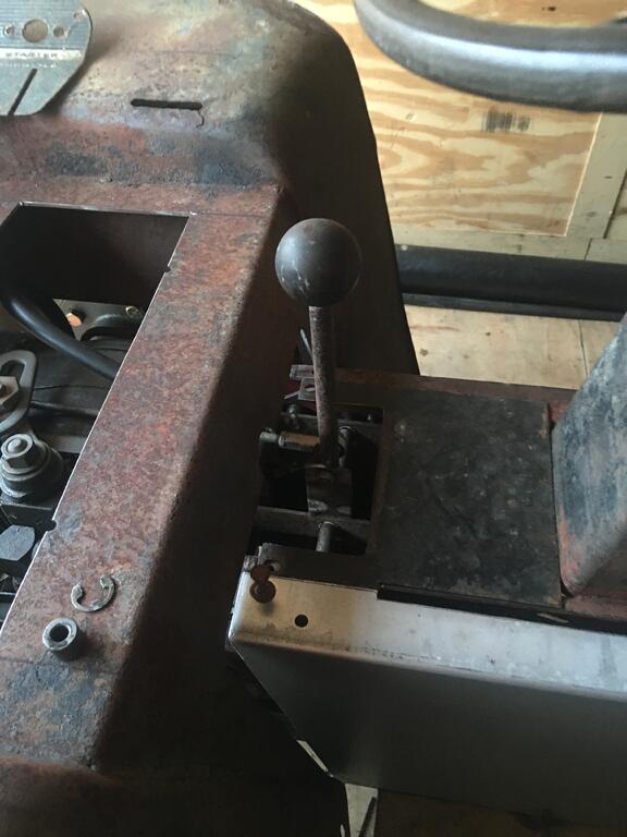

19richie66 17,950 #187 Posted May 19, 2021 (edited) In keeping up with the deception, cut the stick shift stick off and welded it to the motion control lever. When the plate is installed and a small “boot” made, it should look like a manual Edited June 14, 2021 by 19richie66 6 8 Share this post Link to post Share on other sites
ebinmaine 81,208 #188 Posted May 19, 2021 I like it. Sleeper Hydro. 2 1 Share this post Link to post Share on other sites
Pullstart 71,537 #189 Posted May 22, 2021 Genius! So creative, Richie! 1 Share this post Link to post Share on other sites

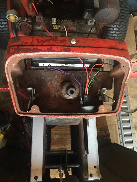

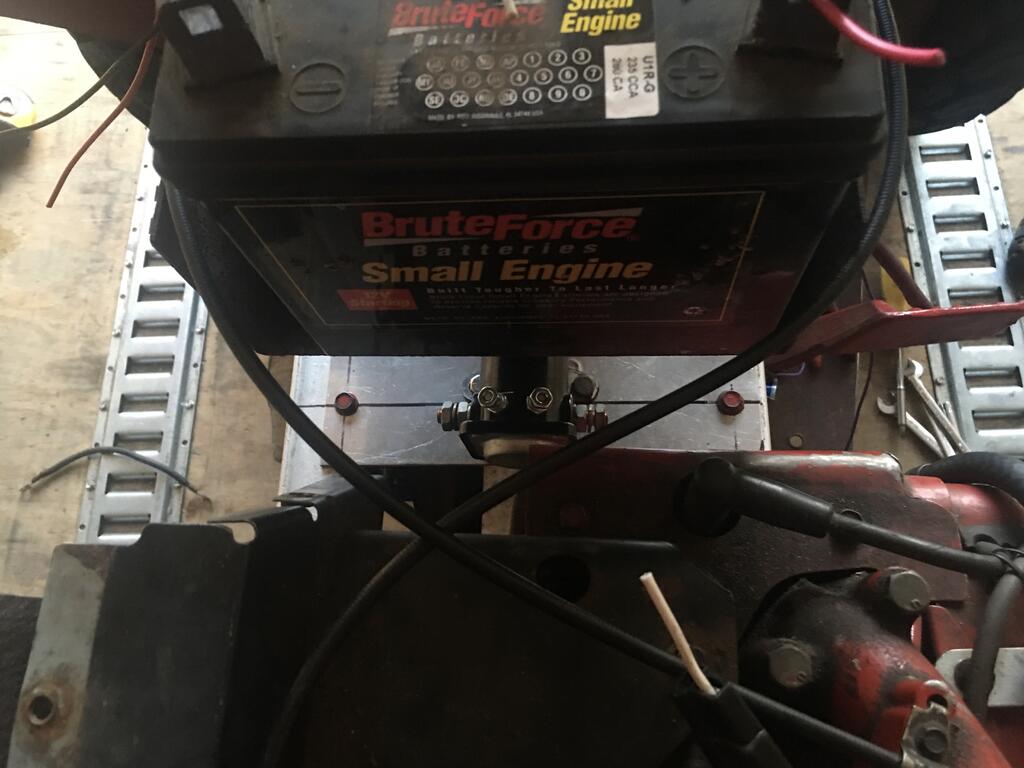

19richie66 17,950 #199 Posted May 28, 2021 (edited) Throttle & choke levers came in today. Those are installed, cables hooked up and adjusted. Also made a plate for the solenoid to mount to. Wiring is next. Made a harness from an Xi harness I had. Repositioned wires to the correct terminals and Ohm tested good. Edited May 28, 2021 by 19richie66 4 1 Share this post Link to post Share on other sites

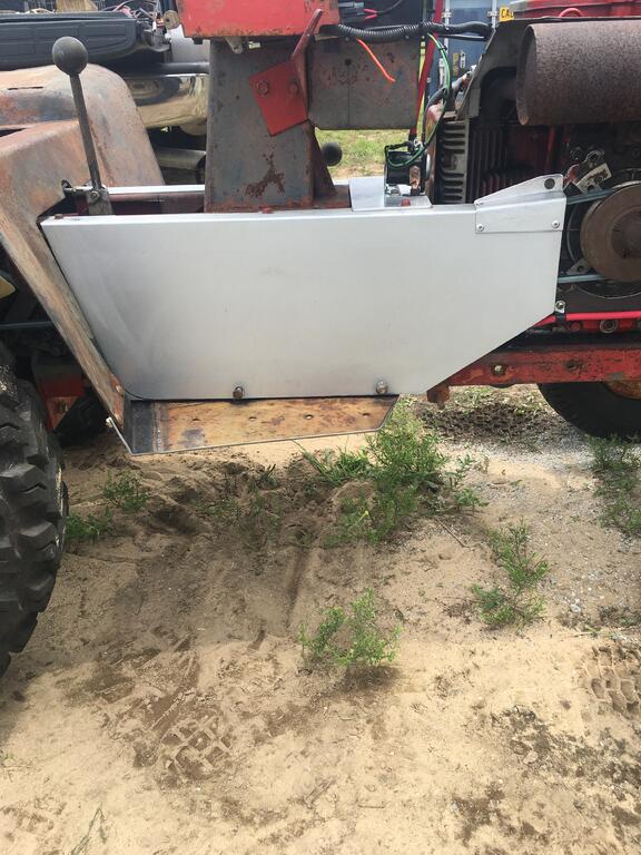

19richie66 17,950 #200 Posted June 13, 2021 (edited) List is getting smaller.......Got the foot plates shaped and bolted up. Finished the wiring, solenoid plate and the side cover. Had to rivit an upper mounting bracket on the belt cover till an aluminum magician can work his magic. It’s getting excited to go to the show. Edited June 13, 2021 by 19richie66 7 1 1 Share this post Link to post Share on other sites
