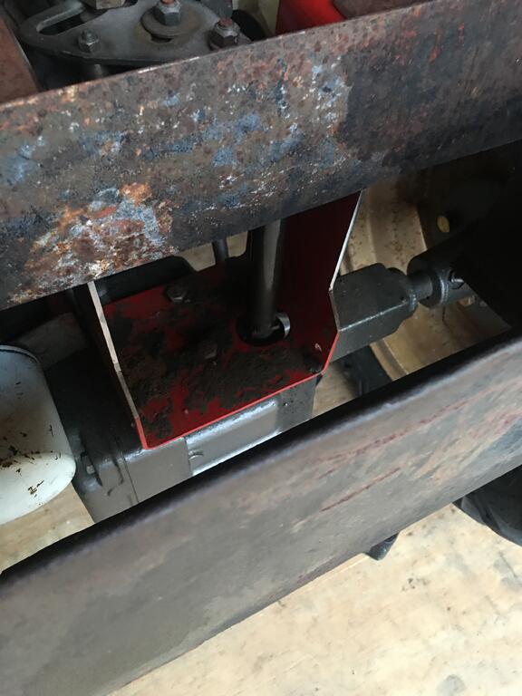

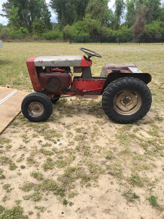

19richie66 17,950 #151 Posted April 25, 2021 Got the linkage kinda sorted out today. The tunnel framework made it a little difficult to get everything lined up but I think I got it. Just need a new brake spring and a belt. Hopefully I can het it moving soon. 4 9 Share this post Link to post Share on other sites

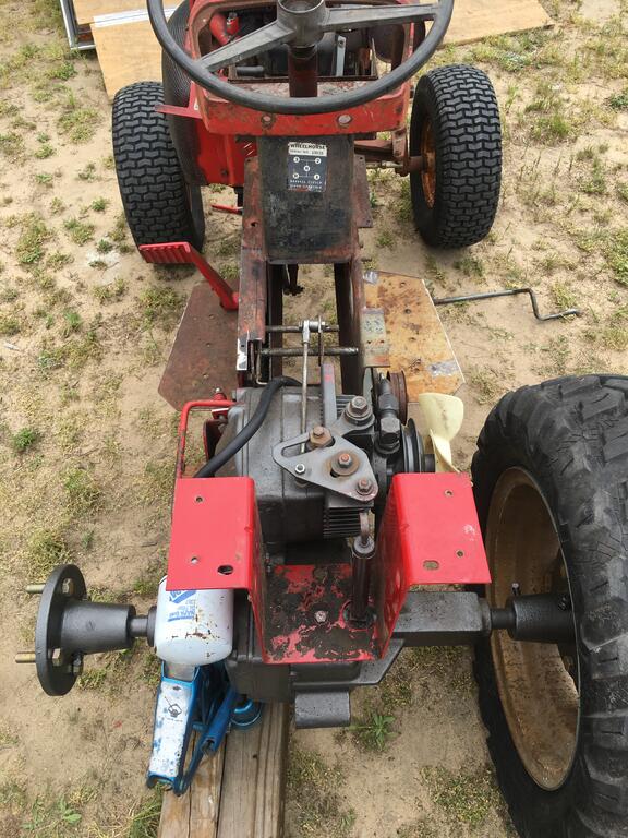

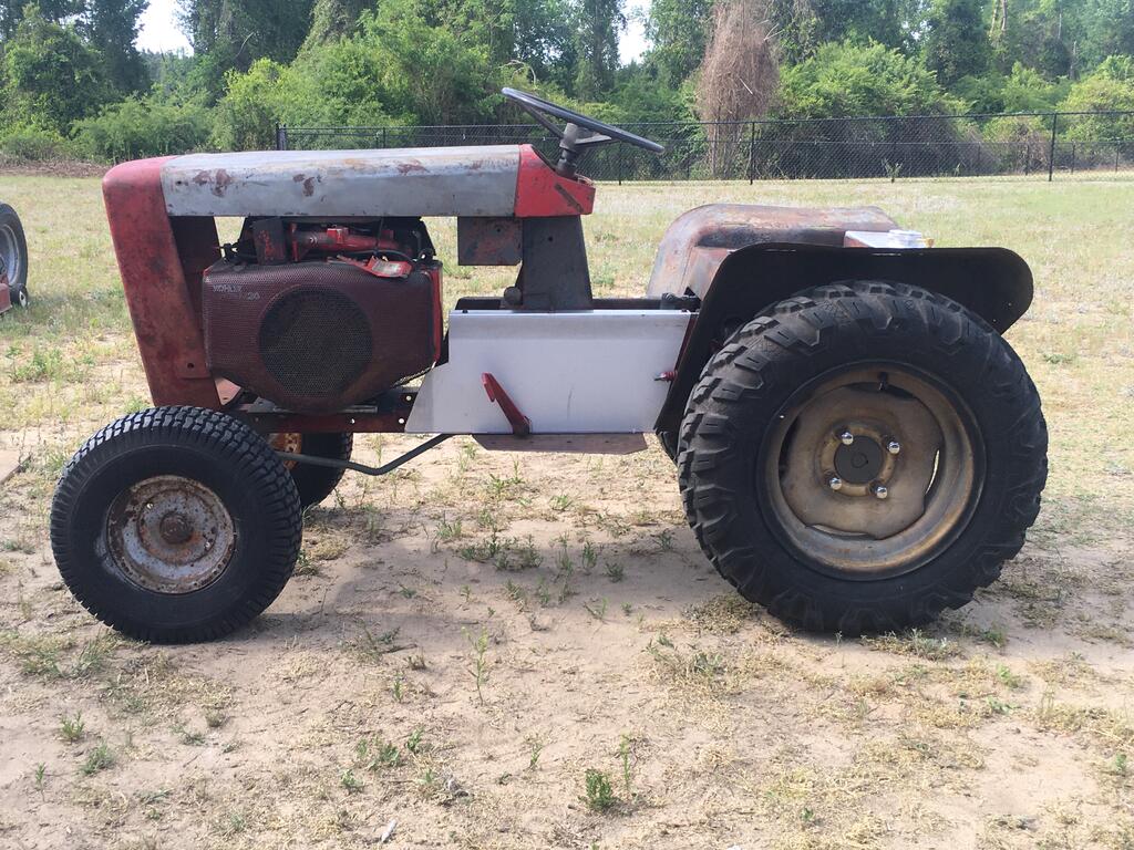

Pullstart 71,537 #154 Posted April 26, 2021 Awesome stuff Richie! Remind me... Overall, is that a GT14 wheelbase or is it extended? 1 Share this post Link to post Share on other sites
19richie66 17,950 #155 Posted April 26, 2021 (edited) 13 minutes ago, pullstart said: Awesome stuff Richie! Remind me... Overall, is that a GT14 wheelbase or is it extended? Gt14 frame with the steering moved forward 3”. Basically the front axle pivot plate gets moved where the thin metal strip was on the gt14. The 953/1054 axle pivot is all the way to the front of the frame so I made it the same. This is also why I have to use a gt14 hood. All the linkage is based off what I did with Skittles as close as possible. Some of the metal is a little different but it’s close. Edited April 26, 2021 by 19richie66 3 1 Share this post Link to post Share on other sites

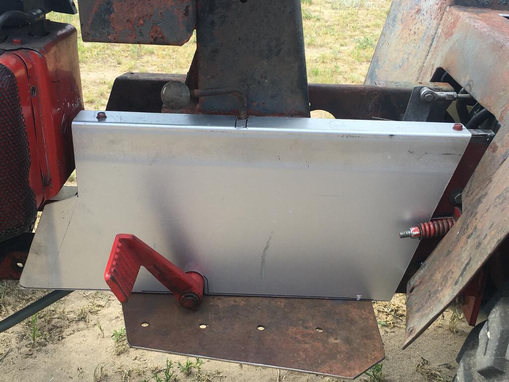

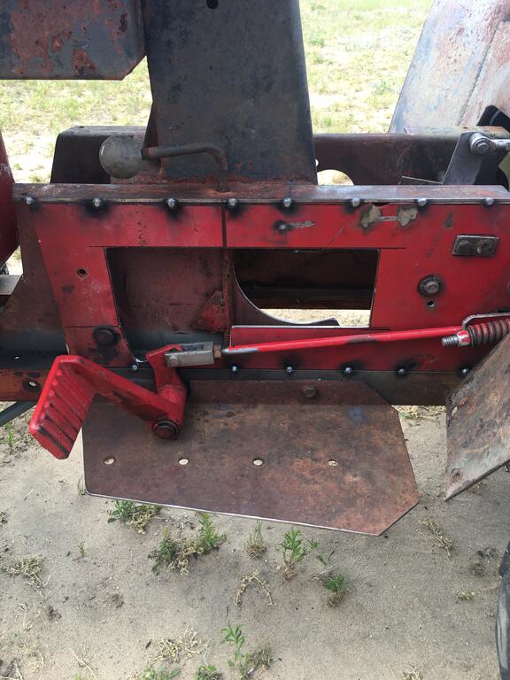

19richie66 17,950 #158 Posted May 2, 2021 Had to cut out a section for the brake lock lever. Finally got it to fit in but I’ll have to make something on the linkage for it to grab. It’s right there though when pulled around. Also had to make a new side cover as the other one was cut for the 1054 brake pedal. This has a gt14 pedal but it worked out that it covers the linkage and the pedal assy. Have to make a new right side also since the engine sits in a different spot than the original. Next week 👍 5 6 Share this post Link to post Share on other sites

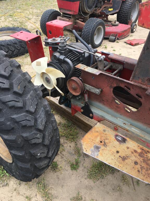

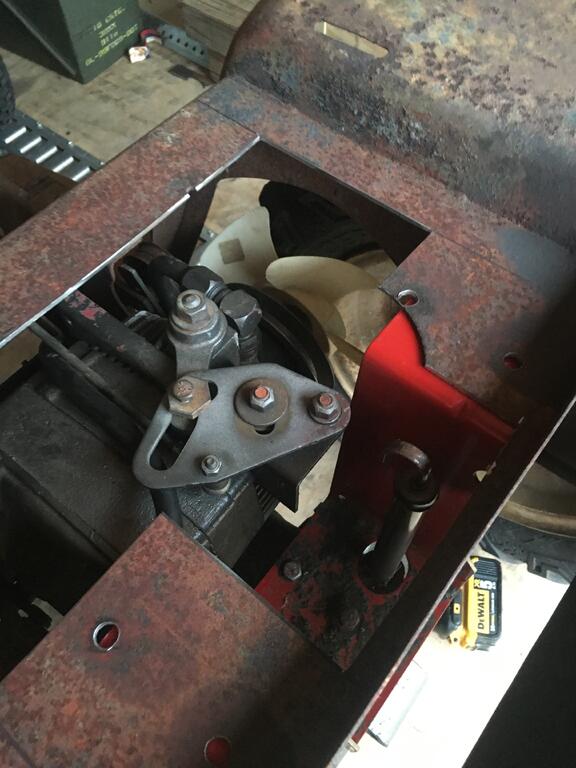

19richie66 17,950 #172 Posted May 4, 2021 (edited) A little more trimming.... cleared the fan blade, the control linkage from the pump. Had to trim 3/4” off the seat stand so the pan could move back to it’s original spot. Hope she gets to drive it on Mother’s day. Edited May 4, 2021 by 19richie66 3 1 Share this post Link to post Share on other sites

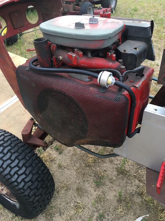

19richie66 17,950 #175 Posted May 5, 2021 Fuel system ✔️ 2 1 Share this post Link to post Share on other sites
