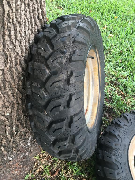

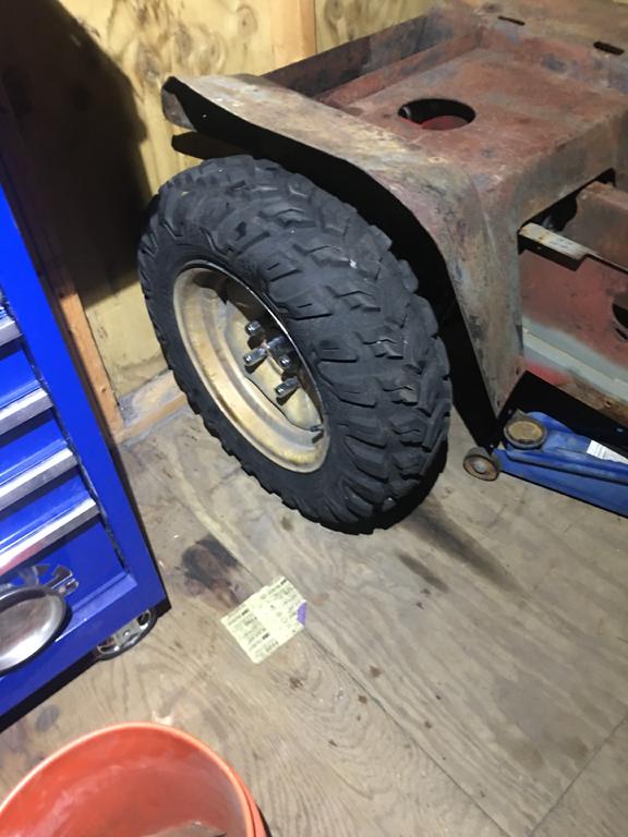

19richie66 17,932 #131 Posted October 26, 2019 The “2054” got some temporary shoes today. These will eventually be replaced by the same tires but 26-11x15 on 10” wide wheels. These are 26-9.0x15 on stock gt14 wheels. 8 Share this post Link to post Share on other sites
PeacemakerJack 11,059 #132 Posted October 26, 2019 Those look good on there Richie! Nice...I’m pretty sure that I’m gonna run a set of ATV tires on the back of my CC 582 plow rig. There are some aggressive AG style treads that offer a much wider selection of narrower and taller tires than the GT tires selection alone. Are those the tires you picked up fairly recently? 1 Share this post Link to post Share on other sites
19richie66 17,932 #133 Posted October 26, 2019 32 minutes ago, PeacemakerJack said: Those look good on there Richie! Nice...I’m pretty sure that I’m gonna run a set of ATV tires on the back of my CC 582 plow rig. There are some aggressive AG style treads that offer a much wider selection of narrower and taller tires than the GT tires selection alone. Are those the tires you picked up fairly recently? Yes. I got four of them.... 2 fronts and 2 rears off of a UTV. Guy bought them for the rims and sold me the tires. 1 1 Share this post Link to post Share on other sites

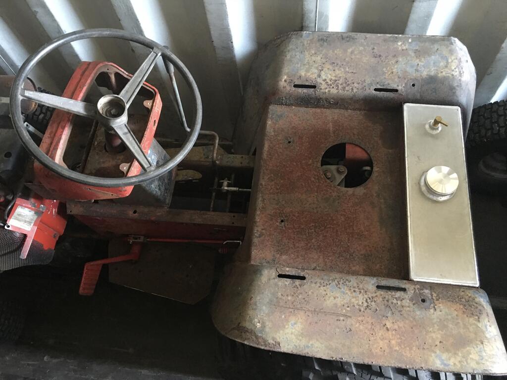

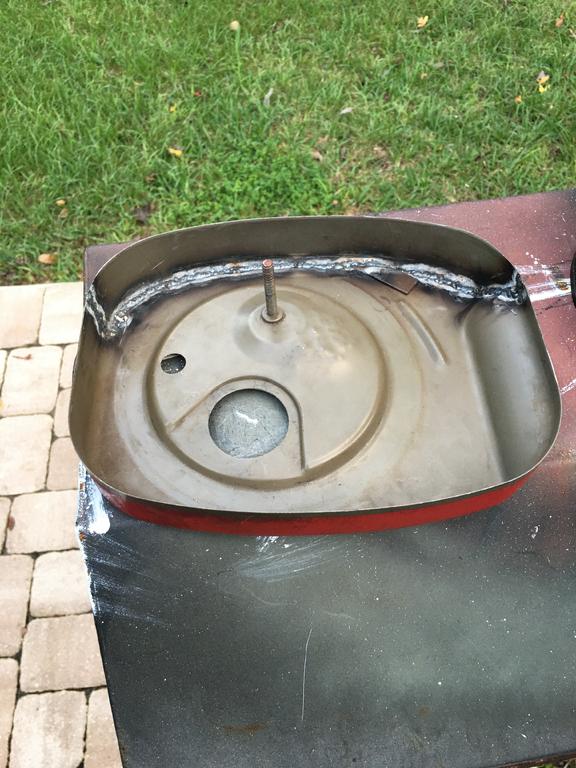

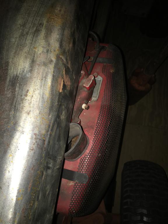

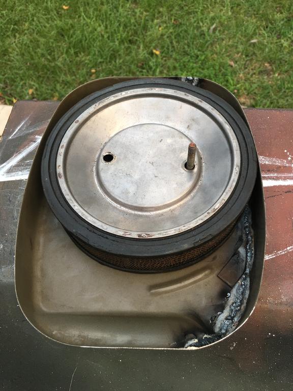

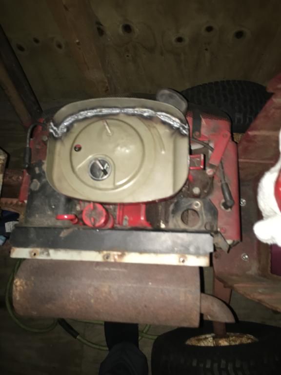

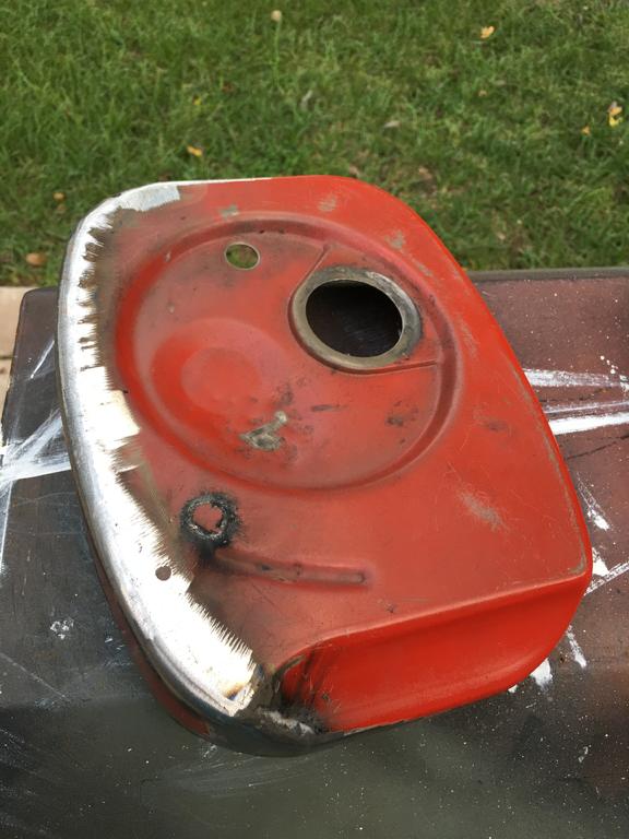

19richie66 17,932 #134 Posted November 9, 2019 Had to remove about 1-1/2” off the air cleaner base to clear the hood. Still have to do the lid. At least the hood fits over it now. Also still have to clean up the inside a bit. You’ll never see it but I know it’s there. 8 2 Share this post Link to post Share on other sites
Pullstart 71,206 #135 Posted November 10, 2019 Looks great! Are you going to use the air snorkel tube from the fan housing still, or trim that out too? Share this post Link to post Share on other sites
19richie66 17,932 #136 Posted November 10, 2019 (edited) Nowhere now for it to go.. I may fill in the hole or just get the factory plug for it. Edited November 10, 2019 by 19richie66 1 Share this post Link to post Share on other sites
Mudrig150 396 #137 Posted November 13, 2019 On 11/10/2019 at 6:31 PM, 19richie66 said: Nowhere now for it to go.. I may fill in the hole or just get the factory plug for it. Pretty much every magnum and KT engine has no hole there, it's only engines spec'd with the teardrop or square air cleaner that have the hole. In fact, I have 2 seperate magnum shrouds without the hole. Or, you could fill it in until it's round and add a flexible tube from the shroud to the air cleaner. Share this post Link to post Share on other sites

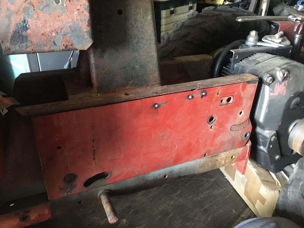

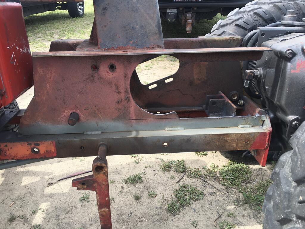

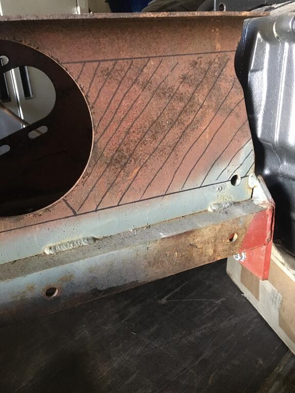

19richie66 17,932 #138 Posted March 7, 2021 Side plate made for hydro control linkage. This is an old gt14 side plate that I cut and will make it the same as Skittle’s side plate since this is based off a gt14 frame. So far it fits good. Just have to get the inner portion of the 1054 frame cut out so the control linkage clears. 3 1 Share this post Link to post Share on other sites
Pullstart 71,206 #139 Posted March 13, 2021 Master surgeon Richie, back at it again! 1 Share this post Link to post Share on other sites

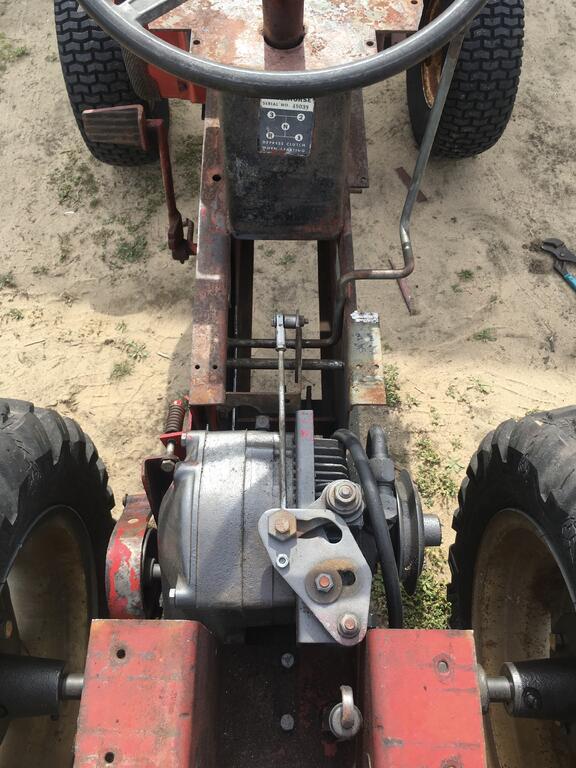

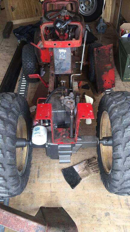

19richie66 17,932 #142 Posted April 2, 2021 Nothing exciting but it does steer now. Had to extend the steering rod 3” since I relocated the front axle. 6 1 Share this post Link to post Share on other sites
ebinmaine 80,597 #143 Posted April 2, 2021 3 minutes ago, 19richie66 said: Nothing exciting I don't know about that Richie. Steering is kind of Paramount 3 Share this post Link to post Share on other sites
Lee1977 7,764 #144 Posted April 3, 2021 6 hours ago, 19richie66 said: Nothing exciting but it does steer now. Had to extend the steering rod 3” since I relocated the front axle. We both work on the steering today, got mine fixed. I have a project on my tail gate, but didn't get to that one. Need to do some "Blind blank Welding" on that one. 1 Share this post Link to post Share on other sites

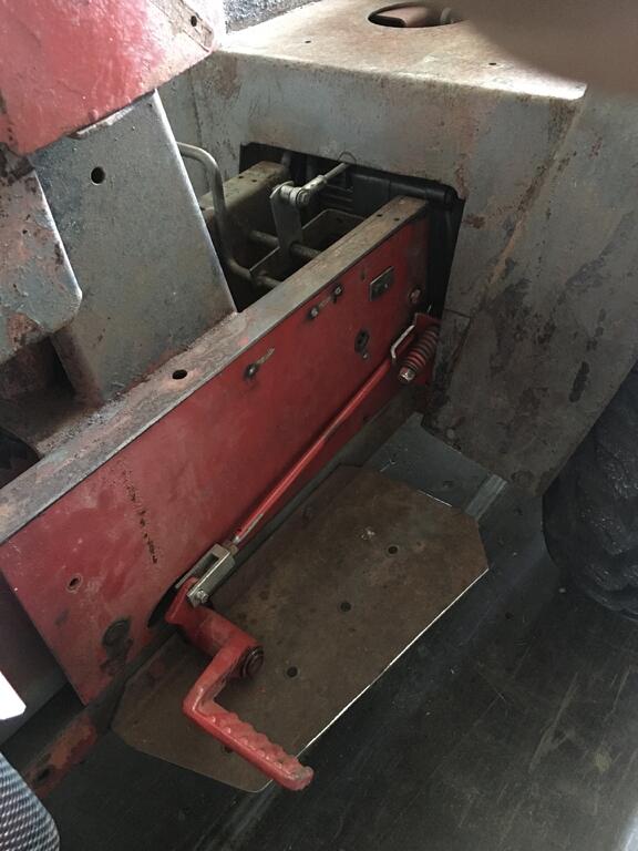

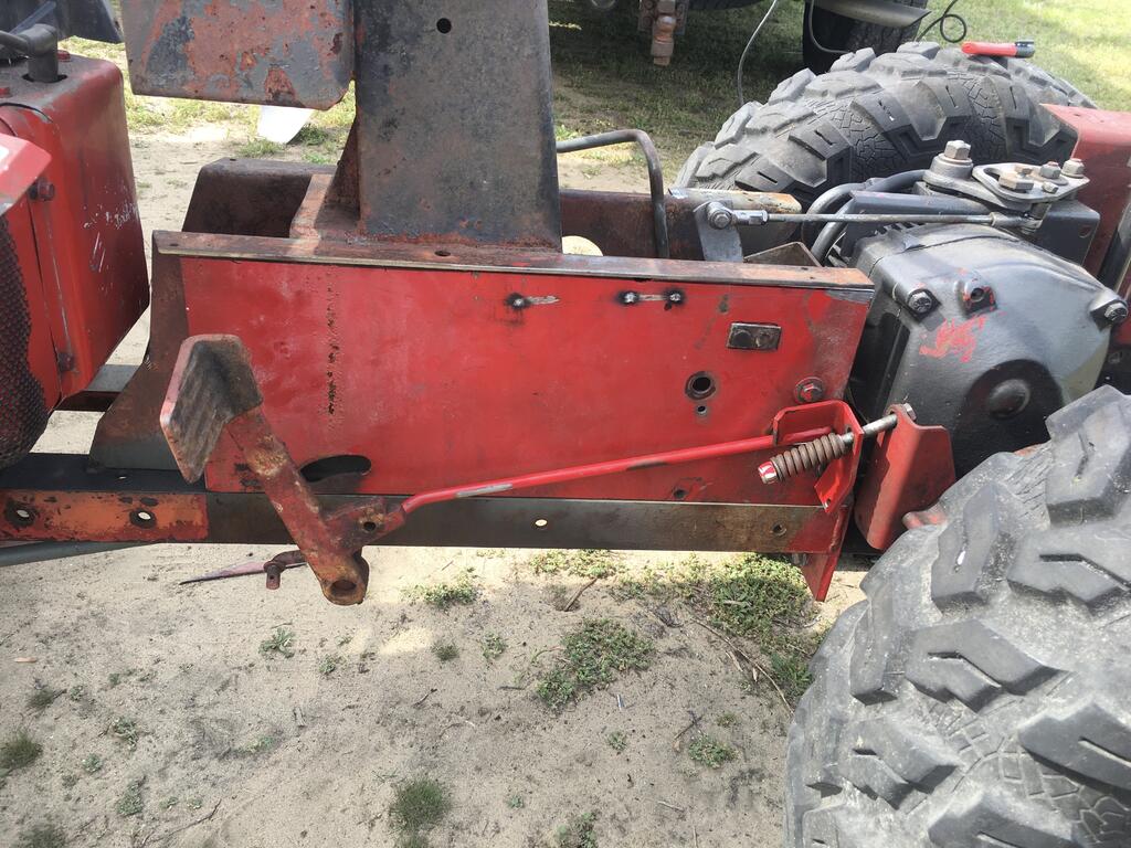

19richie66 17,932 #145 Posted April 11, 2021 Got a chance today to play a little. Managed to get the side frame plate cut out, notched the “new” side plate for the brake pedal linkage. Got the hole measured and drilled for the motion linkage pivot rod and mocked everything up. Still need to shorten the brake rod and hook all that up. 2 4 Share this post Link to post Share on other sites

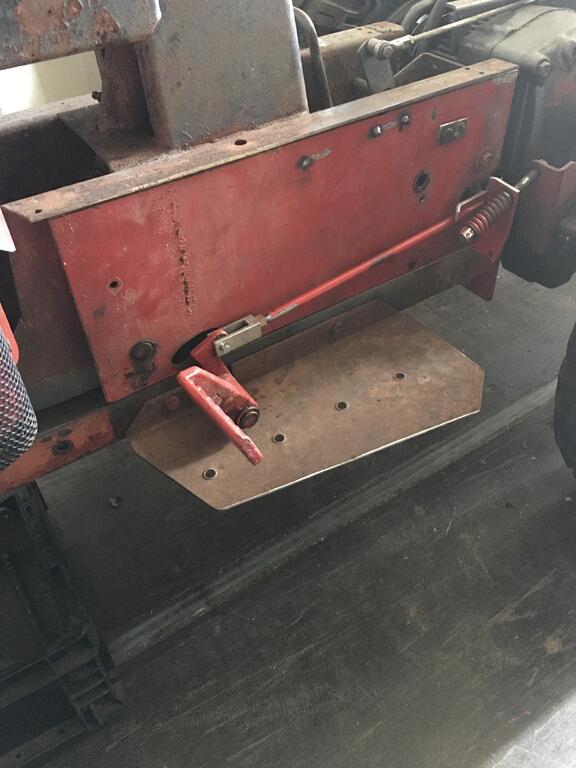

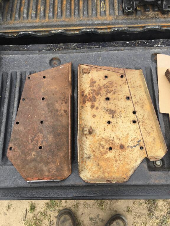

19richie66 17,932 #146 Posted April 19, 2021 Got a little more done on the wife’s “2054”. Since the frame is a gt14 frame, I needed to use the gt14 foot plates (already drilled for the frame) but want them to look like the correct step. So I sliced and diced a set of gt14 steps to the correct size. I will weld the tail piece that bolts to the front of the fender later, after I get the fender pan mounted solid. Starting to look like I’m actually getting somewhere. 2 7 Share this post Link to post Share on other sites
953 nut 69,105 #147 Posted April 19, 2021 1 hour ago, 19richie66 said: Got a little more done on the wife’s “2054” Wouldn't that be a 2074 since it is a twenty HP with a hydro built in '64? 2 Share this post Link to post Share on other sites
19richie66 17,932 #148 Posted April 19, 2021 (edited) I always figured it was a 1054 with twice the HP....... hence “2054”. I need to get Terry to make me some decals. 👍 Edited April 19, 2021 by 19richie66 3 Share this post Link to post Share on other sites

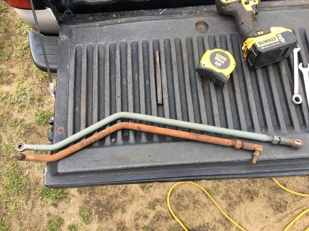

PeacemakerJack 11,059 #149 Posted April 21, 2021 That is really looking good Richie...I like the progress and how it is shaping up👍🏻 Nice use of the Heim joints for the steering linkage... 1 Share this post Link to post Share on other sites
19richie66 17,932 #150 Posted April 25, 2021 Little bit of linkage action happening today 2 Share this post Link to post Share on other sites
