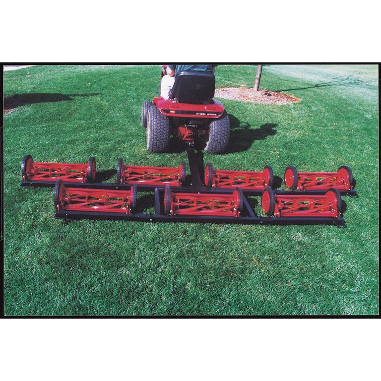

Achto 30,210 #18 Posted July 3, 2018 If you like the idea of mowing with a I would suggest a 520HC and a 9'8" gang set up. https://www.northerntool.com/shop/tools/product_112395_112395?cm_mmc=Google-pla&utm_source=Google_PLA&utm_medium=Lawn %2B Garden > Lawn Mowers > Gang Reel Mowers&utm_campaign=Pro Mow&utm_content=250033&gclid=EAIaIQobChMIoKitvN6C3AIVRYjVCh0h8Qh0EAQYAiABEgKYavD_BwE I like the fact that the picture on their site shows it hooked to a . Good call Northern Tool !! 4 3 1 Share this post Link to post Share on other sites

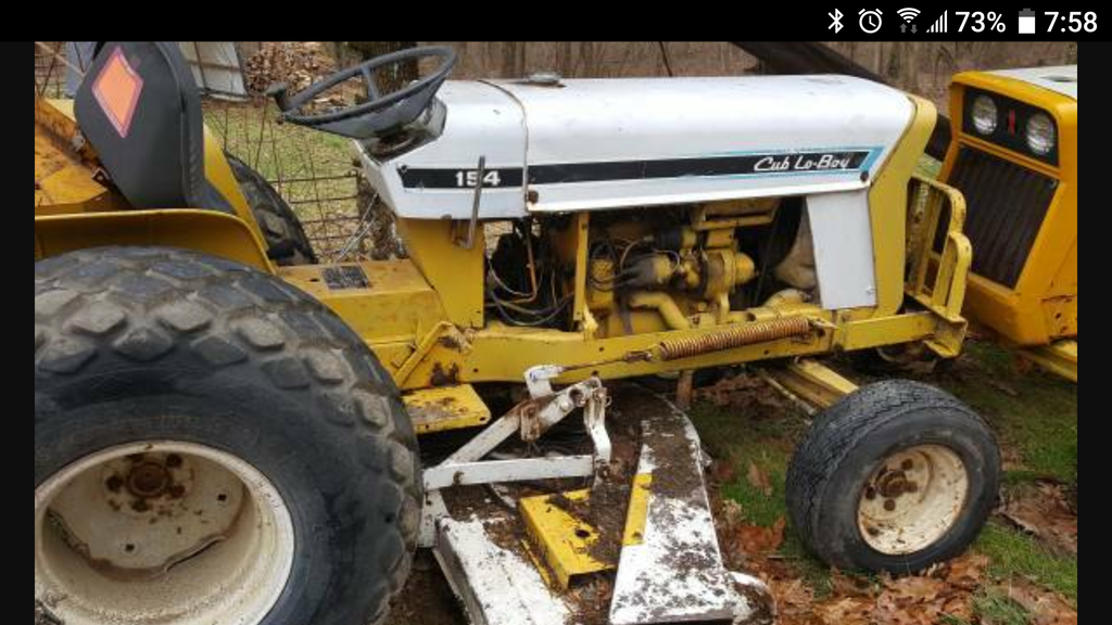

Jrblanke 918 #22 Posted July 3, 2018 I just sold a cub tractor for $2100 w/ a 60" woods belly mower. I was surprised at how cheap those things were. You can also raise ithe deck higher than a 520 would raise a deck, and even though its rated at 14Hp, there are 4 cylinders and has more gearing and torque. If you HAD to use a WH I think I would do some research on pull behind/wing mowers and then obviously you would want a 48"+ deck on the 520. To me, though 10 acres is a a lot of property to cut with something smaller than 60". I guess it depends on how much time you want to spend on the mower and how often you want to cut it. Here is a mowing calculator you can use. AT 4 mph and a 60" cut, you can do 2.18 acres per hour. S0 it would take you around 5 hours to cut not counting refuel time. https://www.landscapecalculator.com/calculators/mow Interesting question to ponder! I've never had to think about this. 1 Share this post Link to post Share on other sites

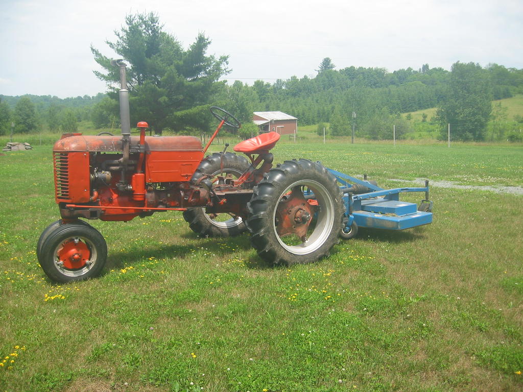

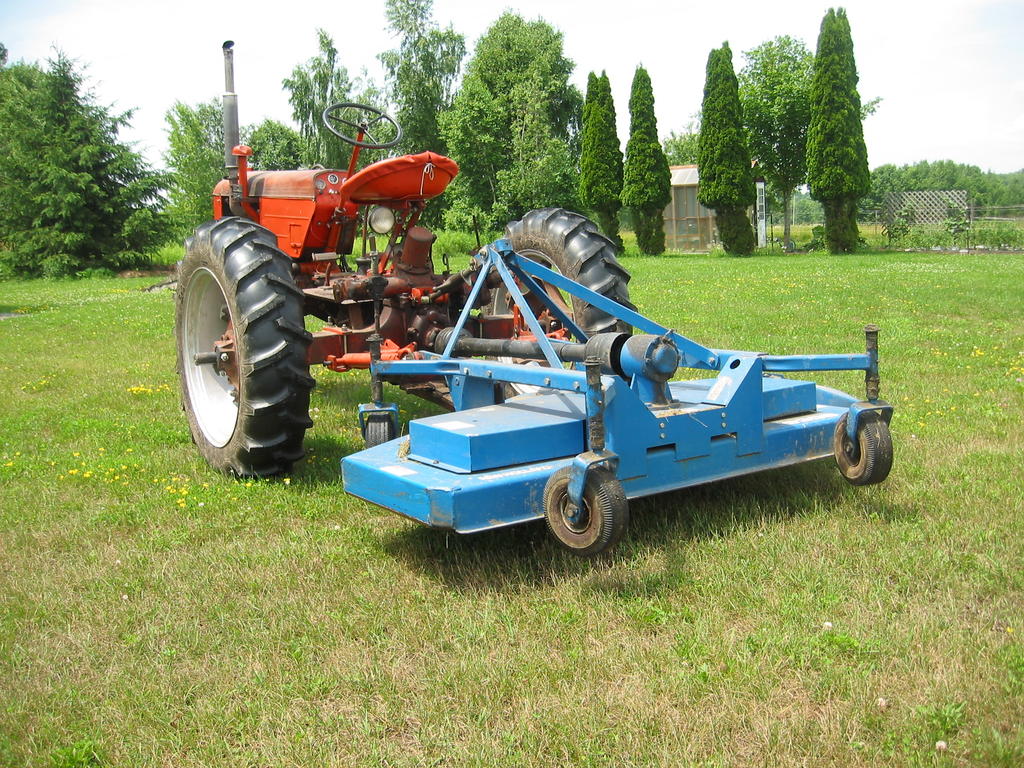

pfrederi 19,278 #24 Posted July 3, 2018 This rig mows at least that and a lot of it is not very smooth i think a non commercial Z turn would beat you and itself to death on the areas I mow. More importantly the tractor cost me 1200 the deck 1500.and i have been using her for 12-13 years now. 72 inch New Holland finish mower 1951 Case VAC rate at 21hp on the belt 19 drawbar. 6 2 Share this post Link to post Share on other sites
