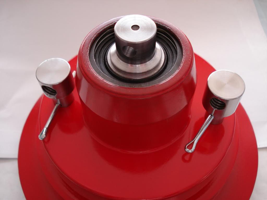

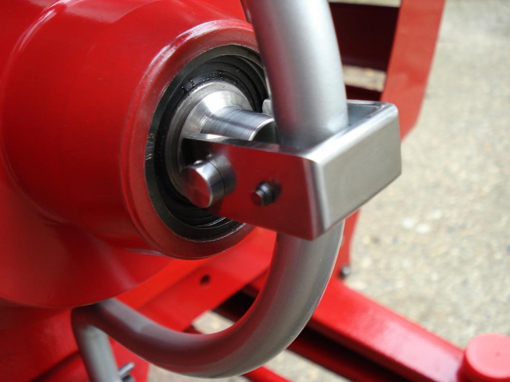

Anglo Traction 761 #9 Posted July 3, 2018 That PTO Clutch Shaft design is a weak spot of a Solid Garden Tractor design. It does not help you really, but I followed a change to it and made a Flanged Shaft when I renewed the Bearings and Seal for my Refurb- Being in the UK, it's easier for me to make parts than to source them. But if you know someone with a Lathe, I'm sure they would make one for you. 1 Share this post Link to post Share on other sites

bo dawg 565 #11 Posted July 3, 2018 1 hour ago, Anglo Traction said: That PTO Clutch Shaft design is a weak spot of a Solid Garden Tractor design. It does not help you really, but I followed a change to it and made a Flanged Shaft when I renewed the Bearings and Seal for my Refurb- Being in the UK, it's easier for me to make parts than to source them. But if you know someone with a Lathe, I'm sure they would make one for you. Now that looks Sweet!! I can't do anything like that, don't know anyone either. 1 Share this post Link to post Share on other sites
