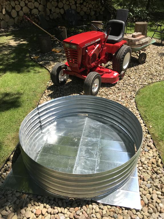

Al C. 1,429 #1 Posted June 30, 2018 Hauling brick for a new fire pit - no sweat! (1967 Wheel Horse 1067.) 10 Share this post Link to post Share on other sites

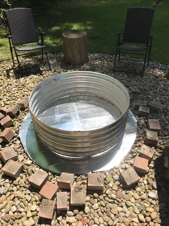

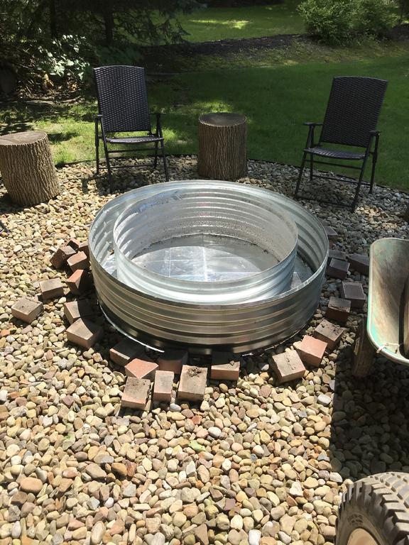

Al C. 1,429 #4 Posted June 30, 2018 The pit is built with two galvanized steel joining rings for culvert drainage pipe. The smaller ring is 36 inches in diameter. The larger ring is 48 inches. I’m going to fill the void between them with old brick and gravel (topped off with gravel). The outside of the pit will always stay “cool”. The floor of the pit is two sheets of galvanized ducting steel riveted together and cut round. Will look like this when done ... 3 Share this post Link to post Share on other sites
squonk 44,732 #5 Posted June 30, 2018 Might want to wipe down the galvanizing. The fumes when first heated could be nasty. Share this post Link to post Share on other sites
