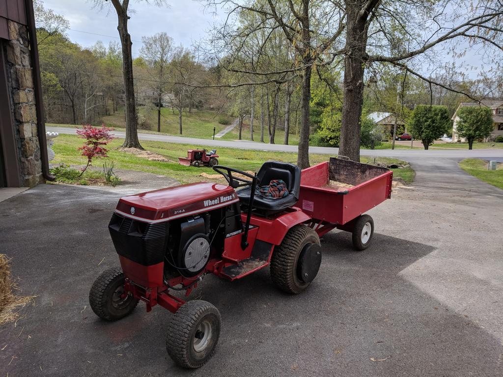

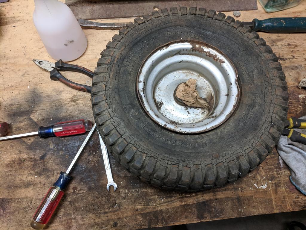

Busman 14 #1 Posted June 29, 2018 I've got an 85 314H and an 81 c125. I punctured a tube in onefront tire and I cannot get the front tire off. I even bent the wheel trying. Do y'all have any advice. At this point I will probably just replace the tire but I could use some help on the best way to proceed. Share this post Link to post Share on other sites

Busman 14 #6 Posted June 30, 2018 Thanks guys. I've got the bead broken on both sides. Looks like in gonna take a ride to the tire shop. 1 1 Share this post Link to post Share on other sites

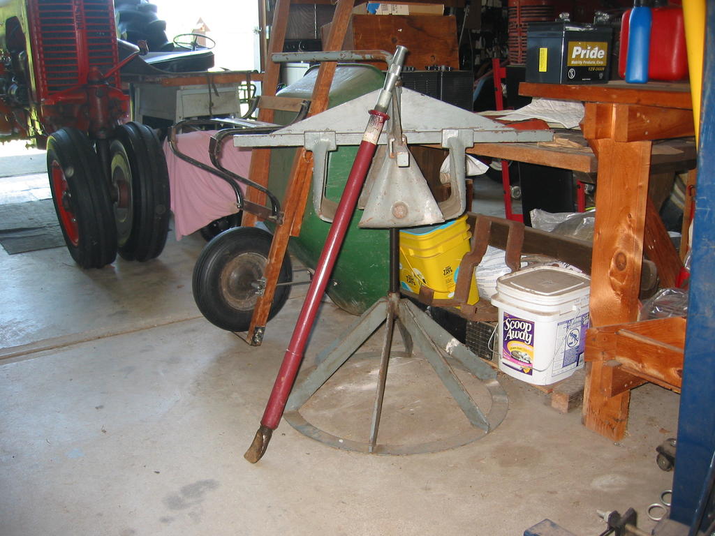

pfrederi 19,069 #16 Posted June 30, 2018 (edited) I break the bead first using the purple slide hammer or the big gray bead breaker. Then the HF small machine for front wheels and their regular size one for back wheels. have had both of them for years. Bent them a bit before I got serious bead breakers. 18 WHs 3 Tractors and two mil vehicles I have had tires of all ages. Have never gone to tire place... Edited June 30, 2018 by pfrederi 3 Share this post Link to post Share on other sites
