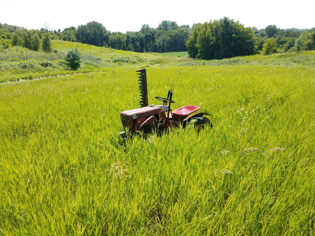

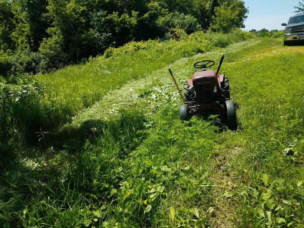

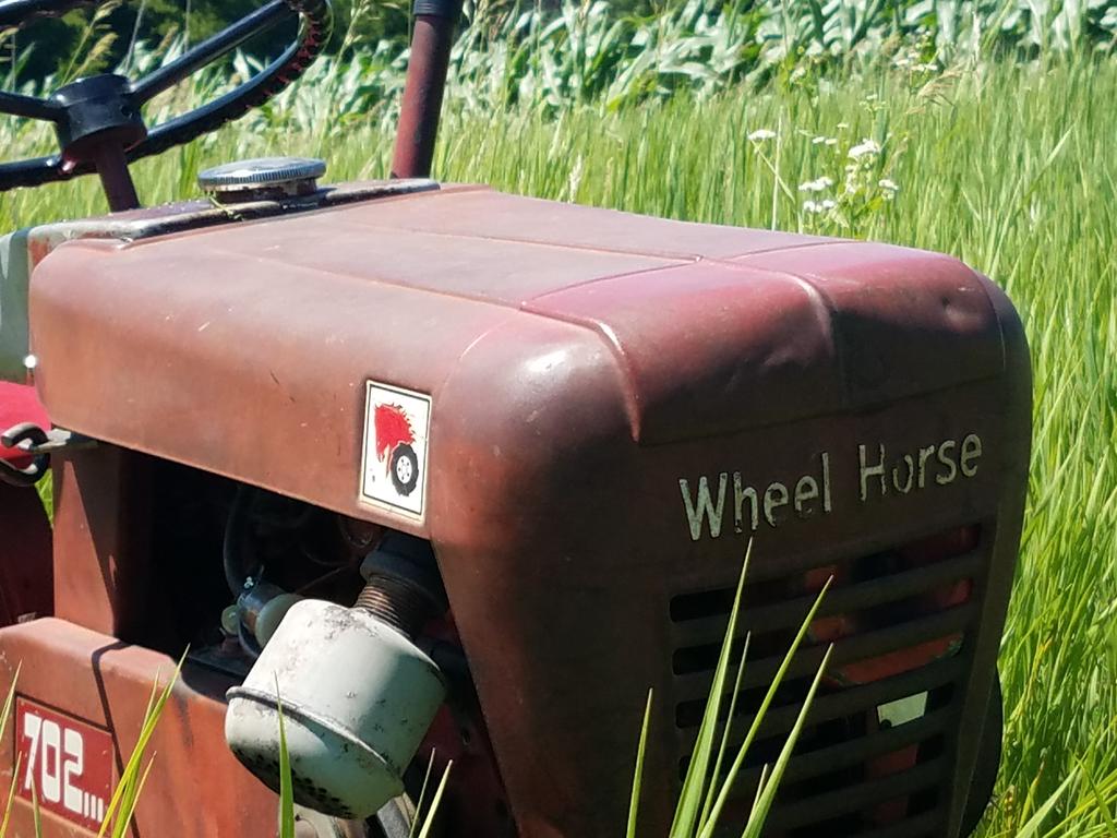

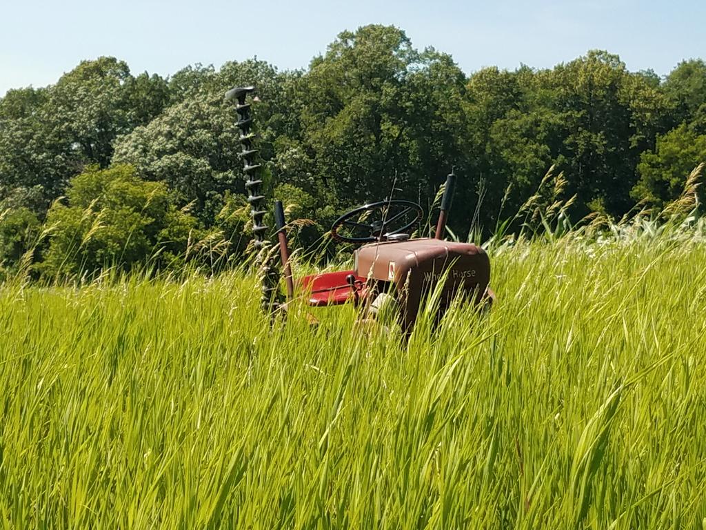

Shynon 7,543 #1 Posted June 29, 2018 Took the 702 out for a little sickling. 12 8 Share this post Link to post Share on other sites

Shynon 7,543 #5 Posted June 29, 2018 6 minutes ago, dclarke said: Yep!!......... How'd it do Tom? Does pretty good, seems to pull a lot of grass up in the pulleys and jam it full of grass. But needs some new blades. Gotta find me some rivets and replace all the knives. It's all fun using the attatchments as they are intended for. 4 Share this post Link to post Share on other sites
MalMac 1,334 #6 Posted June 29, 2018 Sometimes you can have too much RPM on the sickle. Does not give the grass/weeds a chance to get in between the knives. Plus ground speed has to match the cutting action. 3 Share this post Link to post Share on other sites
