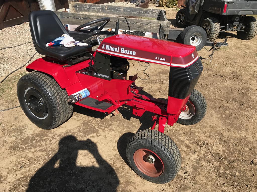

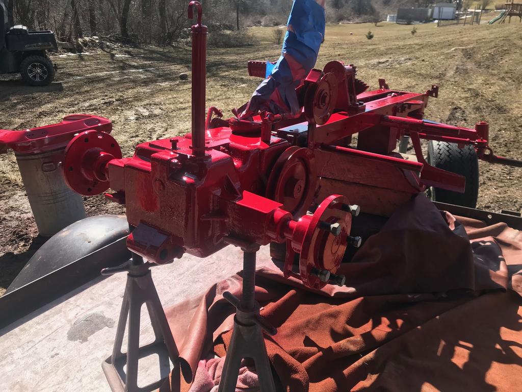

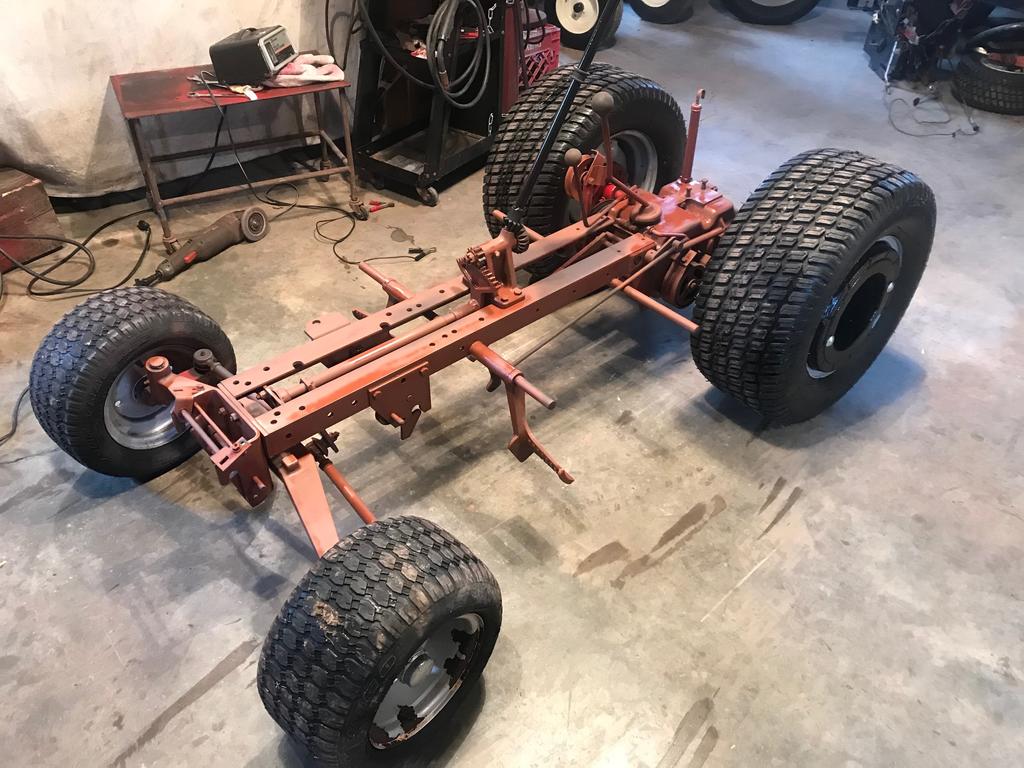

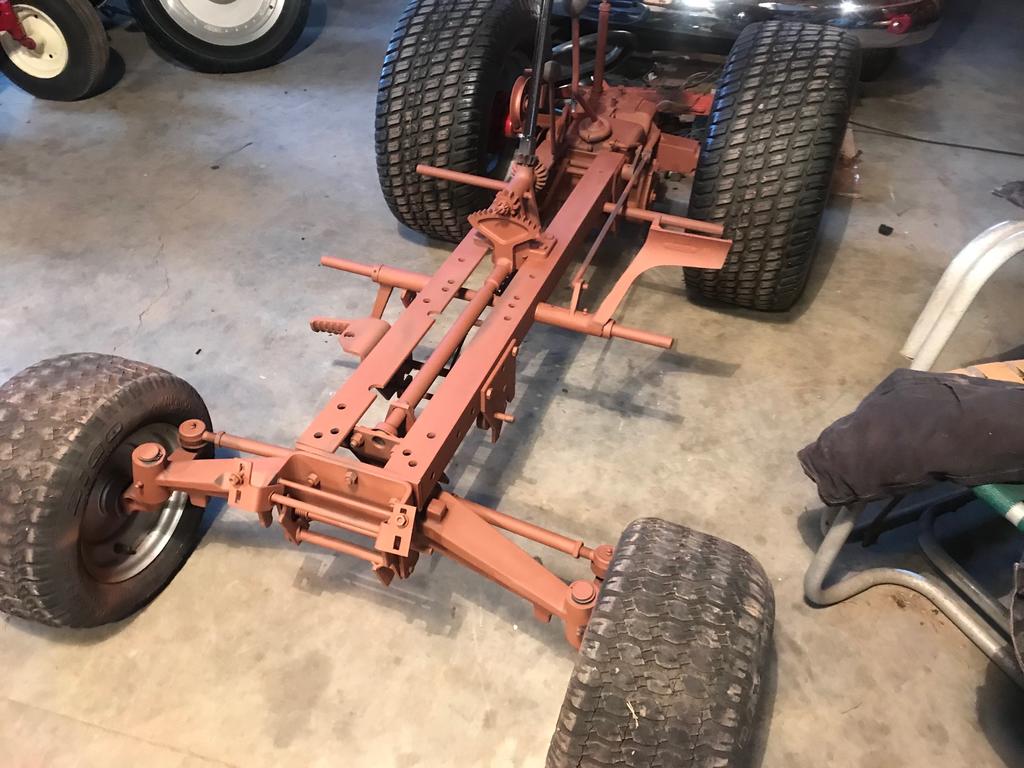

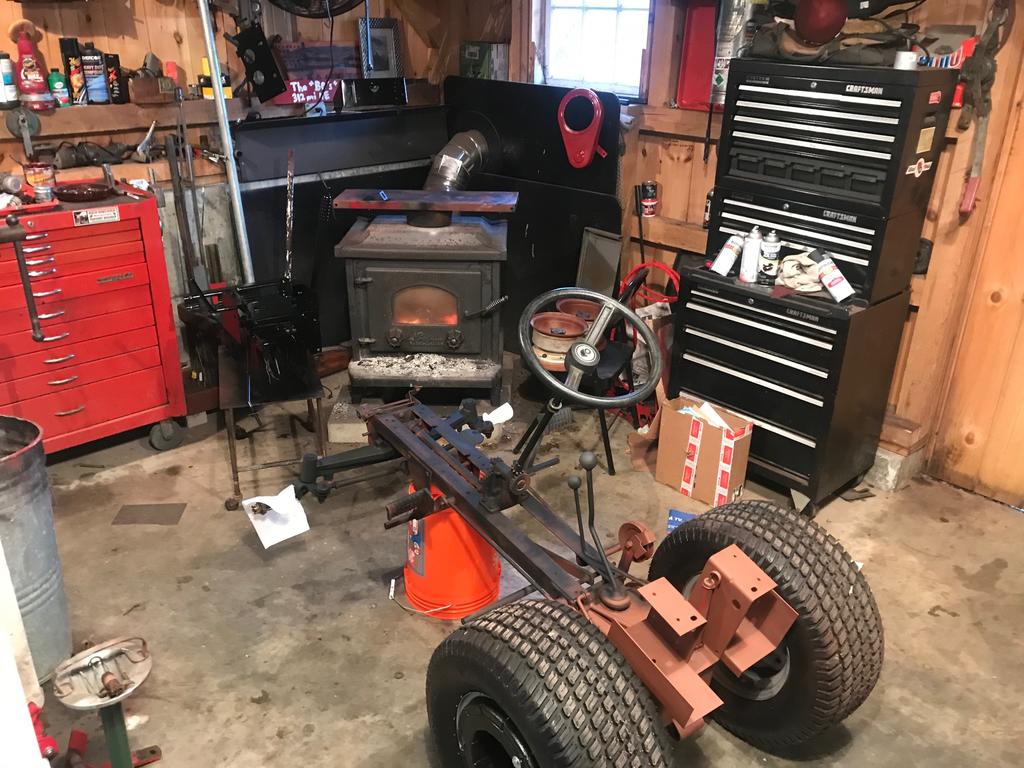

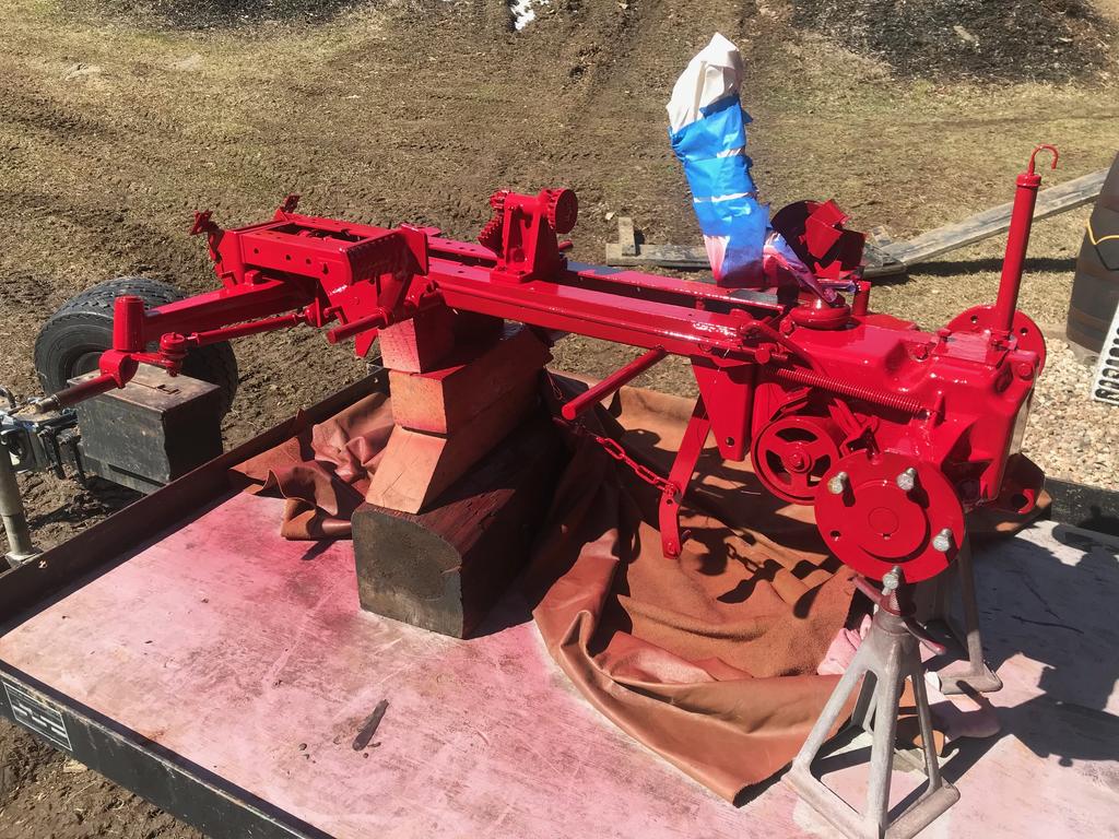

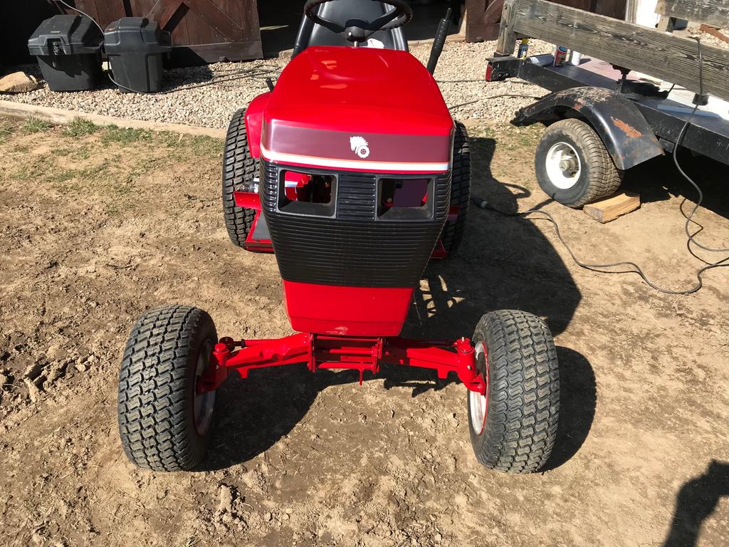

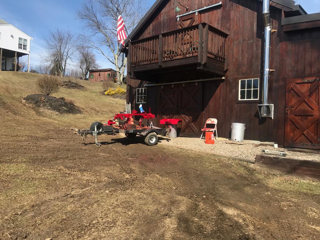

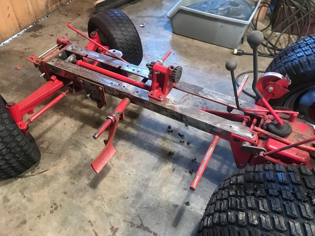

stevebo-(Moderator) 8,742 #51 Posted March 23, 2019 So... long winter but spring weekend is finally here. Been working a little on the 416-8. Member here answered my ad looking for a 520 front end conversion so that got installed. I have the frame all prepped and ready for paint tomorrow (hopefully based on temps). The last thing to paint on this machine is the rear fender pan and frame. Here are some photos as she sits. 1 4 Share this post Link to post Share on other sites

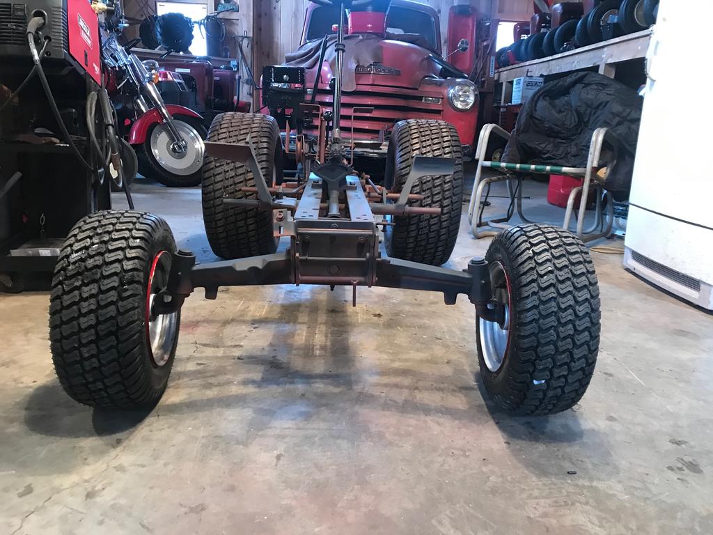

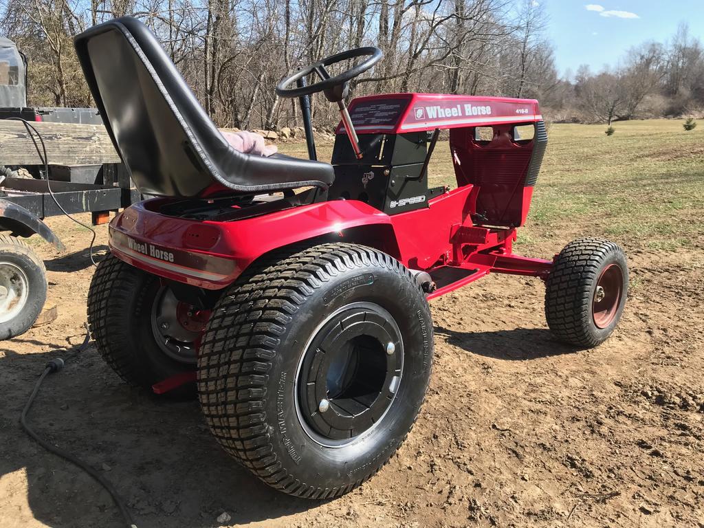

stevebo-(Moderator) 8,742 #62 Posted March 25, 2019 really? 5 Share this post Link to post Share on other sites
fast88pu 3,394 #63 Posted March 25, 2019 30 minutes ago, stevebo said: really? Looks nice steve 1 Share this post Link to post Share on other sites
Pullstart 71,452 #64 Posted March 28, 2019 Is that what gear reduction steering looks like? I’ve never paid attention to a new enough model I guess! 1 Share this post Link to post Share on other sites

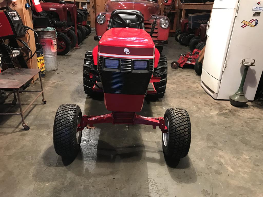

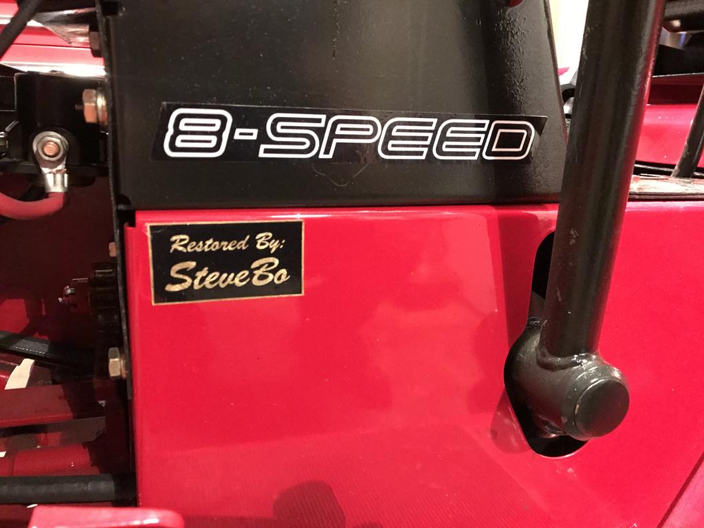

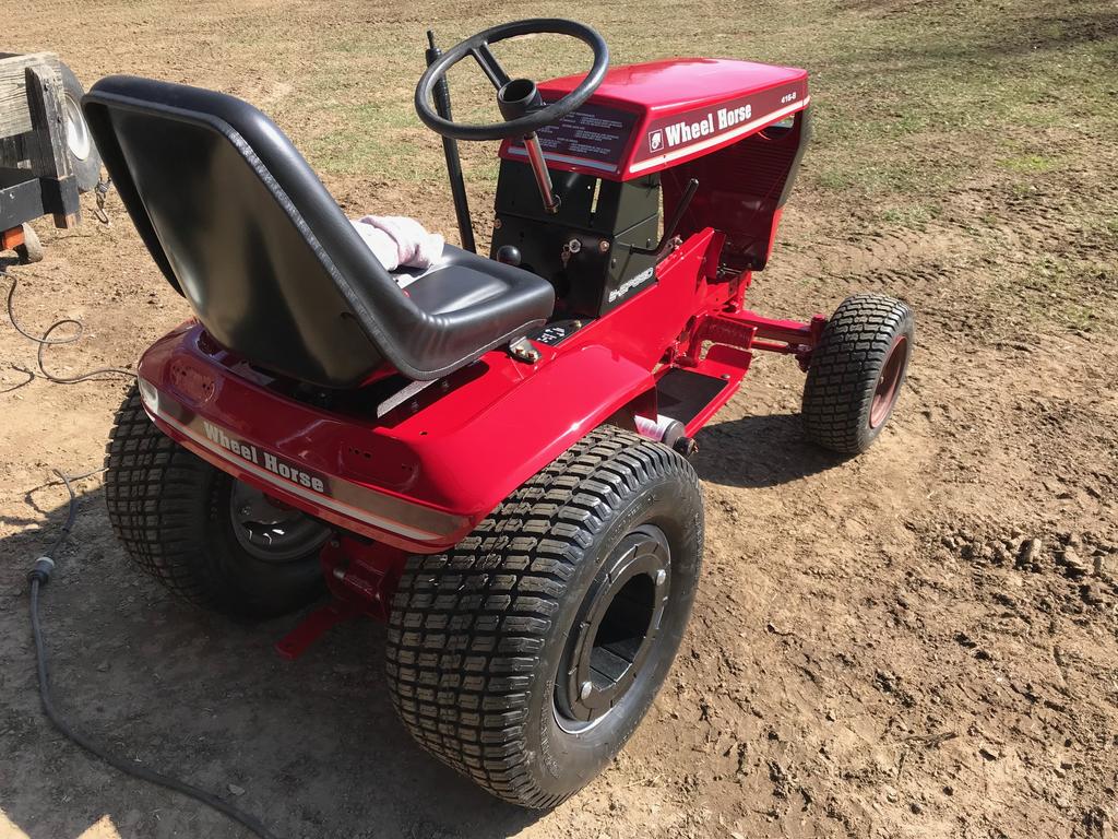

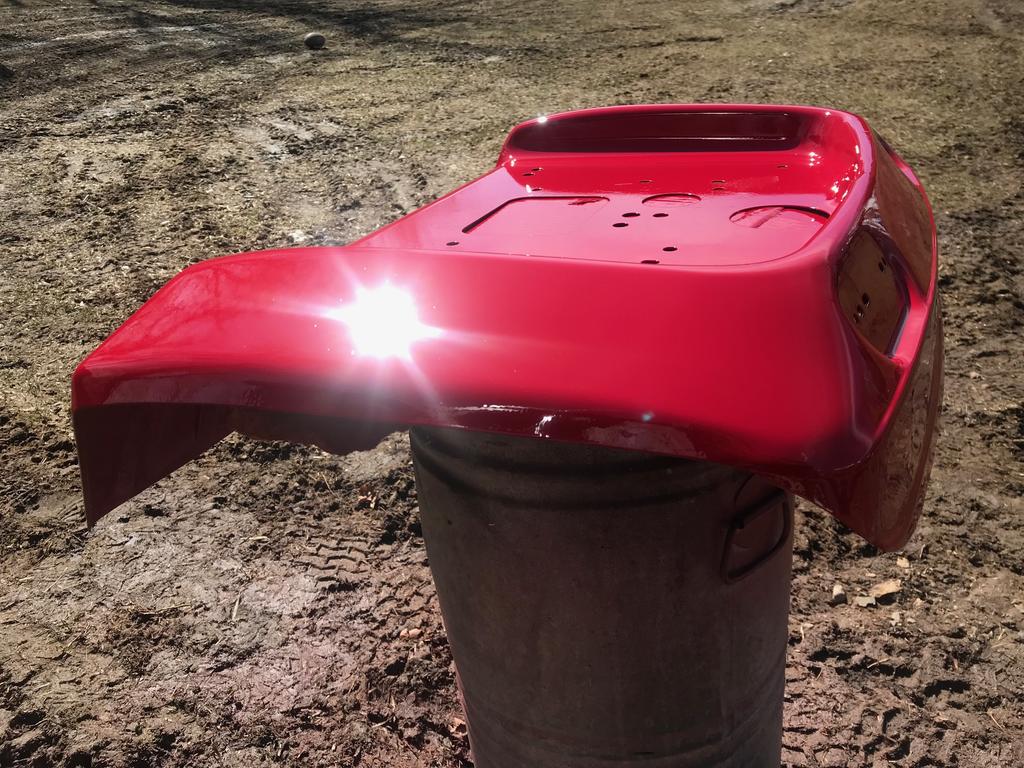

stevebo-(Moderator) 8,742 #65 Posted April 4, 2019 Update as of today... 6 6 Share this post Link to post Share on other sites
19richie66 17,937 #66 Posted April 4, 2019 Super clean Steve. 👍 1 Share this post Link to post Share on other sites
Pullstart 71,452 #67 Posted April 4, 2019 Better than new! Share this post Link to post Share on other sites

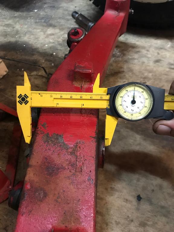

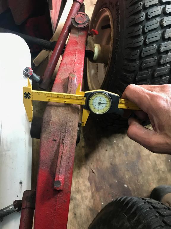

Super-C 4 me 612 #70 Posted April 23, 2019 On 7/20/2018 at 10:35 AM, Sarge said: Btw - is there any difference in that C series front axle as to strength versus the standard ones? If I can ever find a 195, it would be useful to know ahead of time. Sarge Sarge, The width is bigger on the C195 at 3.25" where the regular C or 300, 400, 500 series is 3" Pictures compare a C195 to a forward swept axle off a 520H As for the length I believe it is the same as the C series Brian Share this post Link to post Share on other sites
fast88pu 3,394 #71 Posted April 23, 2019 15 minutes ago, bmiller0457 said: Sarge, The width is bigger on the C195 at 3.25" where the regular C or 300, 400, 500 series is 3" Pictures compare a C195 to a forward swept axle off a 520H As for the length I believe it is the same as the C series Brian 195 also has bigger spindles Share this post Link to post Share on other sites
Sarge 3,473 #72 Posted April 25, 2019 Yes - I knew they used larger spindles on the Super C, just wondered about the basic axle dimensions themselves since it doesn't seem to be discussed much on here since they are so rare. Sarge Share this post Link to post Share on other sites

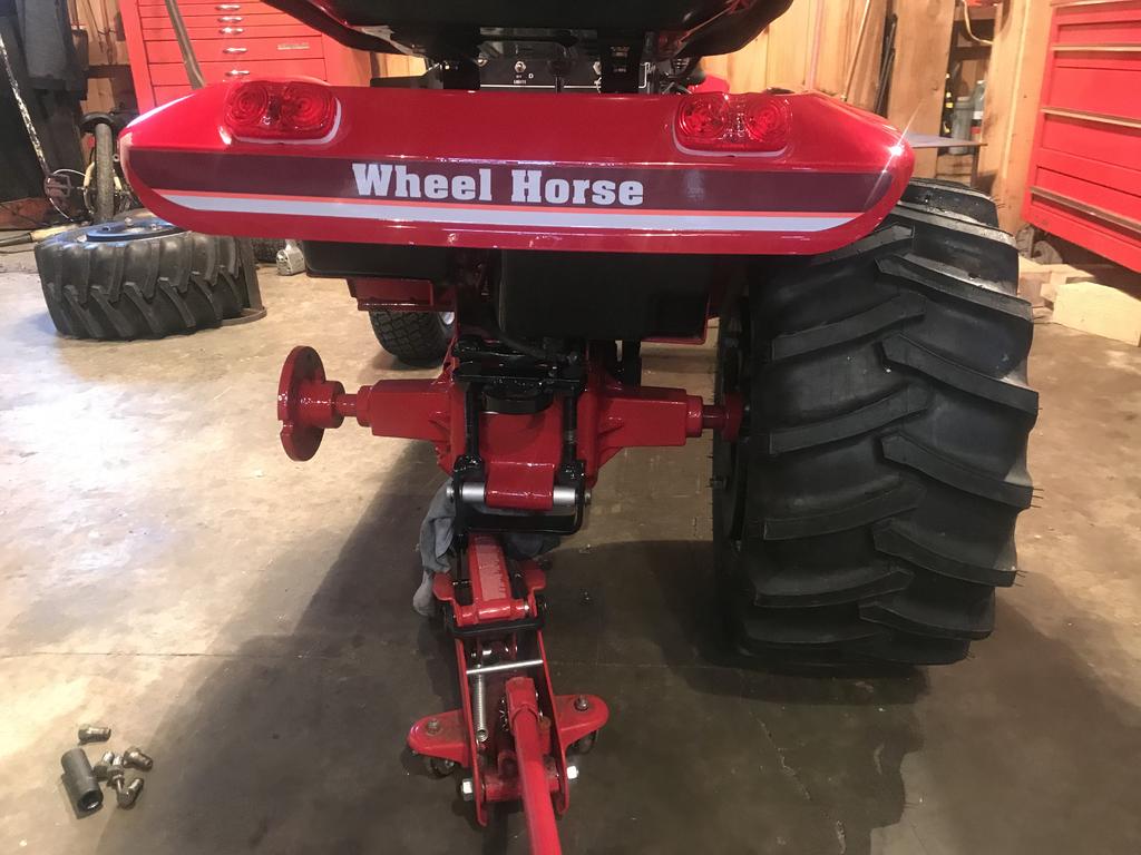

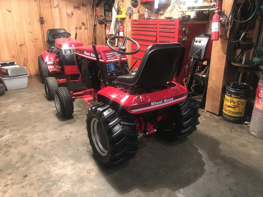

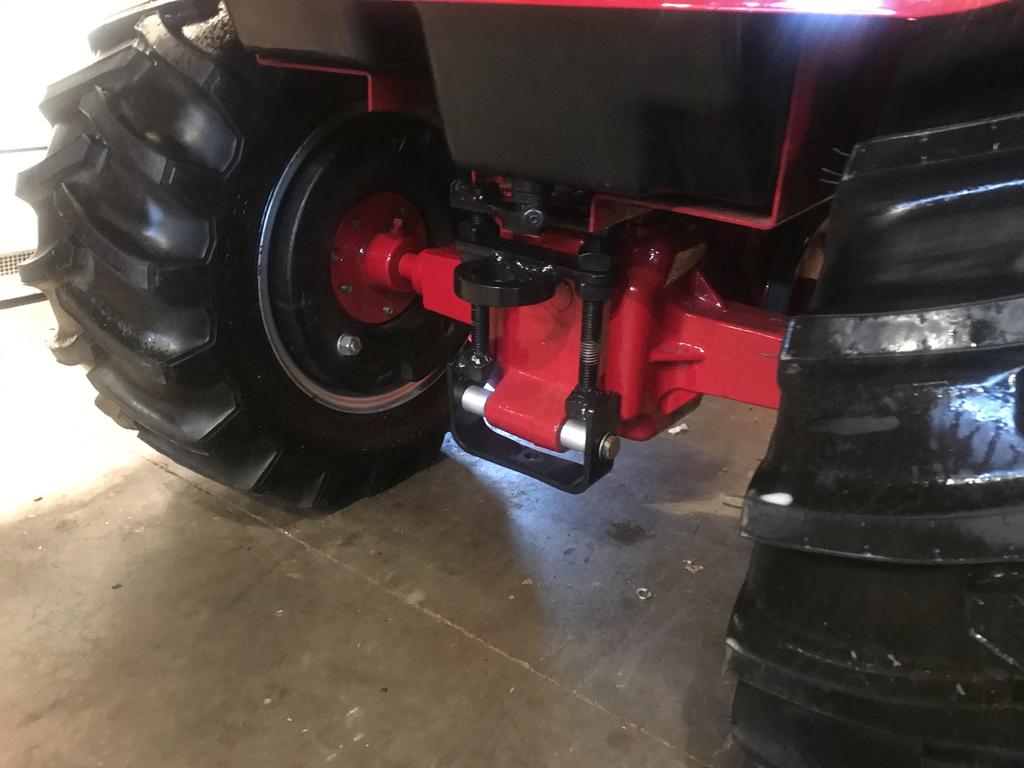

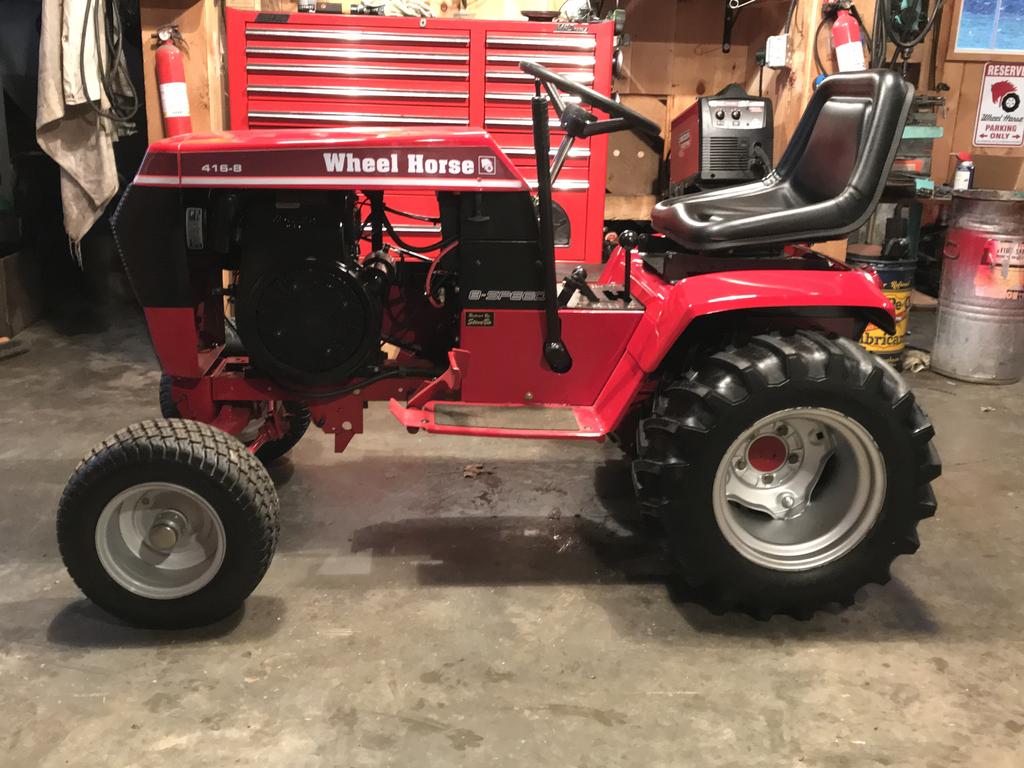

stevebo-(Moderator) 8,742 #73 Posted October 31, 2019 Well I have both done. I decided to set the 416-8 up to do some pulling in the stock class. Added Firestone’s on 520 rims and fabricated rear hitch, weight bar for under the machine and still need to fab wheelie bars. Here she is as she sits now. 1 6 1 Share this post Link to post Share on other sites
PeacemakerJack 11,080 #74 Posted October 31, 2019 Well done Steve—that turned out amazing! Just need an adapter hitch and 12” Brinly and you are ready to earth with that 416-8! Cant wait to see how it does in the pulling circuit... 3 Share this post Link to post Share on other sites
